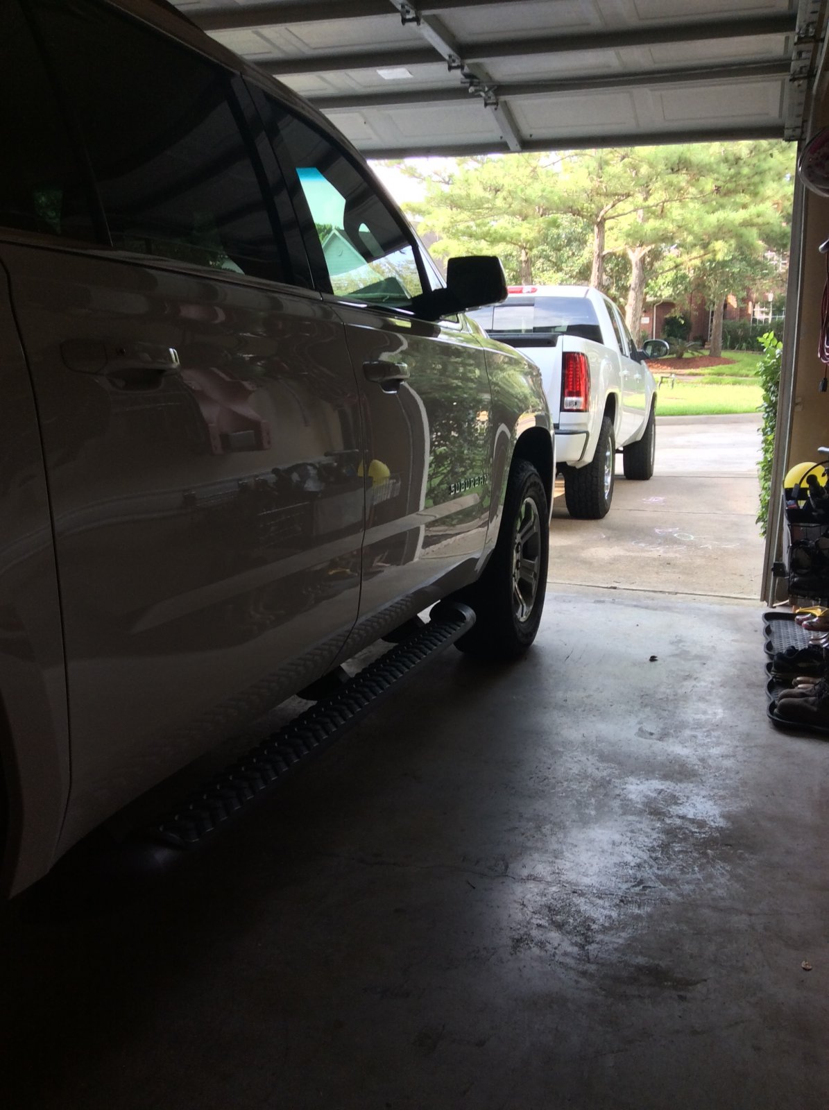

Since my ‘Burb didn’t have blinker mirrors, the associated main harness and door harness don’t carry the needed wires. For blinkers and running lights
So I need to run wire taps and run wires to the mirrors
My mirrors also have backup LED spotlights. So I’m going to run a power wire for those as well. F77D72B8-AAF9-4BE9-AA22-0221EEA2BA31.jpeg

Gotcha. If I already mentioned this, sorry for repeating. I can help you with a harness for the tow mirrors if needed.
The turn signal circuits for the mirrors should be present in the door harnesses, but not in the cabin. That’s been my experience with the harness orders I’ve done. Check position 41 on the door side of the connector. If a terminal is present, then they are set up for turn signals.
The suvs don’t have the wiring for the running or cargo lights. My harness will make those features functional.
Sent from my iPad using Tapatalk
