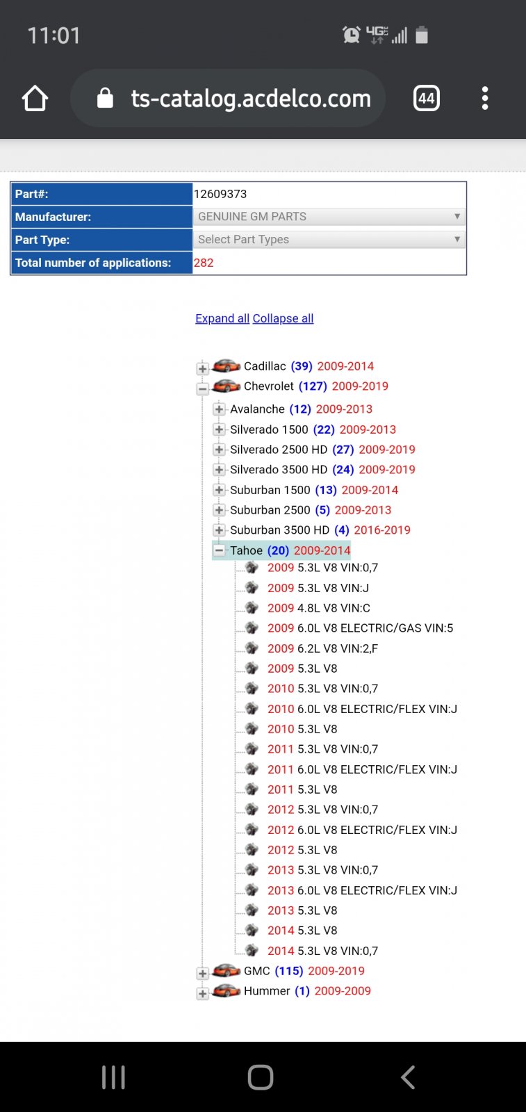

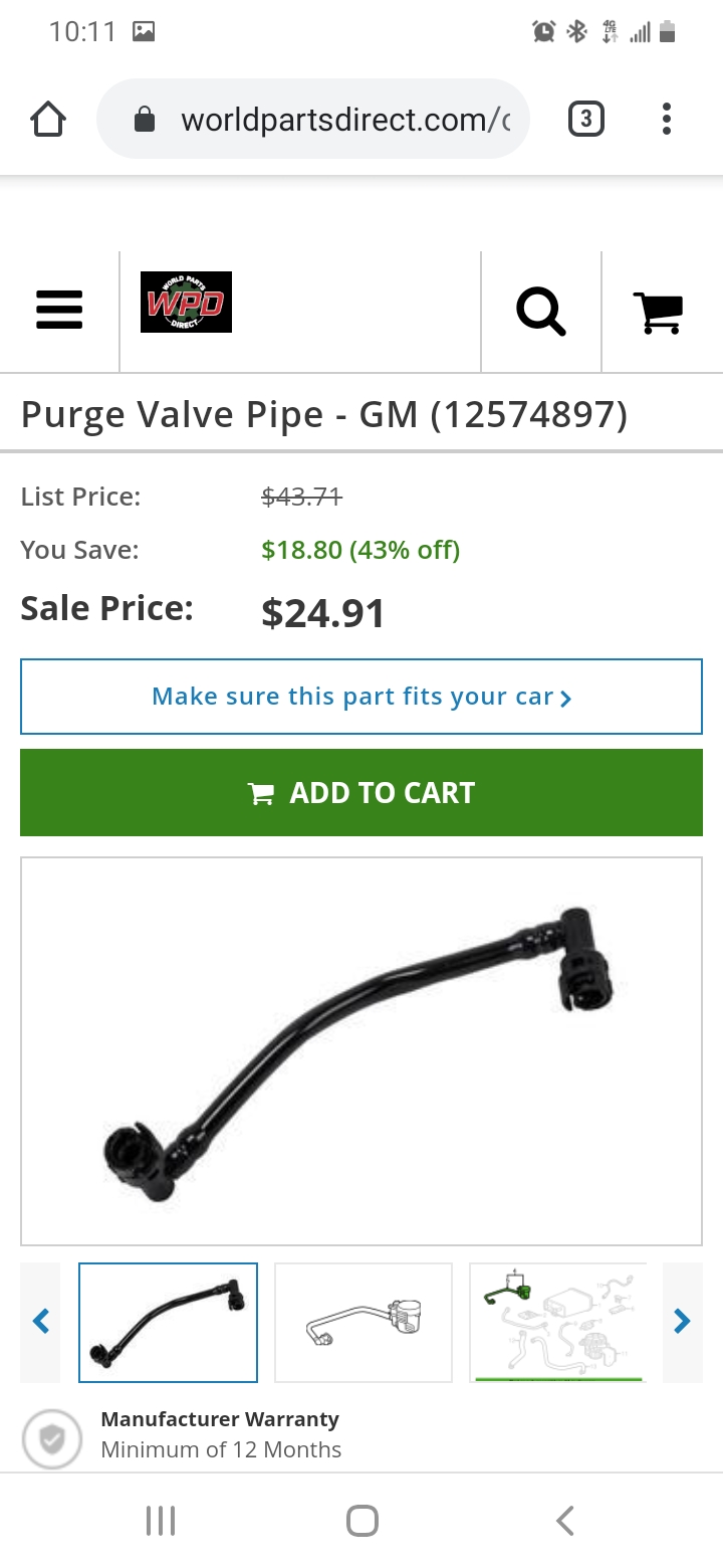

Somebody found the part number. I'm 99 percent sure this is it

From my description that should be it right? I cant seem to find a good shot of the two connector ends to know for sure

No. The purge valve is on the vapor canister which is at the opposite end of your truck, back by the gas tank. I’ll see if I can locate the right part.

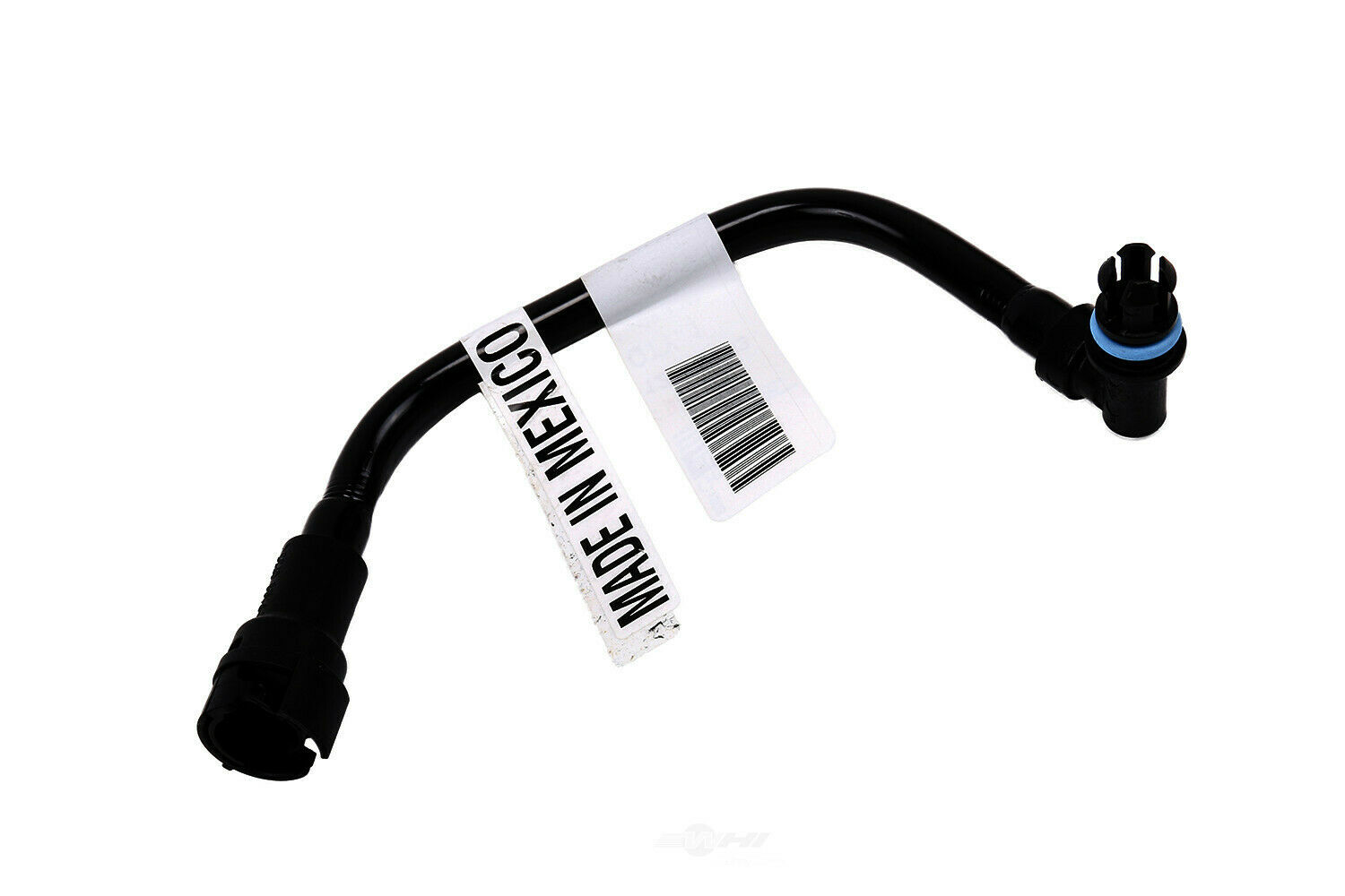

Watch this YouTube, it’s the same hose as the one you’re needing. All I found on the parts sites was the pcv valve side. GM Parts giant even called it the “dirty air” side. You want the “clean air” side. Edit: this is on a NBS. See post below for your part number.
