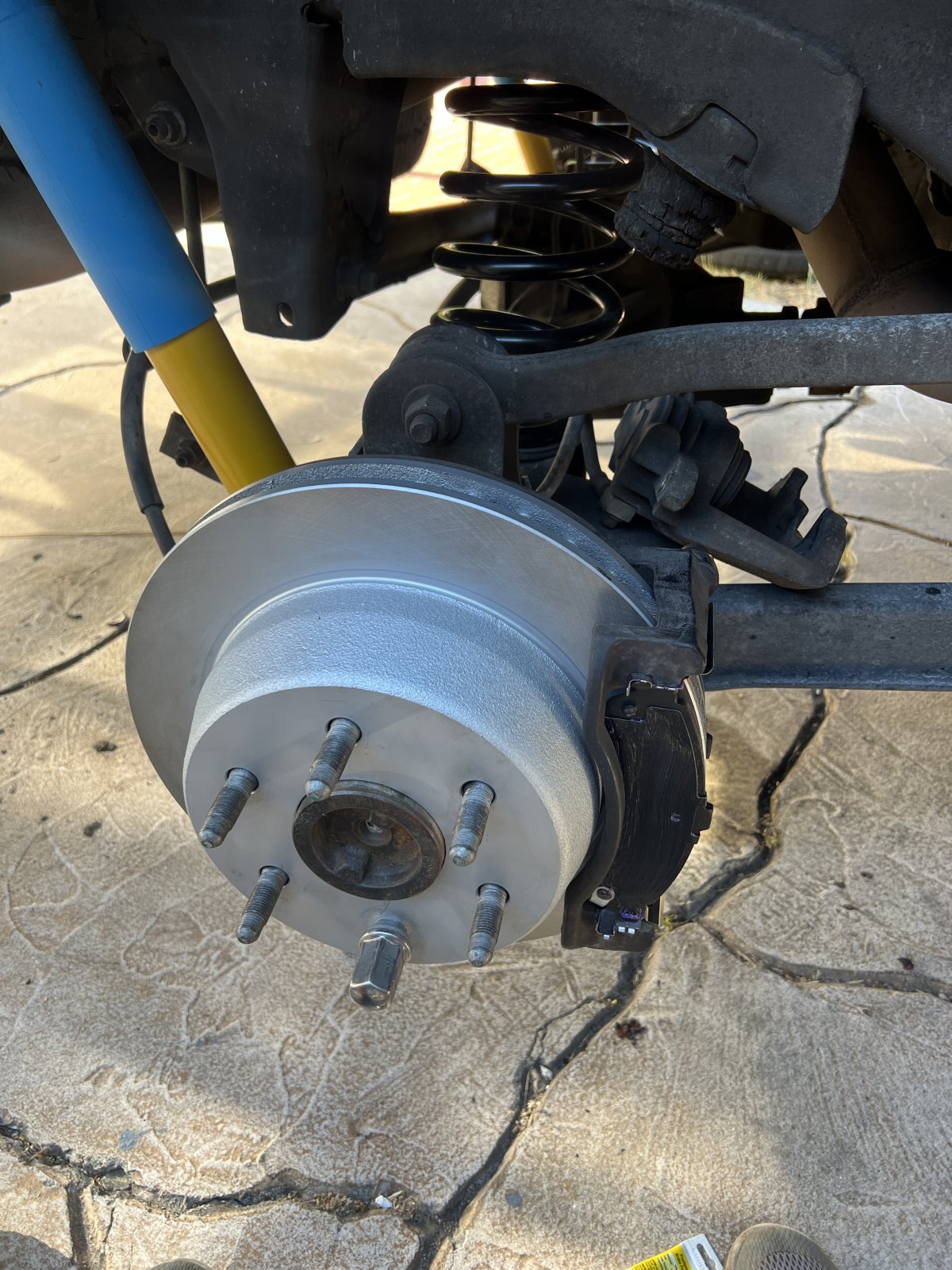

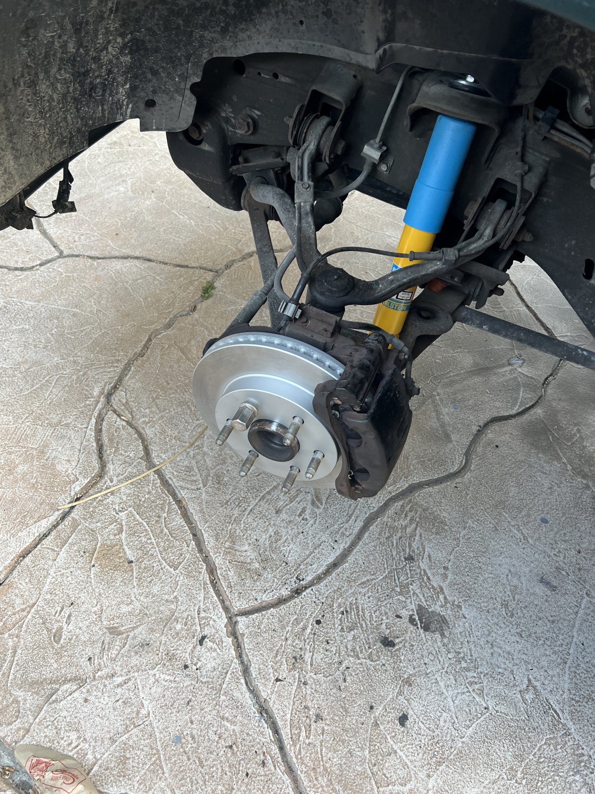

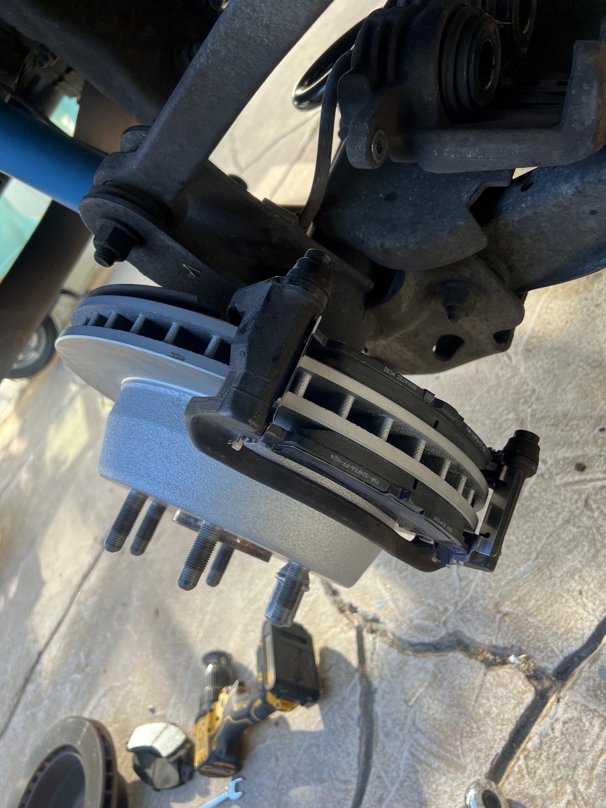

I ended up going with power stop, after reading a little more in the forums and on Reddit plenty of people with success and little complaints with them.
Went with the Powerstop SC2015 kit, semi coated rotors from rock auto.
My only issue with the power stop kit so far is while installing the front brake pad hardware provided with the pads, the hardware did not fit correctly to the pads. Even if I just tried to slide the pads onto the new hardware the fitment was off could not get them on. I cleaned up my old hardware lubed it all up and the new pads fit that hardware perfectly.
The rear pad kit I had no issue with using the new hardware that came with the pads.
I didn’t get a pic of the fitment issue. I was irritated with dicking around trying to figure out what was wrong! (Wrong kit, wrong pads?)
On the rear I had to turn the e brake adjuster all the way down for correct drum to spin freely.
Did the bed in procedure to the T, need to flush system but after inspection of my bleeders I’m gonna need to replace a few first.
* Final note, my brakes weren’t complete toast they worked I was getting a vibration though, when braking. It turns out one rotor/hub had quite a bit of rust/pits built up, I suspect this was causing the vibration. Rears had plenty of life left in them at least I know it’s got fresh brakes likely won’t need another set in this trucks lifetime!
