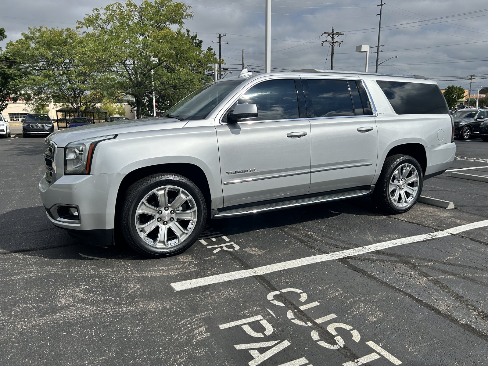

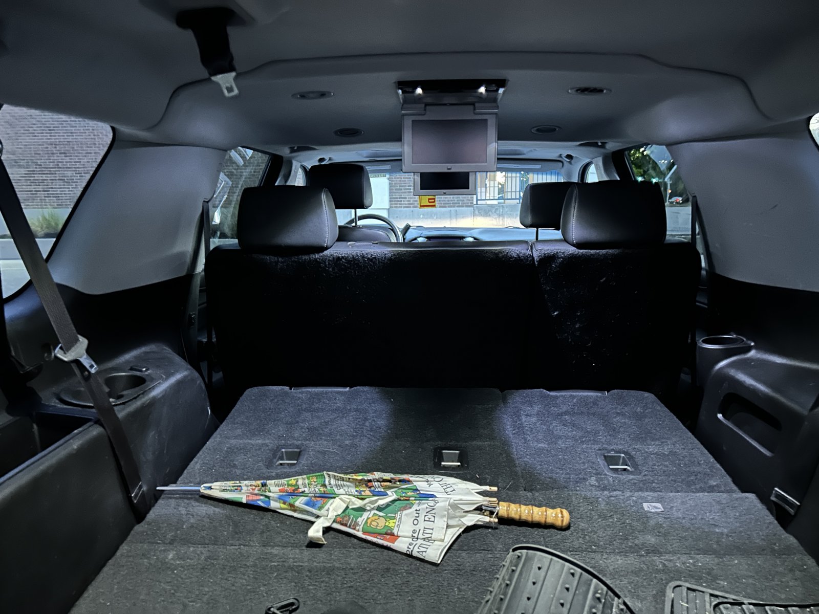

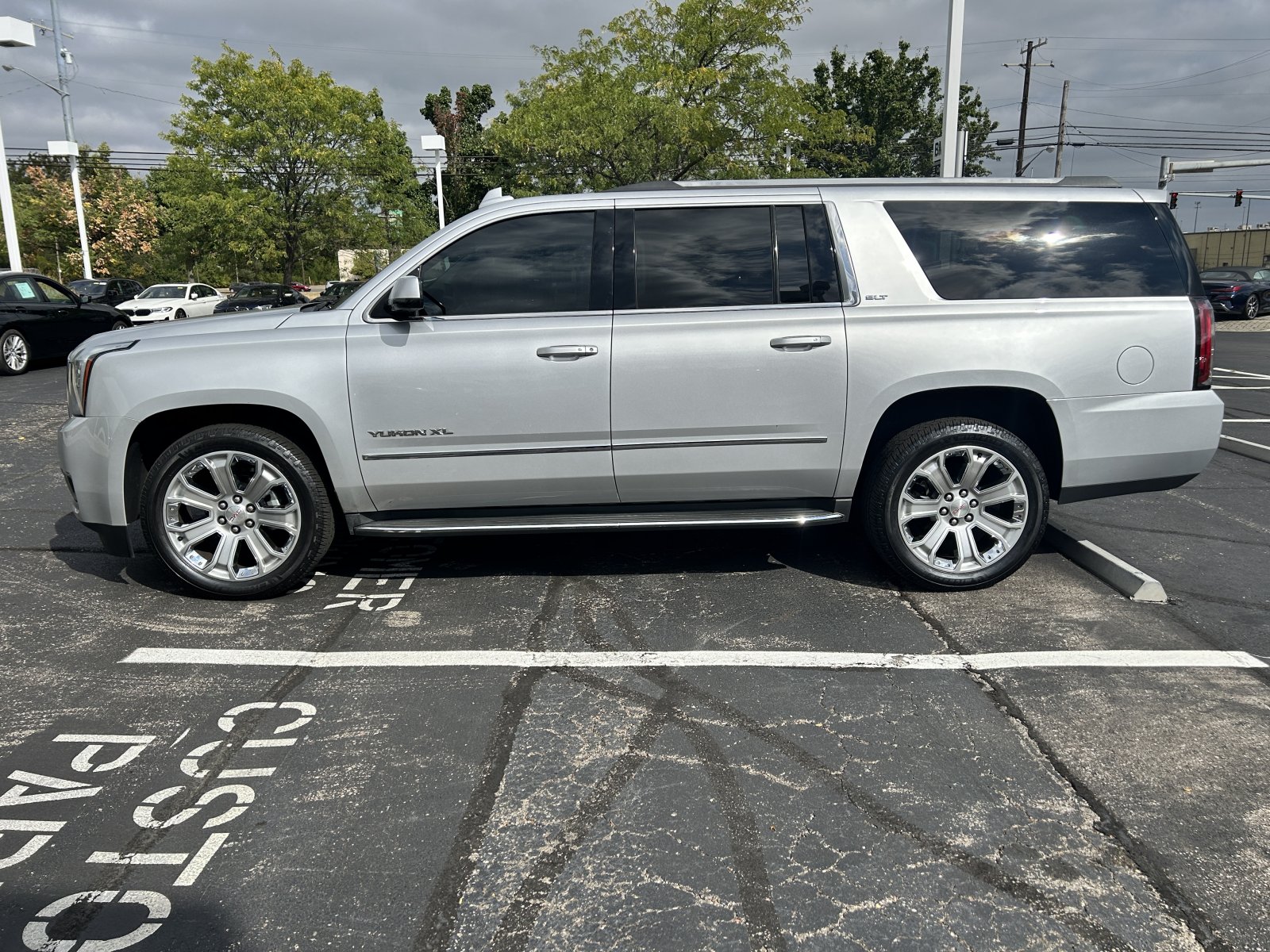

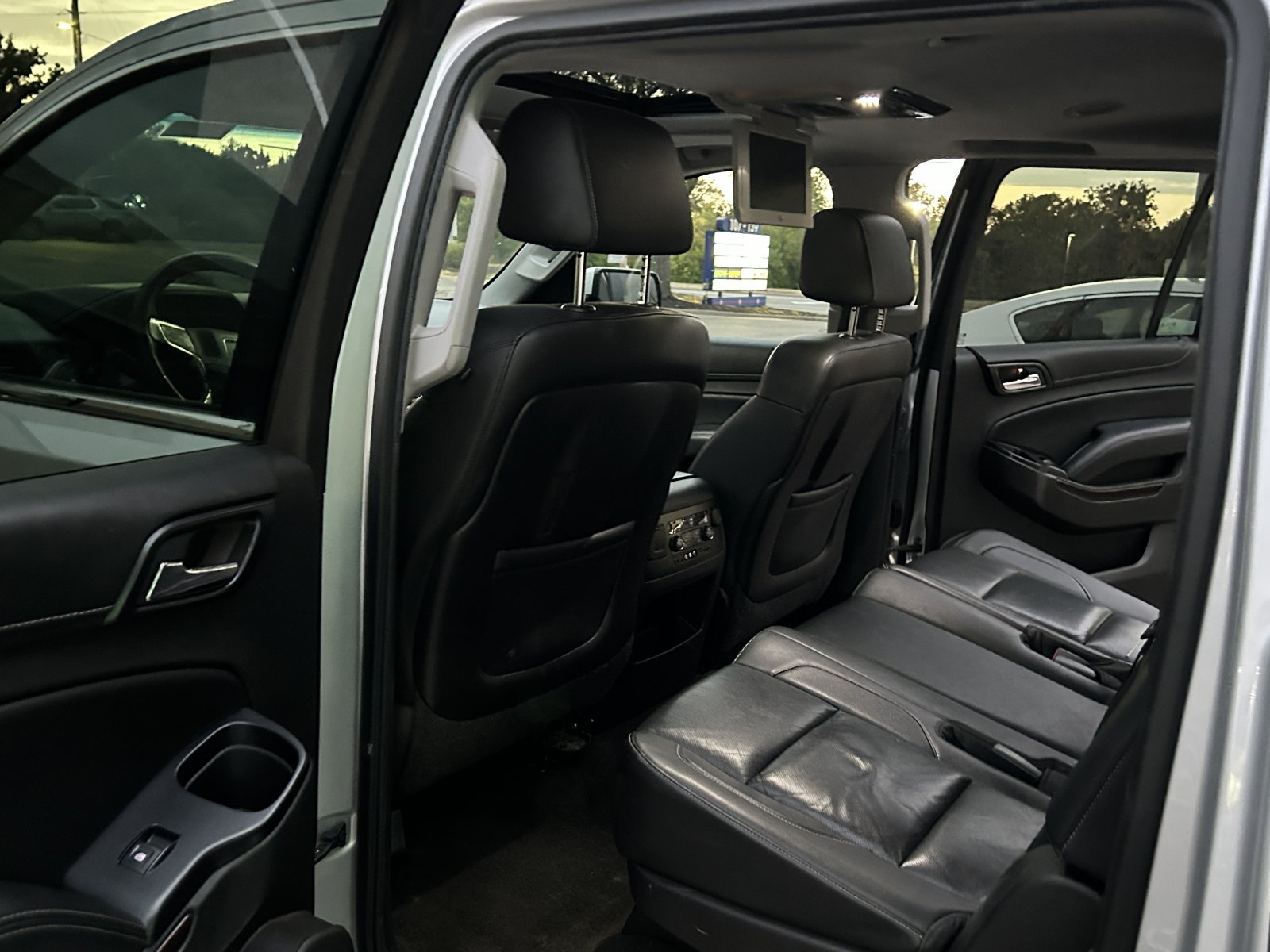

I’ve attached some photos. It’s a good looking car but I don’t know if this is a good idea.

Nice looking vehicle. Congratulations.
