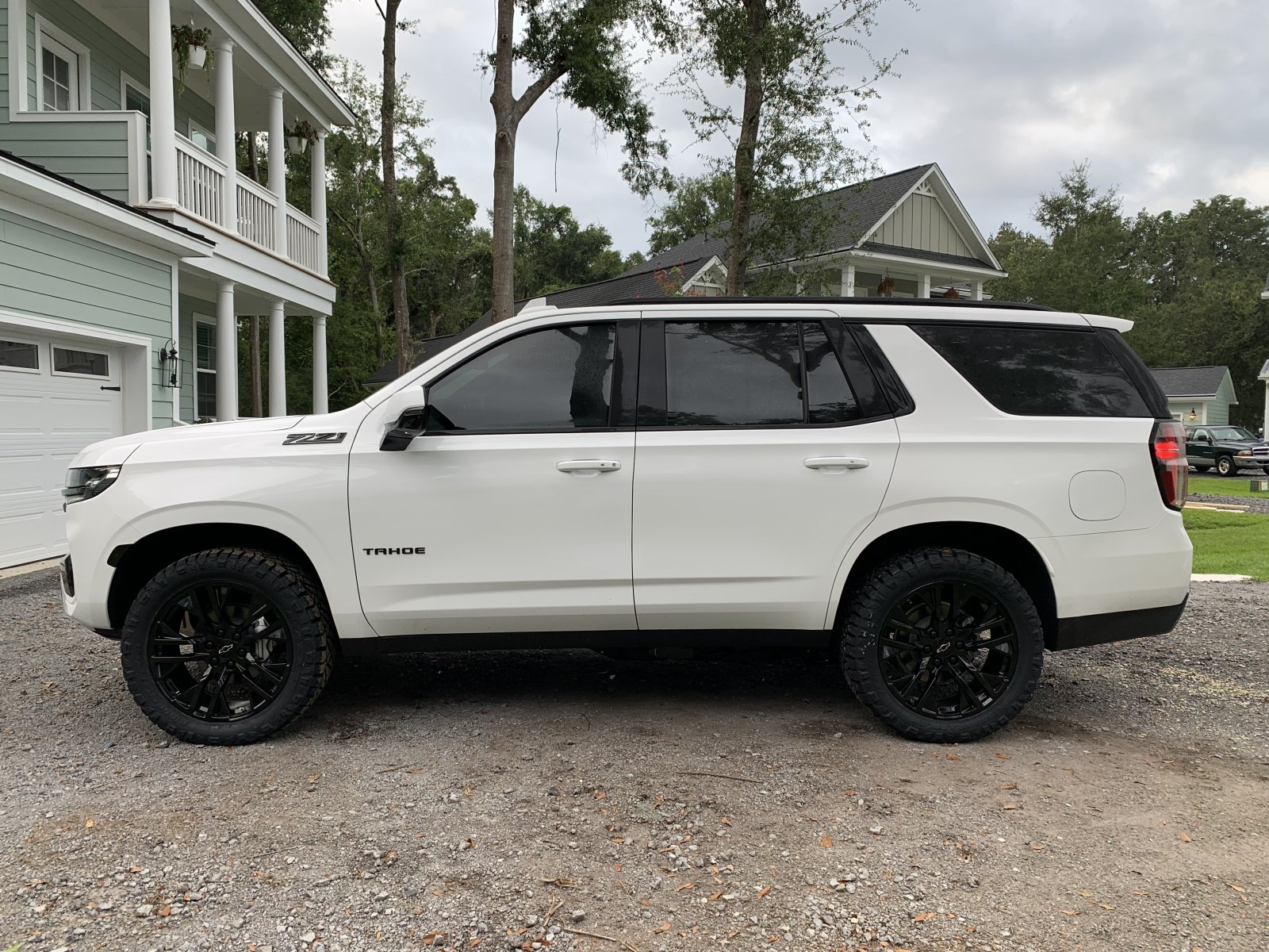

Nitto Ridge Grapplers 305 45 22. They really helped make the truck look more aggressive on stock wheels. Bonus extra width for curb protection for my wife.

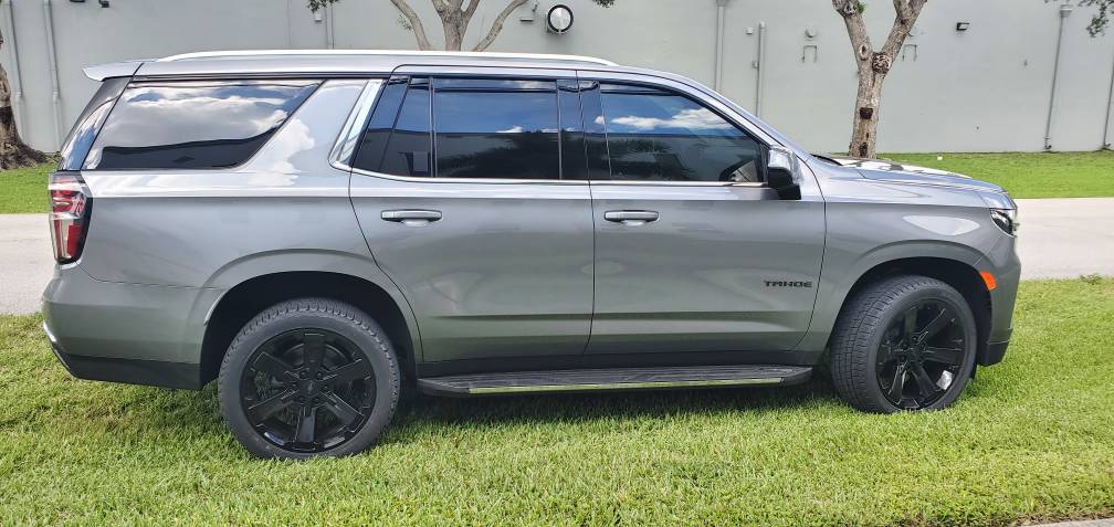

Michelin defender LTX MS are the truth, have had a set for almost 8 months on daily driven 16 hoe and have never had issues with grip or noise in northeast. Have a set of 22” OEM Tahoe wheels on the marketplace and eBay for sale, used for about a year, took off Alenza + that originally came with and put on some Kelley Edges 285/45/22, this was prior to me finding out about the Michelin’s. Have been running black rhinos 22” Zulu’s with Michelin defender and will never go back, also on 285/45/22.
