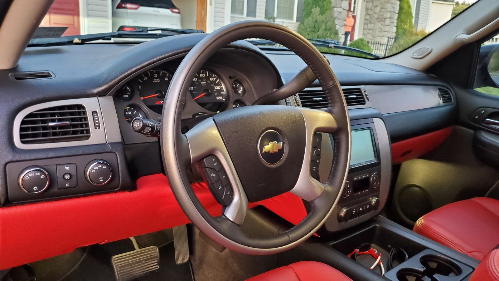

I found yesterday that 3M 1080 "Scotchprint" vinyl in "titanium" is an exact match for the Z71 "brushed aluminum" trim. So I have ordered some of that and i'm wrapping the spokes and trim ring on my Escalade wheel to match the rest of the trim. I'll see how I feel about that when its done and then decide if I want to stick with it or go ahead with the custom leather.
Finished it up over the weekend. I'm happy with this so i'll stick with it.
