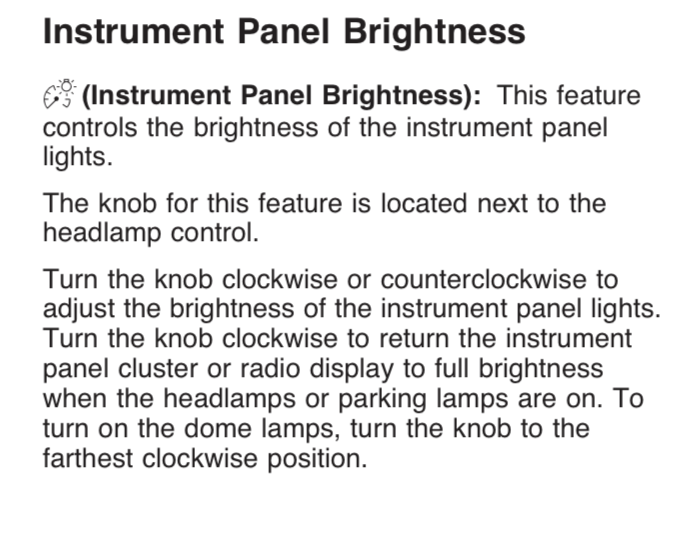

I'm curious, do your other dash/cluster lights dim and brighten with the dimmer on or near the headlight switch? (I'm not all that familiar with the newer dashes, but it seems that the dimmer would also control the radio switch lights.)

Could you explain what you mean a bit more

The dimmer switch he’s talking about is explained in your owners manual.
