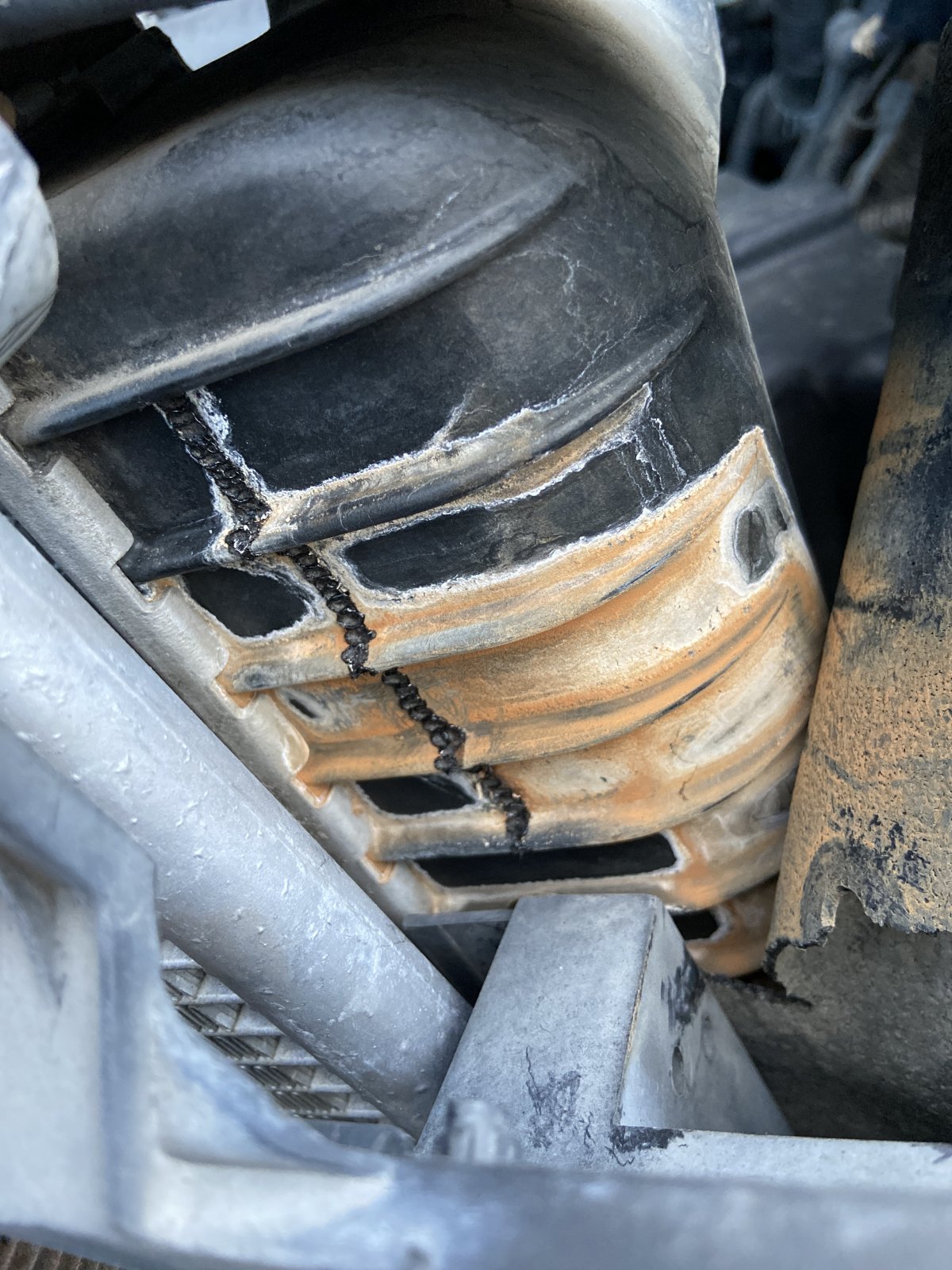

I just picked up a 100w plumber grade soldering gun from harbor freight for $30 I’ll update maybe tomorrow when I get to attempt to mend the crack and try to install a idler arm and bracket (steering issues getting worse) I’m feeling optimistic

Looks like a solid plastic weld to me

I missed a spot my leaking is exponentially better so I’m gonna attack the spot I missed another day, for now it’s a drip and not a leak it’s holding almost full pressure just a small pinhole where I didn’t touch the gun.

That would scare me to death. Reheated plastic and thin spots. Maybe JB weld with a back up metal patch would work for me on that. But most radiator shops can replace the plastic tank for reasonable money, and the aluminum cores seem to hold up real well with good coolant maintenance.

Welcome to the woprld of plastic tanks and aluminum cores. Its true, they suck.
I had close to 200k on mine before it started leaking.so I can't complain, and this was after 119k miles of police duty.
I replaced it with a Cold Case aluminum. Smooth, direct fit. Only problem was that the renewed pressure from the new radiator brought out leaks from the overflow tank and a heater hose. Now the cooling system is all tight again and functioning nicely. So if you replace the radiator and have a good amount of mileage, expect to replace a few more things. It's just normal wear and tear.

1. California so any labor to remove and repair is far more expensive than just replacing.
I don’t do any long distance trips and I have unlimited distance AAA also if I don’t overfill the tank it doesn’t leak. however I still need to fix the pinhole just for piece of mind and I’m gonna add more filler plastic this is just to fill a time gap between a full cooling system minus water pump. also my fan clutch nut is frozen I have one that runs off the serpentine belt which needs to be taken off by a skilled mechanic I tried to replace the radiator in the first place but the thing stopping it from coming out is stuck because I don’t have a air hammer. NO MORE LOW COOLANT LIGHT/OVERHEATING FOR NOW

I haven’t used coolant in this truck since I last saw Nicole in like june when my heater hose was still leaking it’s what caused it to crack, i was running a leaking heater hose for about a week while waiting for a new one and i overheated once really badly No head gasket blown just a cracked radiator tank
Be ready to cough up some big bucks, running just water in the radiator Is going to corrode the internal transmission cooler and get coolant in the transmission.
Some of theses suvs have two internal coolers. One for the transmission and one for the motor oil.
Oh I know only one I’m not able to change myself is the trans cooler if I have one
I don’t do any long distance trips and I have unlimited distance AAA also if I don’t overfill the tank it doesn’t leak. however I still need to fix the pinhole just for piece of mind and I’m gonna add more filler plastic this is just to fill a time gap between a full cooling system minus water pump. also my fan clutch nut is frozen I have one that runs off the serpentine belt which needs to be taken off by a skilled mechanic I tried to replace the radiator in the first place but the thing stopping it from coming out is stuck because I don’t have a air hammer. NO MORE LOW COOLANT LIGHT/OVERHEATING FOR NOWView attachment 388342
For the fan nut, put a large c clamp or c clamp vise grips on the pulley, clamping it to the engine. There’s one spot where you can do that. Then use a big breaker bar or breaker bar with a pipe over the end. That nut will come off as long as you turn in clockwise, reverse threads. Or an air hammer is $20 at Harbor Freight, just need a compressor or friend with one. Don’t let that stop you from replacing the radiator. Like was mentioned, if the internal trans cooler starts leaking, the fluids will mix and your trans will be destroyed almost immediately. There’s a few pics of using the clamp in this thread I linked.
