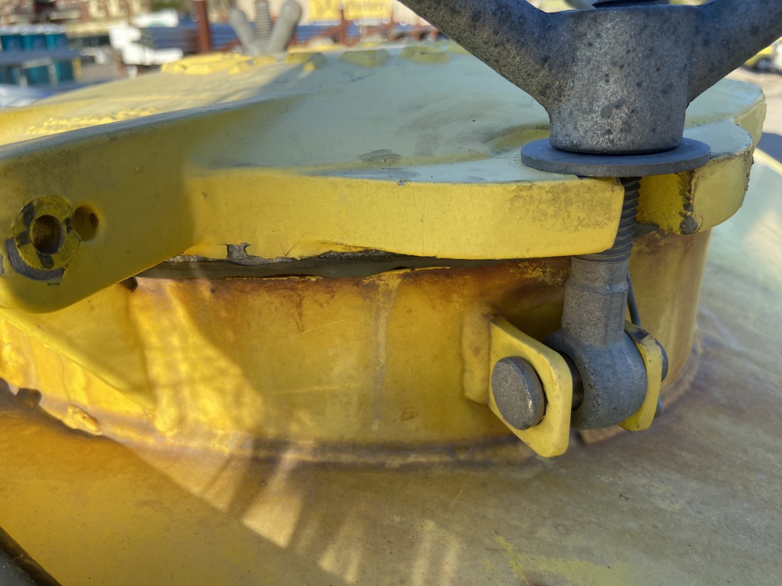

I actually repair very similar high pressure tanks at work I’m gonna give it a shot with some plastic welding and with the calcium buildup you can tell it’s been happening for months so at worst I go a little more time with a cracked radiator, image : high pressure tank that holds enough pressure to shoot it’s contents like a volcano if released all at once somewhere in the neighborhood upon reverse vacuum 200 psi . It’s sealed with water weld by jb weld by the seal the seal is sealed to the lid by that stuff and silicone from GE.
