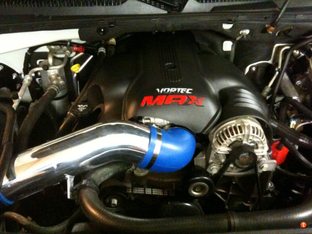

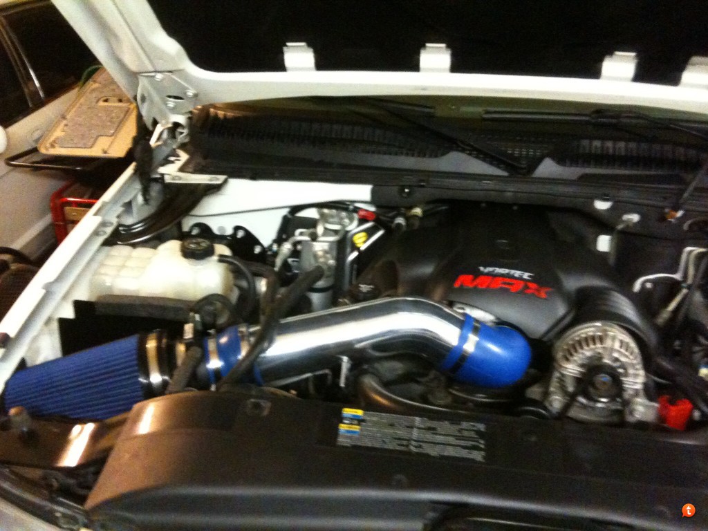

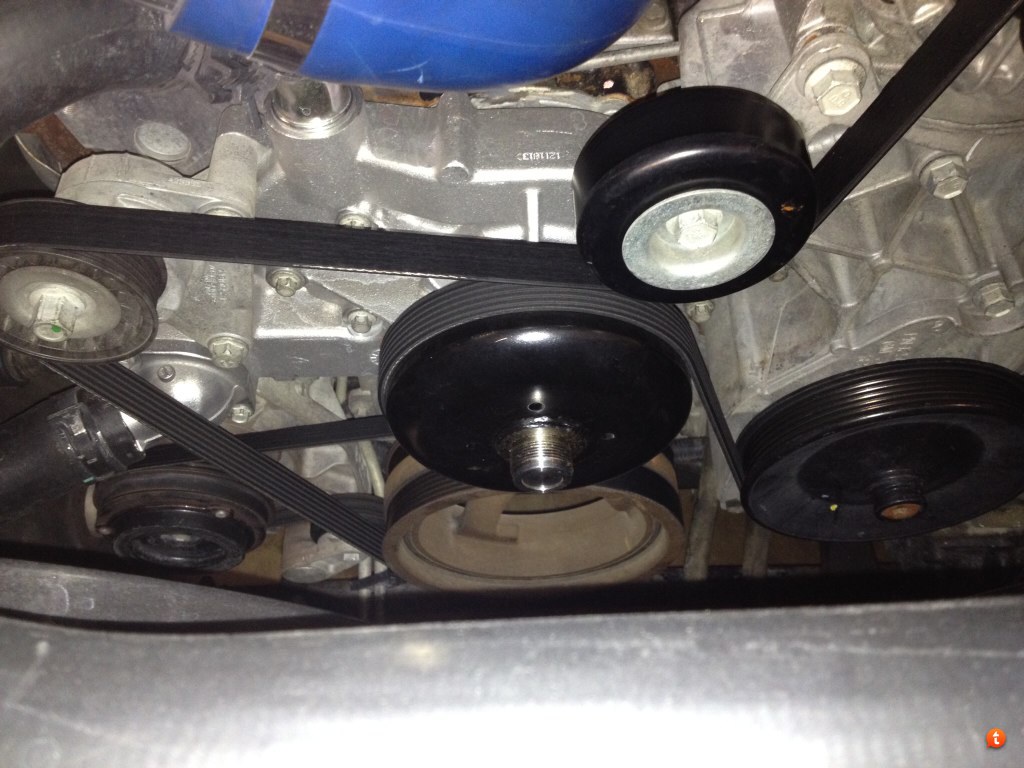

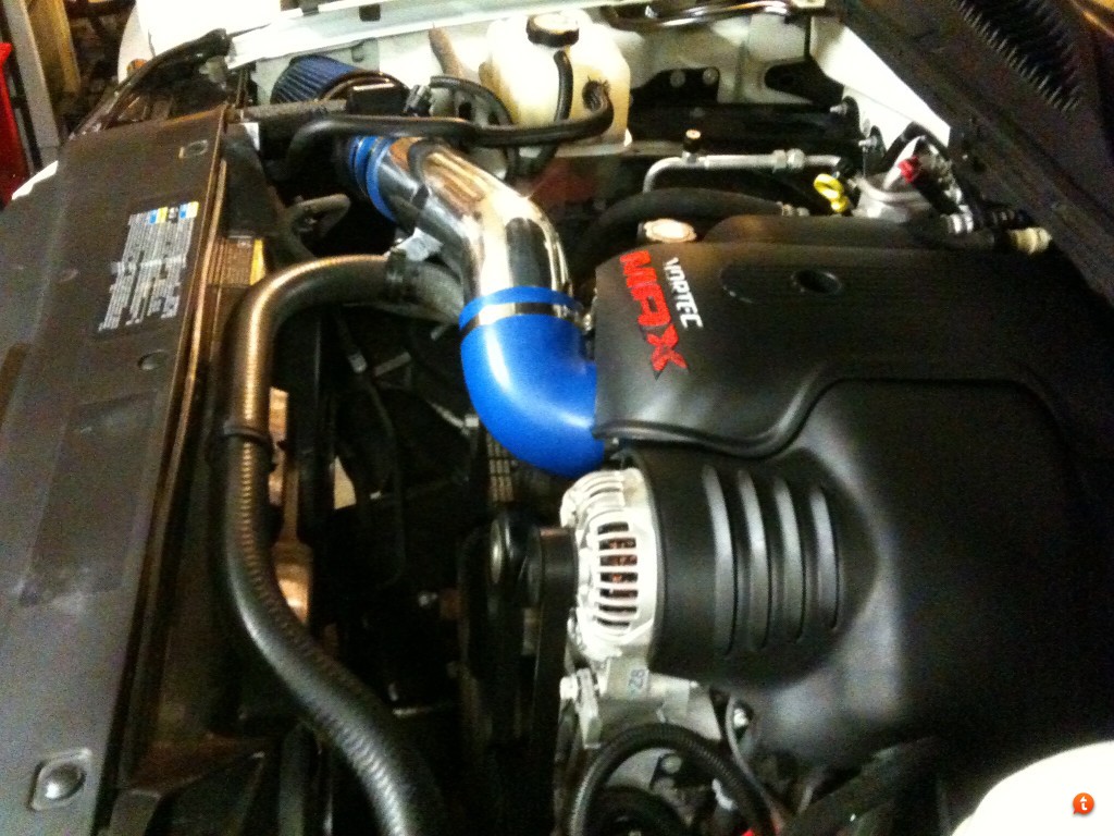

Does this look thrown back together??
Sent from my iPhone 5s using Tapatalk
