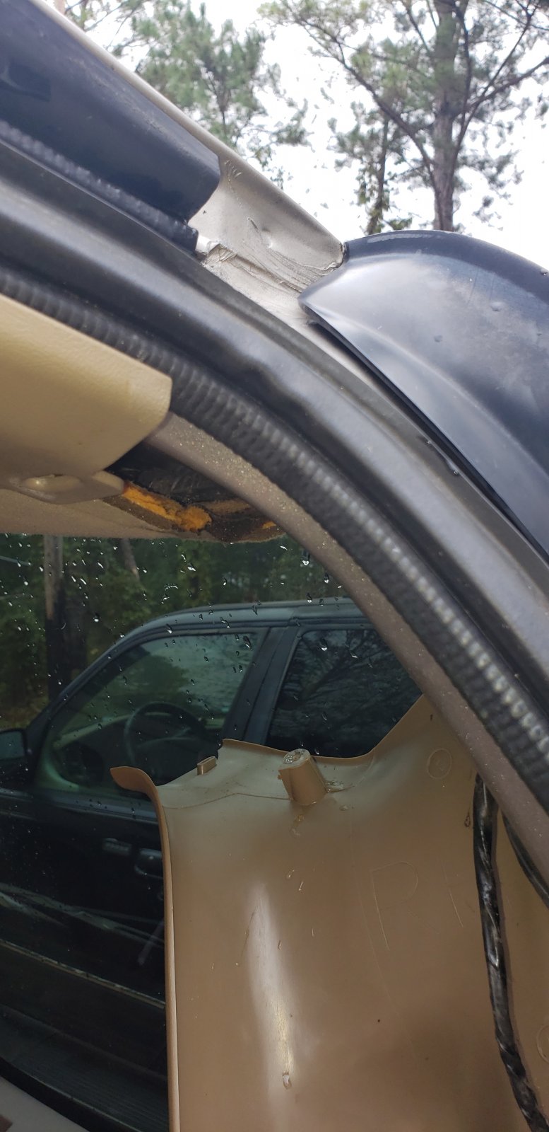

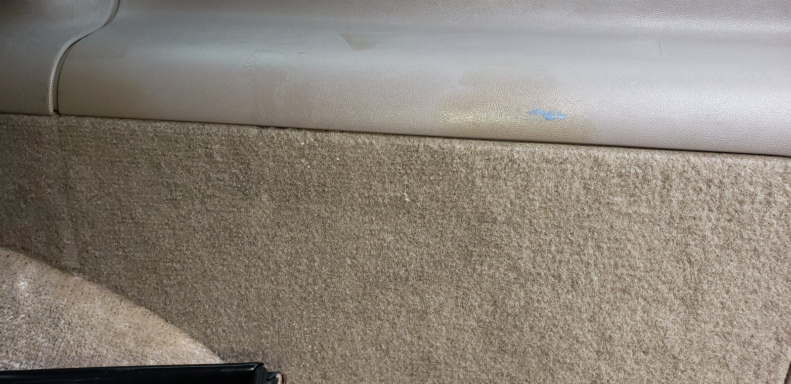

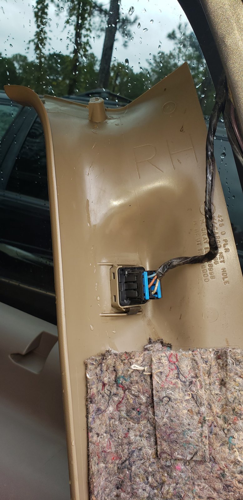

I’m getting ready to have my headliner re-done, but I’m having a hard time chasing down a leak before I have it done. My current headliner gets soaked when it rains. I know where the water exits but can’t figure out the source. I’ve had the quarter glass removed and resealed, and that didn’t help. I have silicone’d the roof rack and I don’t think that is it either. I removed the headliner today and didn’t see any water around the roof rack nuts after hosing it down, although there is not much of an opening to look through. The water was dripping from between the pinch weld at the top corner of the window. Anyone else experience this? Attached are a couple pictures. A close up, and another farther away for context.

That pinch weld started to separate on mine. Couldn't really see it without the quarter glass out. I chased my leak for a few weeks. When my guy came to change my quarter glass, he looked all over the place and pinch weld had some wetness and a tiny amount of opening. Barry (glass guy) filled it in and then put the new glass in and added extra sealer.

UPDATE - I had another Auto glass shop reseal the window. They put a thicker bead in the corner where the water was coming in. It fixed it and is no longer coming in at the body seam. However, it is now leaking at a different spot. I really wish I had a competent glass place near me. Both shops I have used, I'm not happy with either.

Same thing happened after removal of quarter glass for a respray. Glass guy installed glass and it leaked on both sides. Did it a 2nd time and it still leaked on the top edge of the passenger glass which caused the headliner to get wet along with the carpet in the rear passenger corner.
I chased it also and resealed the 3rd brake light which is fairly common, all roof rack bolts and still had a leak. Turns out it was leaking about 3-4 inches from the rear corner on the top edge of the passenger side glass. After resealing it twice and using a special body primer it still leaked. We finally solved it using a thin strip of caulking putty that Ford uses to seal glass. We packed it in tight along the upper edge where the adhesive and the glass meet.

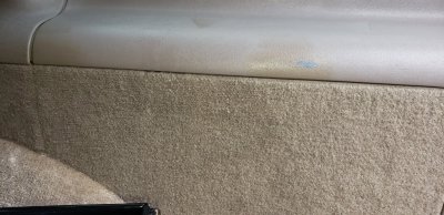

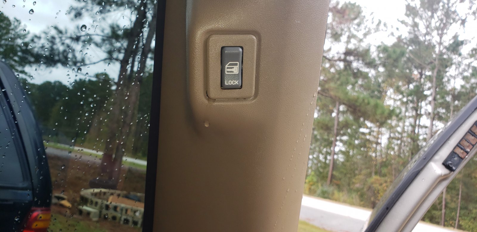

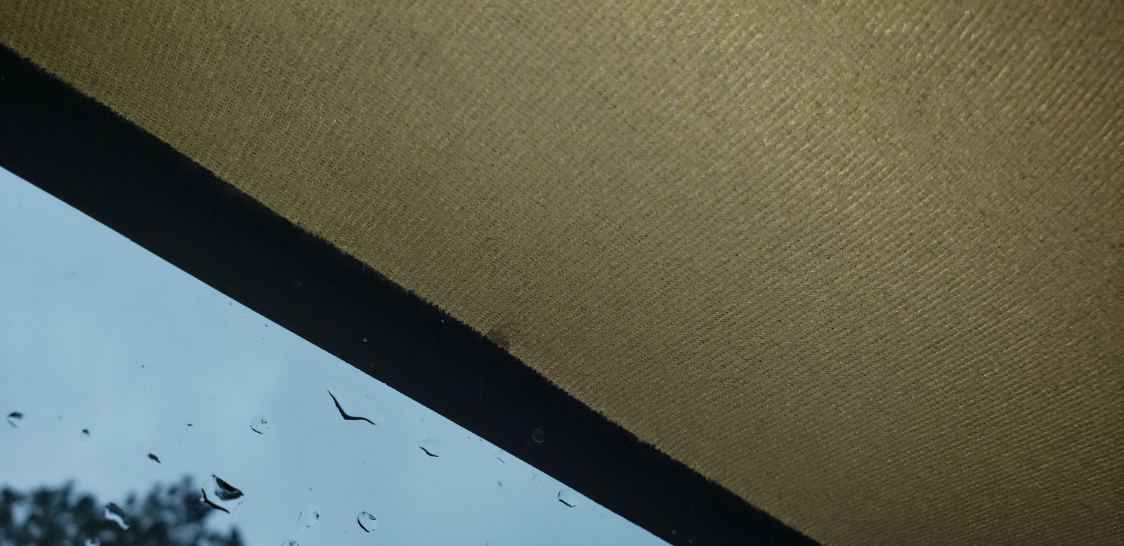

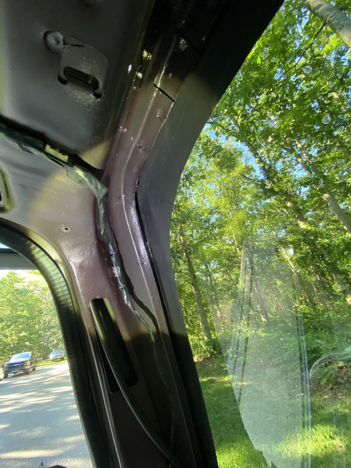

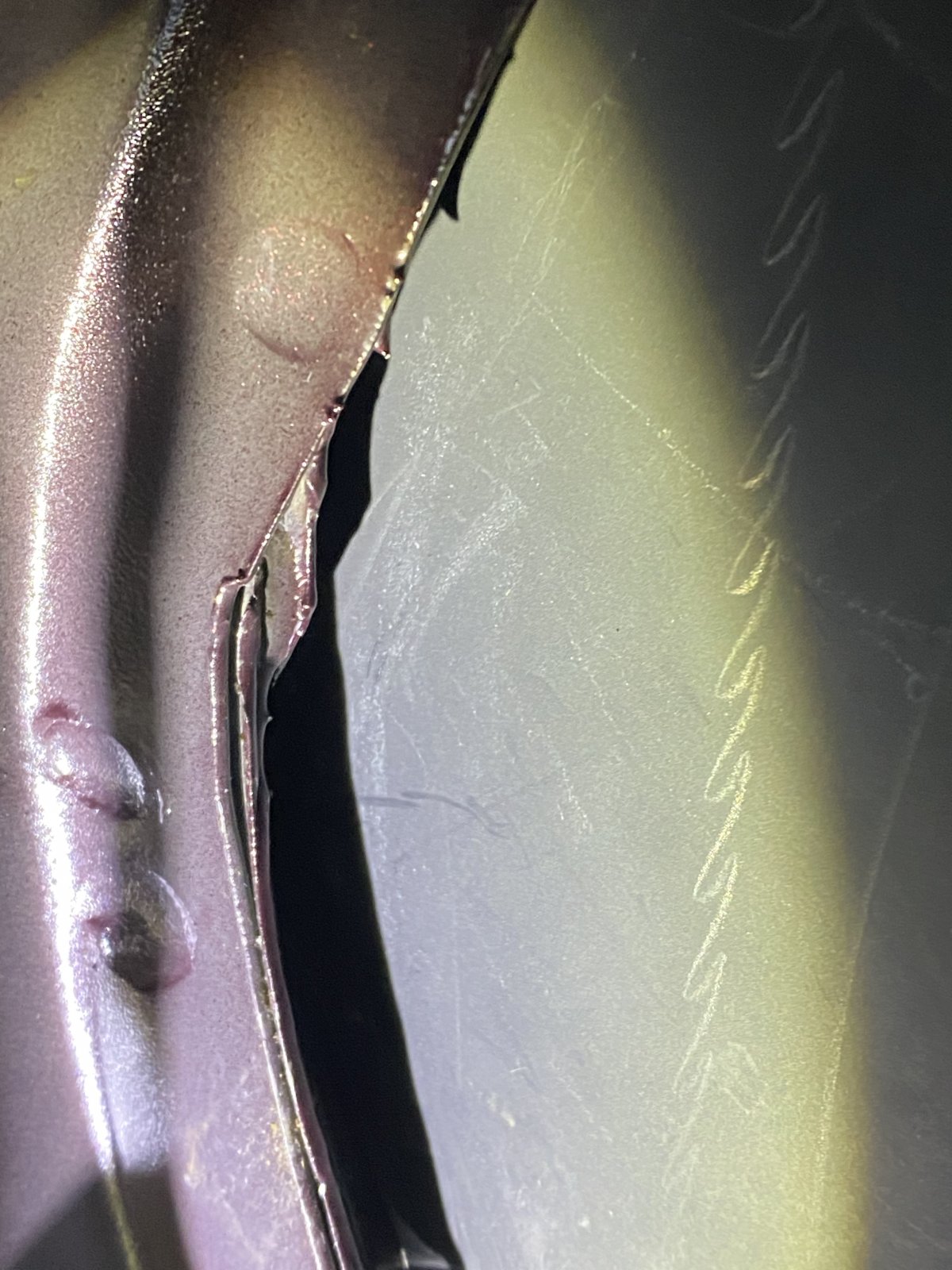

i have the same problem my headliner is getting wet and so is my floor on the passenger side could that mean i need to get my quarter glass resealed

Check your roof racks. Make sure they are sealed
then check the weatherstripping along the top of the Cargo Area side windows.

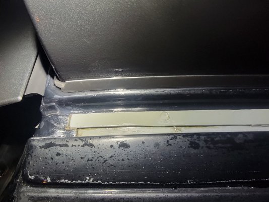

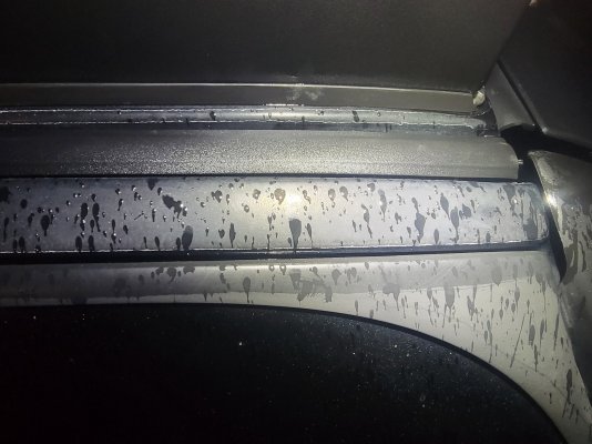

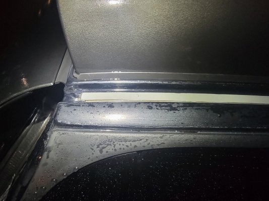

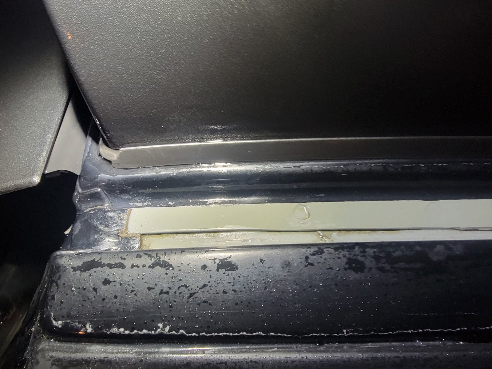

I know this post is several years old, but I've been chasing this same leak on my 06 Suburban Z71 for a year. The rear carpet by the rear A/C unit was constantly getting soaked when it rained. I finally decided a couple of weeks ago to track it down once and for all. I removed all of the rear interior including the carpet, the panels, and the rear headliner. I bought a smoke generator to see if I could find where it was leaking, but that was a no go. I found water leaking at the bolts for the roof rack, so I resealed the rook rack - no more leaks at the bolts but still a leak on the floor. I replaced the body pressure relief valves - no leaks. I unmounted the rear A/C and checked the condensation drain tube - not the cause. I ran new window sealant around the windows - no leaks. After pulling what little hair I have left out of my head, I took one last shot at it. I had the wife shoot a hose at the passenger rear roof/window area while I sat in the back of the vehicle. I can now say definitively that I have tracked down the cause. The passenger rear drip rail lost its weather-stripping a while back. Now, water has found it's way under the weld and into the cabin. I watched it pour right into the cabin from the roof weld. I'm going to seal the weld up and re-test it in a day or two once the roof fully dries.
In the attached photos you can see the weld in the passenger side drip rail in the first two photos and you can see the weather-stripping still intact on the driver side.
