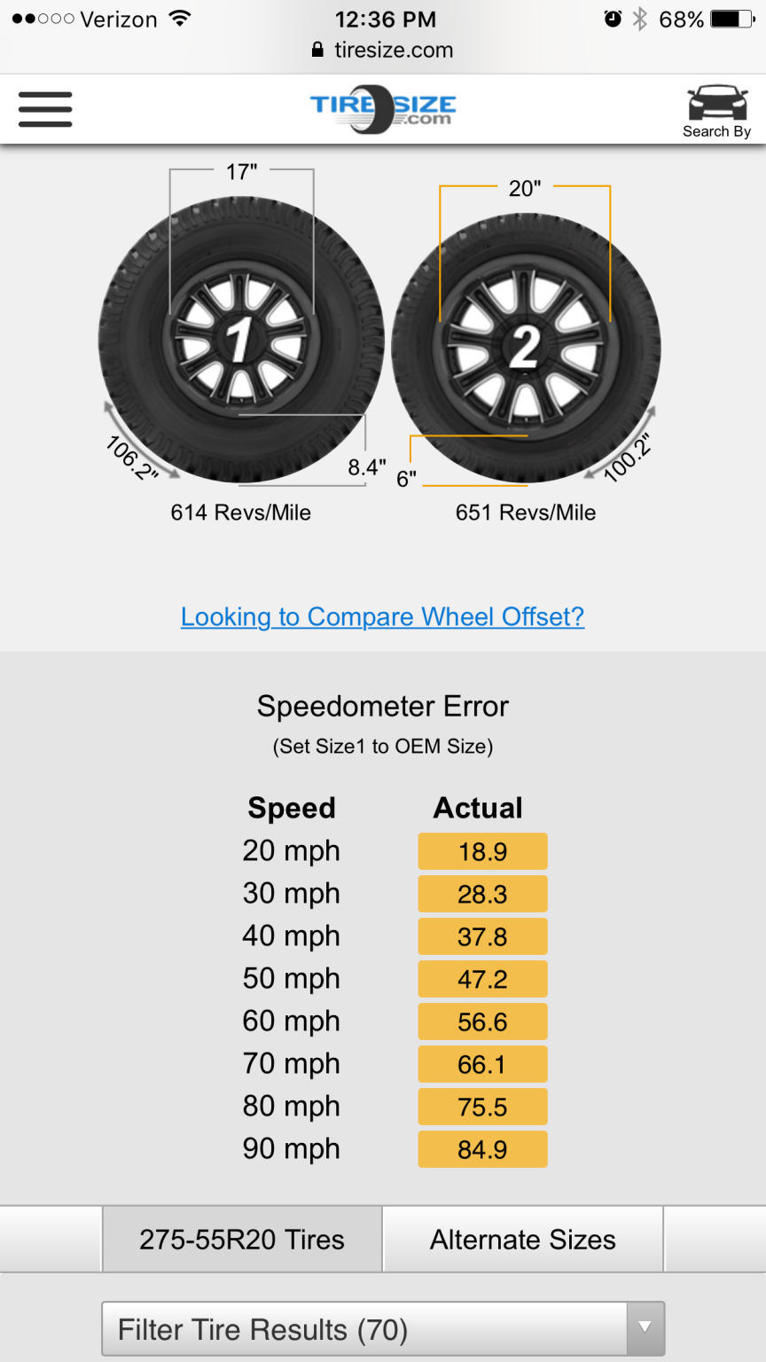

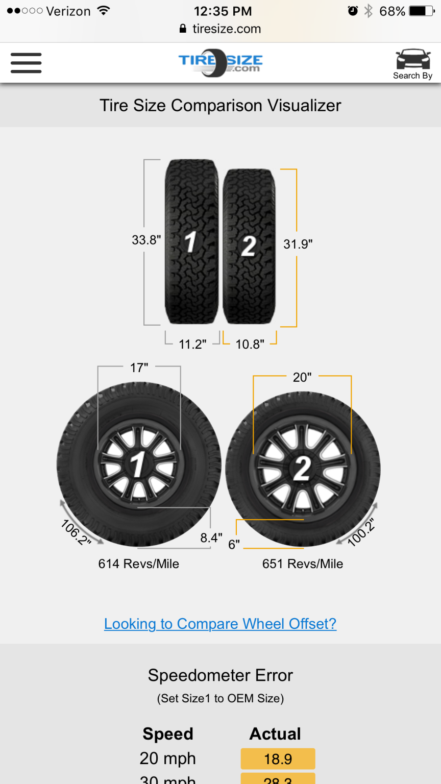

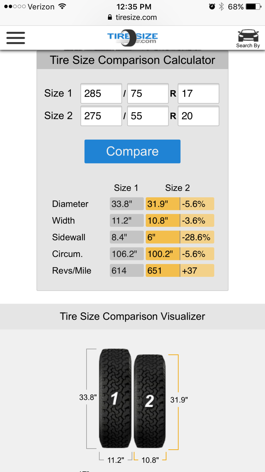

What he said.IMG_9546.PNG IMG_9547.PNG IMG_9548.PNG Mine is a rough country 2" level.....i have the 285/70/17 and no rub.
