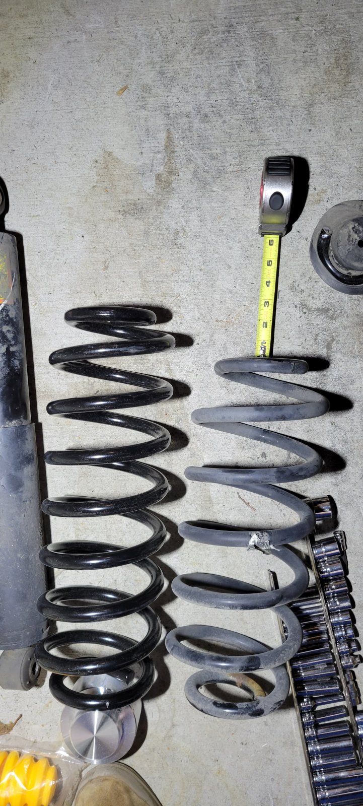

Thanks for the clarification. The new springs are actually 2" taller than the ones that came off my Yukon. I guess they might ve the original springs that are hella worn out? 20230424_203737.jpg

Just like a child with a new toy, I couldn't wait till tomorrow to start wrenching. So I started hitting it from the back. I removed the rear shocks and springs. Not sure if these are the originals but they sure look like it. The original spring is 2" smaller than the new Moog Z71 81068 springs. Bilstein rear is 1.25" taller than stock. I can't wait to see what the ride quality difference is like once this is complete.

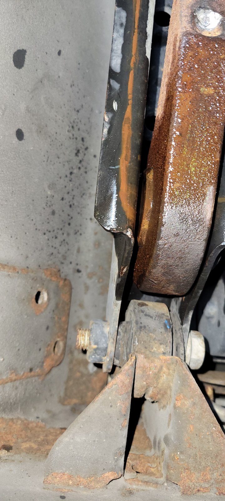

Tomorrow I'll finish the rear and do the front, hopefully. Also, should I treat the rust where the springs mount on the top? What do you guys use? It looks pretty bad.

Yup, those Z71 springs are longer, and stiffer than your factory springs on your Yukon. SLT / SLE? Do you have the Nivomats? Sorry, too many threads, and I forgot.. (Nivomats are RPO: ZW7) “Premium Smooth Ride” if you do have them, how many miles on them? Those shocks make up the difference for the smaller, softer springs. They’re honestly pretty amazing in my opinion, for the tech of the day.
ETA: Re-read your first post in the thread. So yes, the factory springs are ZW7, and were not necessarily worn out. They’re made smaller, with less capacity than the standard springs, due to having the self-leveling Nivomats. There is also a 3rd spring option, for the non-nivomats, which would be in-between the capacity and size of the ZW7, and the Z71 springs. So you’ve got another inch or so of height, since you went with the Z71 springs. After purchasing my SLT, with ZW7, I had initially decided to replace mine with standard shocks, and Z71 springs, but ended up changing my mind, and stuck with the Nivomats. I’m very happy with them, just wish they weren’t so expensive to replace.

ETA3: I’d clean up the rust with a wire wheel if you can get one in there. Guessing you don’t have much room though. Maybe a dremel, to clean it up? If you can manage to get the corrosion off, I’d then clean it with something like denatured alcohol, and once dry, put a good coat of POR15 on it, or even just some black chassis type spray paint.

I did think about replacing with new Nivomats but I decided to do Z71 Springs and Bilstein 5100's all around. I had read before that the Z71 springs were only 1" taller than the Premium Smooth Ride ZW7 springs. That's why I was confused and thought my springs were worn but thanks for the clarification. I ended up buying spring compressors to fit the springs in with the spacers.
Everything else in the rear went pretty smooth after. I ended up cleaning the rust using the same method I use at work to remove corrosion on Aircraft airframe components. I used alcoho to clean with a wire brush, and CPC to treat it. Basically same method you said. Just with free stuff I tactically acquired from work.

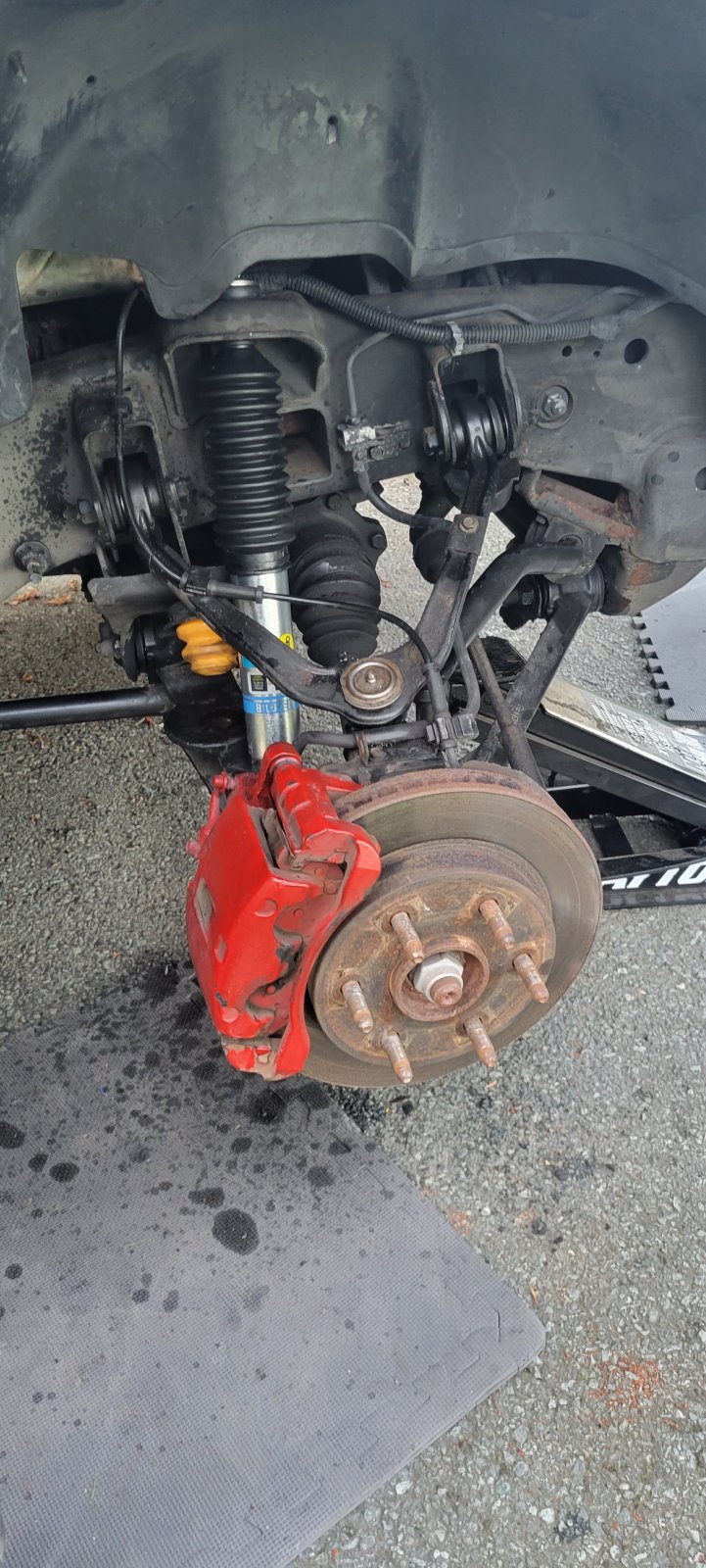

Finished the front side today. Torsion keys were on there pretty good. I ended up spraying PB Blaster twice a day for 2 days and banging them with a 4lb hammer till they finally came lose. I bought a BernzomaticTS8000KC Premium Torch Kit as a plan B but didn't end up using it. Plac C was to rent a Rotary Hammer Drill and banging at the torsion bar where the key is at. Glad I didn't have to do all that. I love you PB Blaster (even though you smell like death.)
Using the Supreme Suspensions Tosrion Key tool semed a little harder to use than the C Clamp torsion key tools I've seen people on YouTube using. It just wouldn't sit in place properly on the top side of the crossmeber while tightening/moving the torsion keys up. Made it work after struggling for a bit. Front shocks were the easiest to put on. The wheel well cover got in the way while removing the nut on the top side of the nut. It would of been easier if I had used a ratcheting wrench. Next on my shopping list. Old struts and bushing were very worn out. Notnsure if they're the original that came from the factory.
All done with suspension for now. New tires, or maybe even bigger wheels and tires tomorrow, then alignment. Next on my list, maybe a few weeks after the trip, is replacing all bushings, ball joints, pitman arms, etc.
