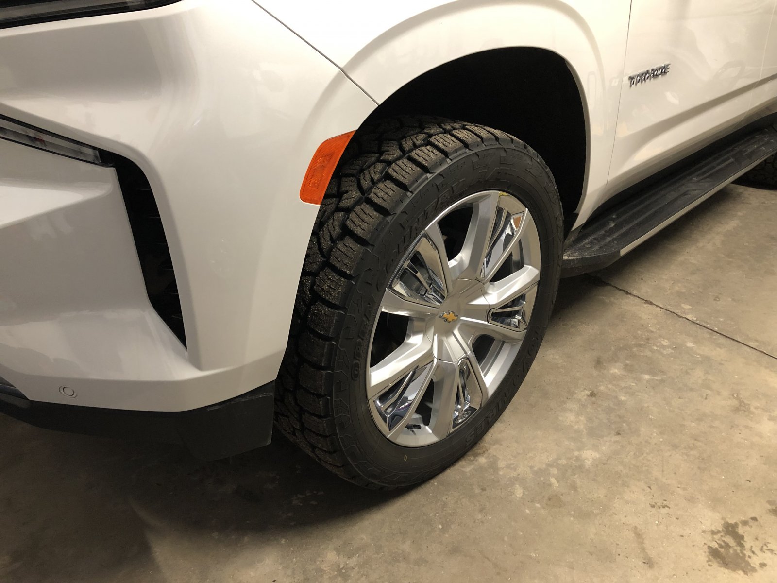

Nice rig!
One question…does it have air suspension or normal struts?
All your ideas sound great to me! Will be a great setup in my opinion.
Last year i did something along those lines with my wifes high country, but only went 1” up front and stock in the back…anymore than 1” higher up front and you will get the sagging ass look with these newer rigs (imo). We kept the stock 22’s and wrapped 305/45/22 toyo at3’s around them. It has been an excellent setup for her during winter months. Came from the nitto terra grappler g2’s (which i also highly recommend - phenomenal tire too), but these seem just as good for traction and wear.

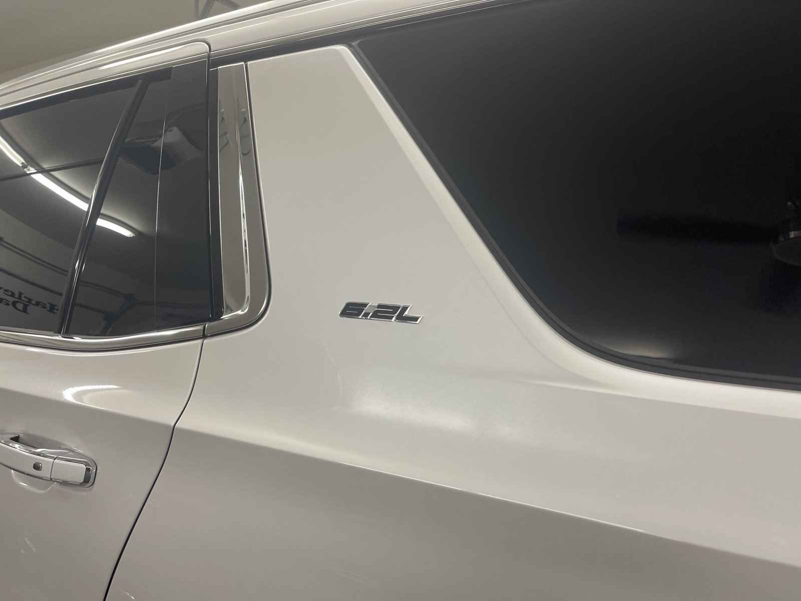

Off topic…but what is the badge on the pillar between the rear windows?
First off thanks for the info in the previous post!! It's funny you mention the Nitto's......that was on my list as well!! I would agree with getting the front too high, that's why I was looking at doing a little in the rear as well.
As far as the badge, it's a small black and stainless "6.2L" emblem. I came across them a while back and had them on the previous Eski and Denali. Something a little different that makes you look and I guess it worked again!! LOL

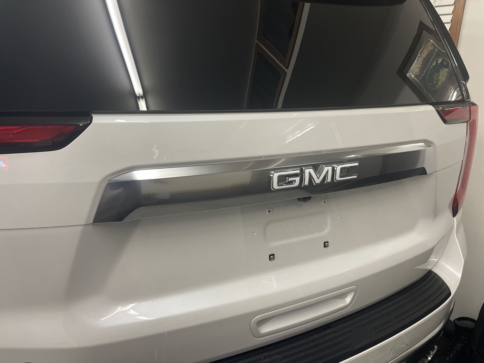

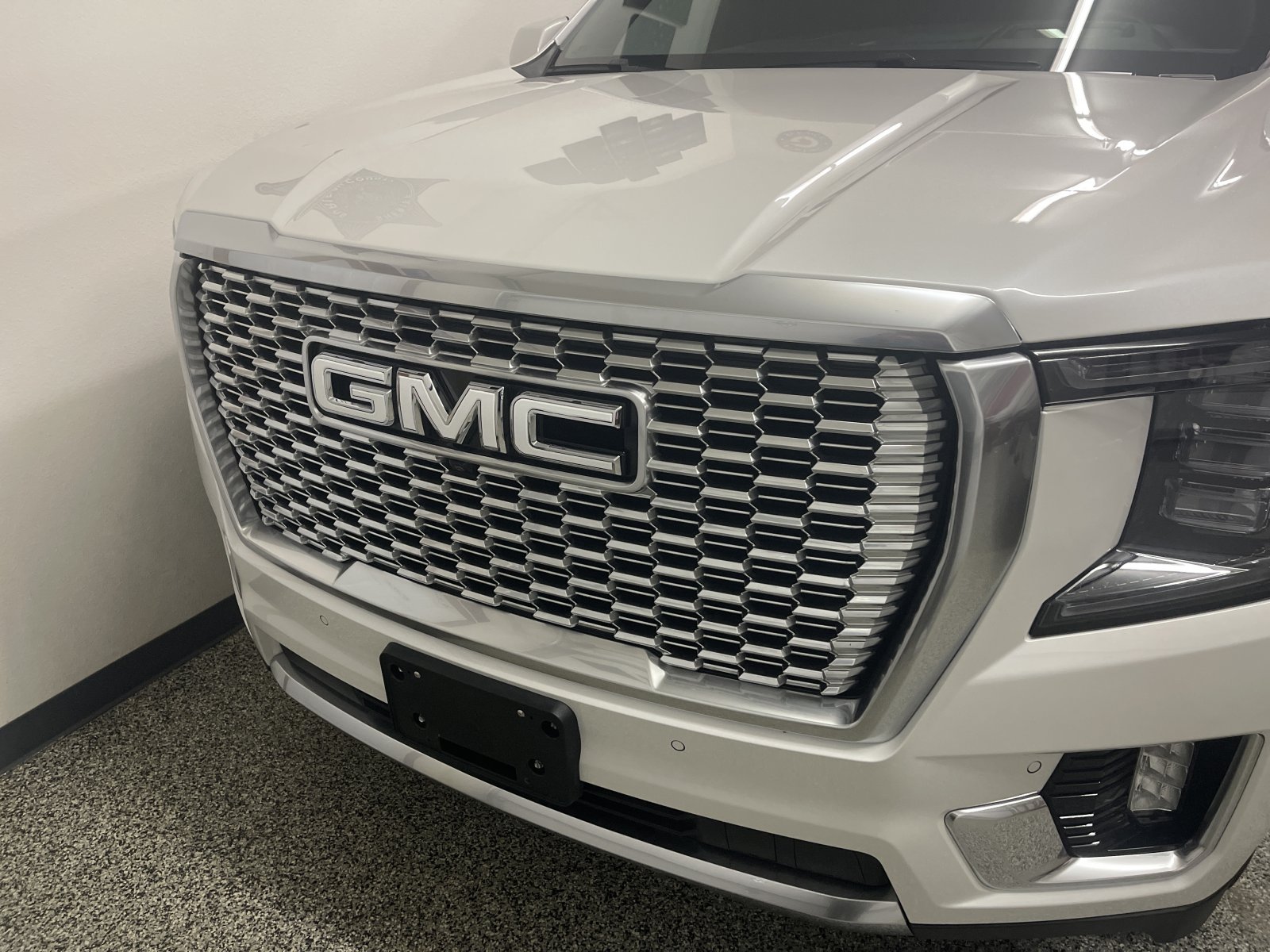

On a side note, I also did white carbon fiber wrapped front and rear GMC emblems.

Im diggin’ the gmc logos for sure!

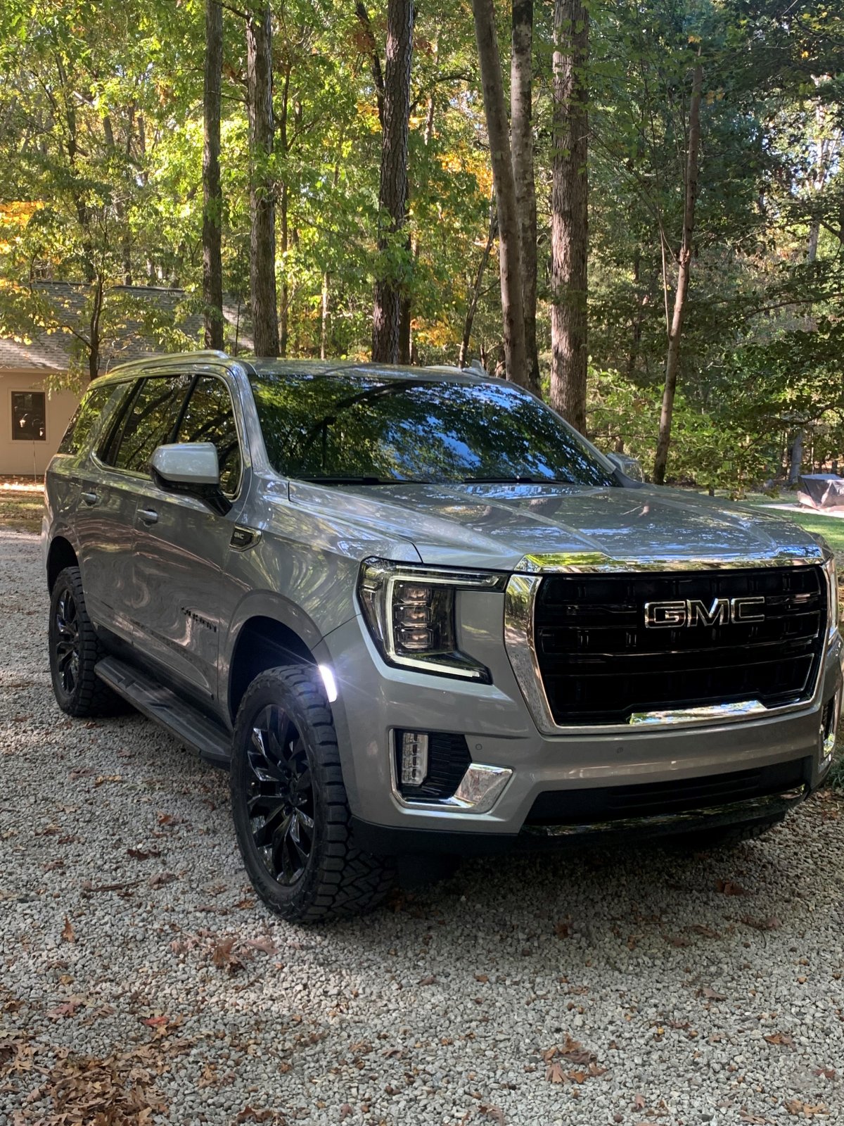

I think you're right on with your set up. I can't speak for Toyo tires but I do have the Nitto Recon Grapplers. They're similar to the Ridge Grapplers but perform better on road, which I'm on 99% of the time. Consider these. I used the RC 2" and it came out like this. It's a bit of a physical step up when you have something in your hand like briefcase or gym bag.

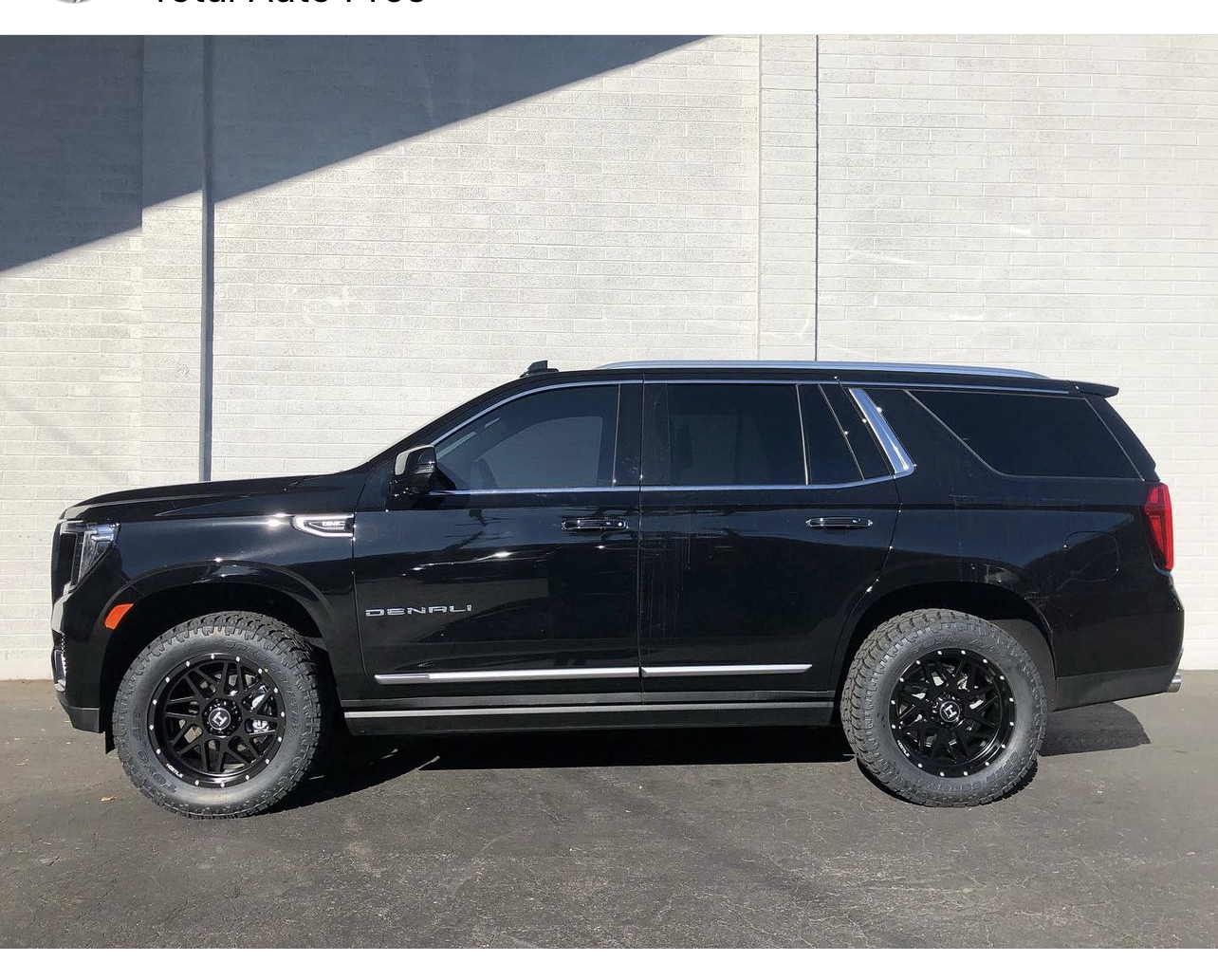

I was also able to come across a pic of a similar setup.
This one has 20x9 wheels / +12 offset with the 285/60 r20 tires.
This one also has the Traxda level lift but I’m not sure if it has the rear 1” lift.
I have wheels and tires on order the Traxda lift is here ready to go!!

Thanks!!
I've actually had Toyo's and Nitto's and honestly there both awesome but then again.......there made in the same factory!! Now I haven't had a chance to try the Toyo AT3's on an SUV (but soon I will) but I do have them on a 1/2 pickup and they have been great!! We also had Ridge Grapplers on the last Denali and they were good too so I'm anxious to see the difference between the two when comparing SUV to SUV. I also have Toyo RT's on my 3/4 ton and those have been really good on that vehicle.
What size tire are you running?
I'm running 285/50R22. Looking forward to seeing your setup. Merry Christmas

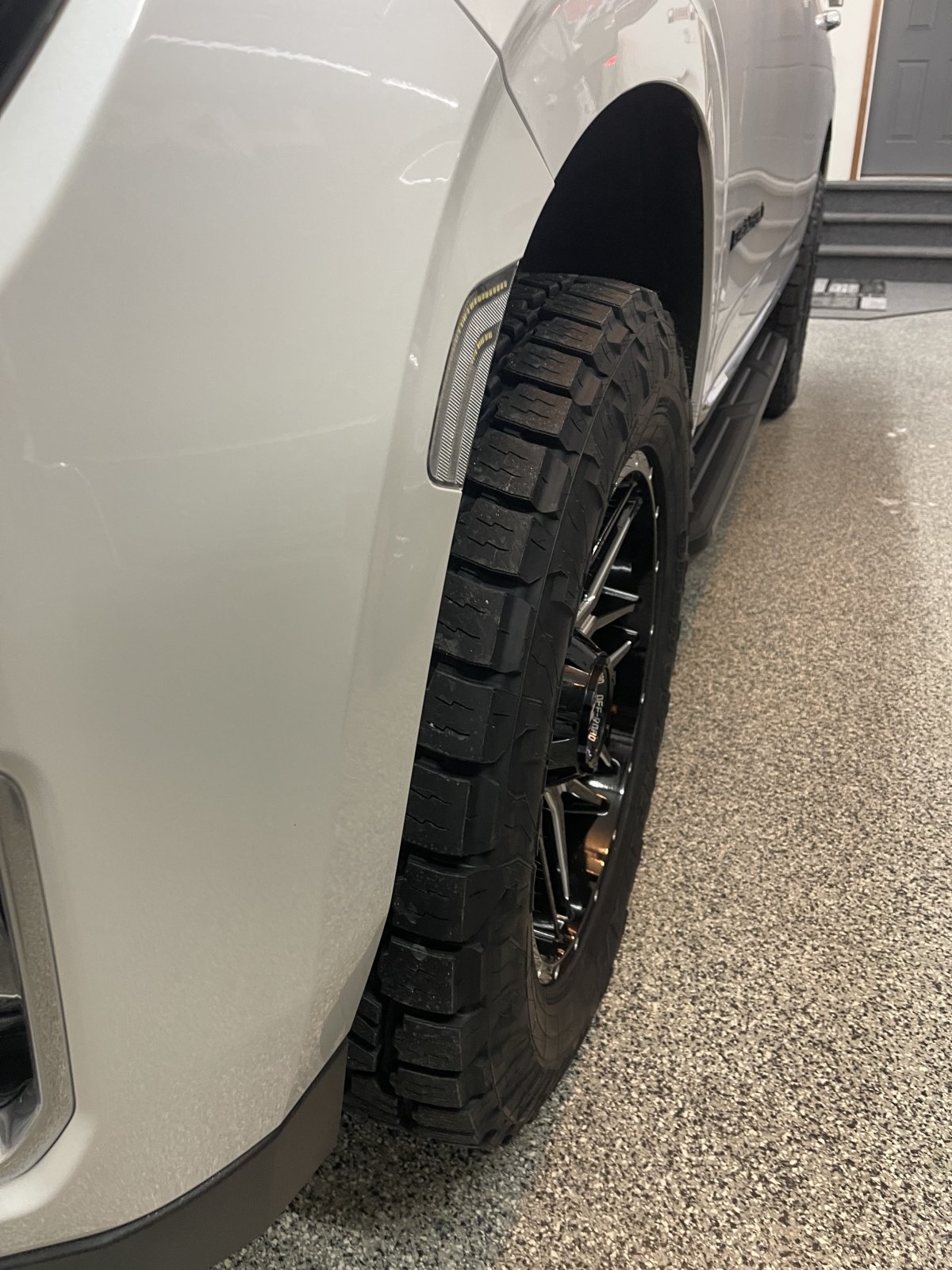

FINALLY got everything in and installed!!!
Below is a before pic and of course the after. I also put some side pics to see how much "poke" there was but those are tough pictures to capture accurately.
The set up is as mentioned in the beginning,
Traxda - 2" front / 1" rear lift
Wheels - XF Offroad 20x9 / +12 offset
Tires - Toyo AT3 285/60/20
Poke - No tread really showing but the bulge of the sidewall sticks out and the shoulder of the tire can be seen now. So, some "poke".
Trimming - So far just the front Husky mud flaps needed a little bit of trimming.
Roade noise - Not much at all, these are actually pretty quiet tires for an all terrain.
Raised height - Sorry guys, I was so excited I didn't get the before measurement.
