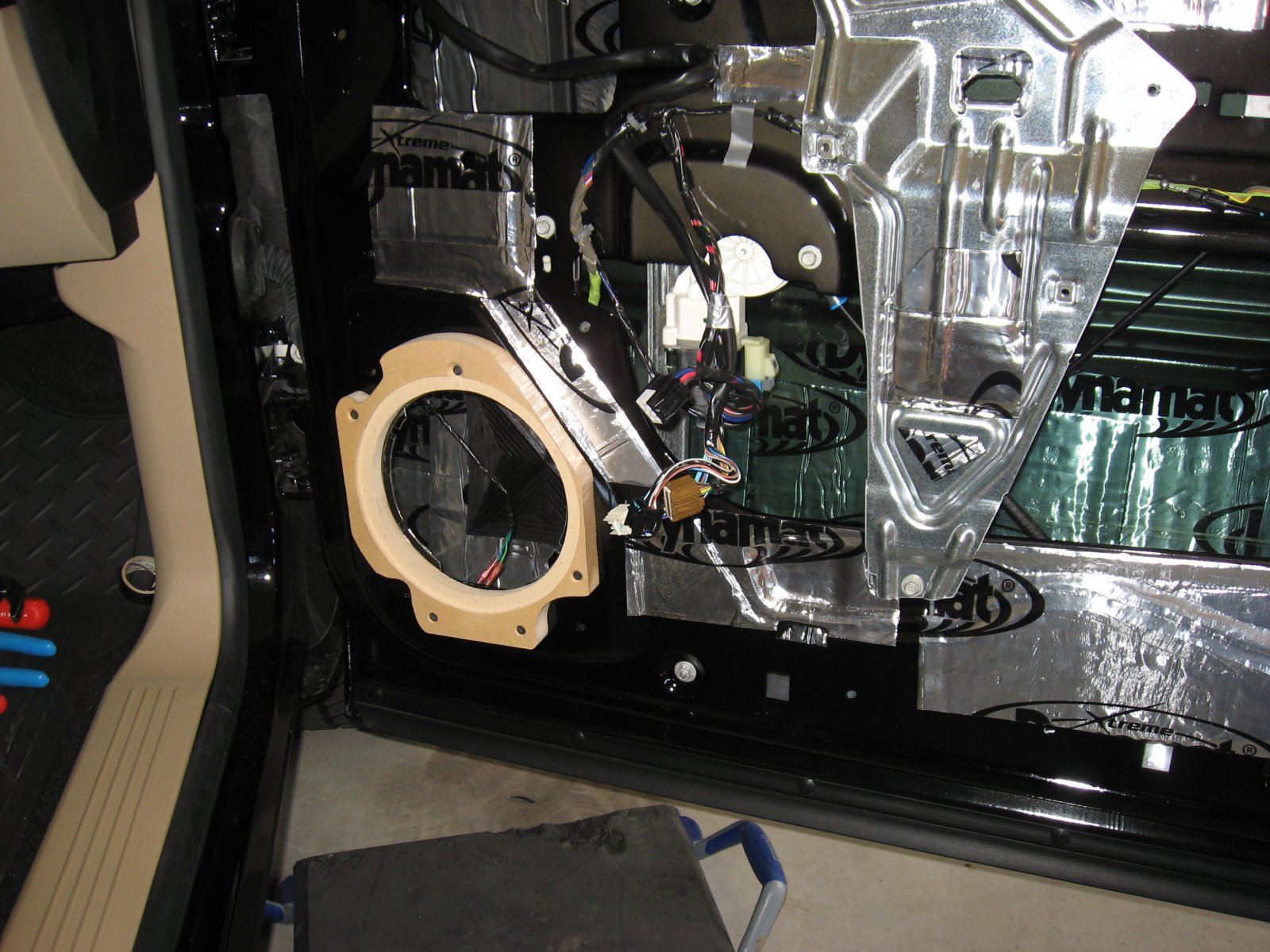

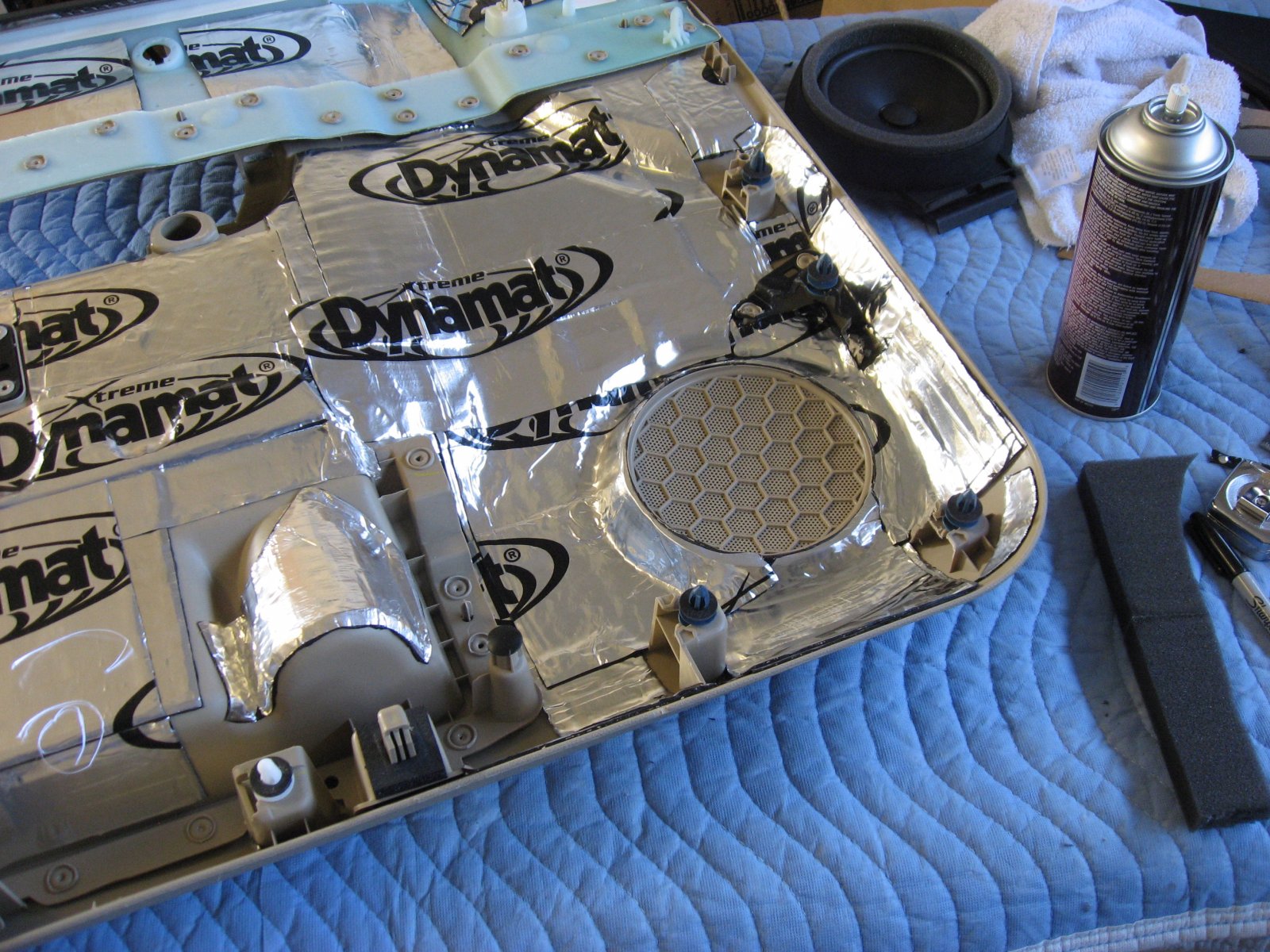

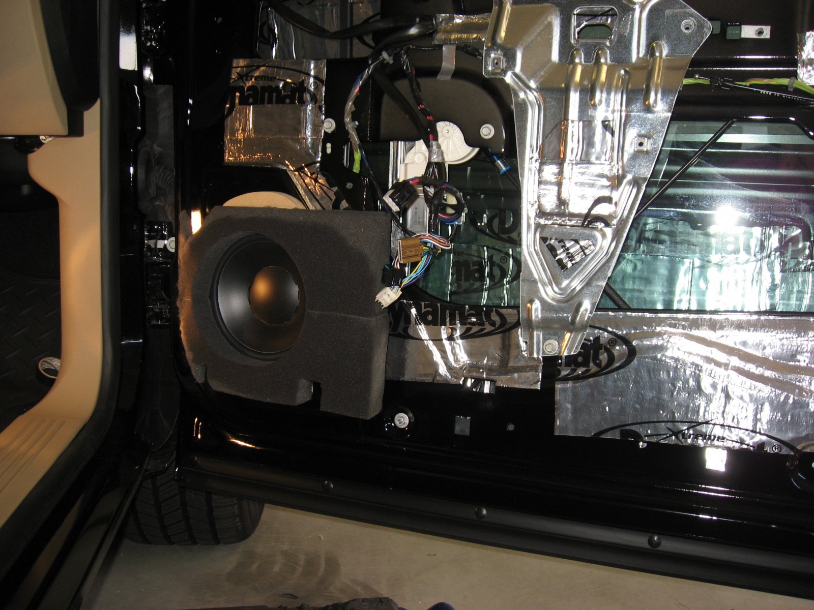

I am posting this because I saw in another thread which I can't find now, someone trying different 6" door speakers to get better midbass. If you want to get good midbass from your 07-14, put 8" midbass or woofers in the doors. I did this in my 08 Sierra with the use of a speaker rings/adaptor that I designed. I have attached a PDF with a scan of a speaker ring/adaptor. You can print it, and cut it out and use as a template to make your own out of 3/4" MDF.
This along with a good amount of sound deadening, and foam between the speaker and the door panel, will get you good midbass in one of these vehicles.

I have edited my original post because the way it was worded was a little unclear. I am providing a template for others to use to put 8's in the doors.

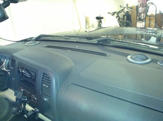

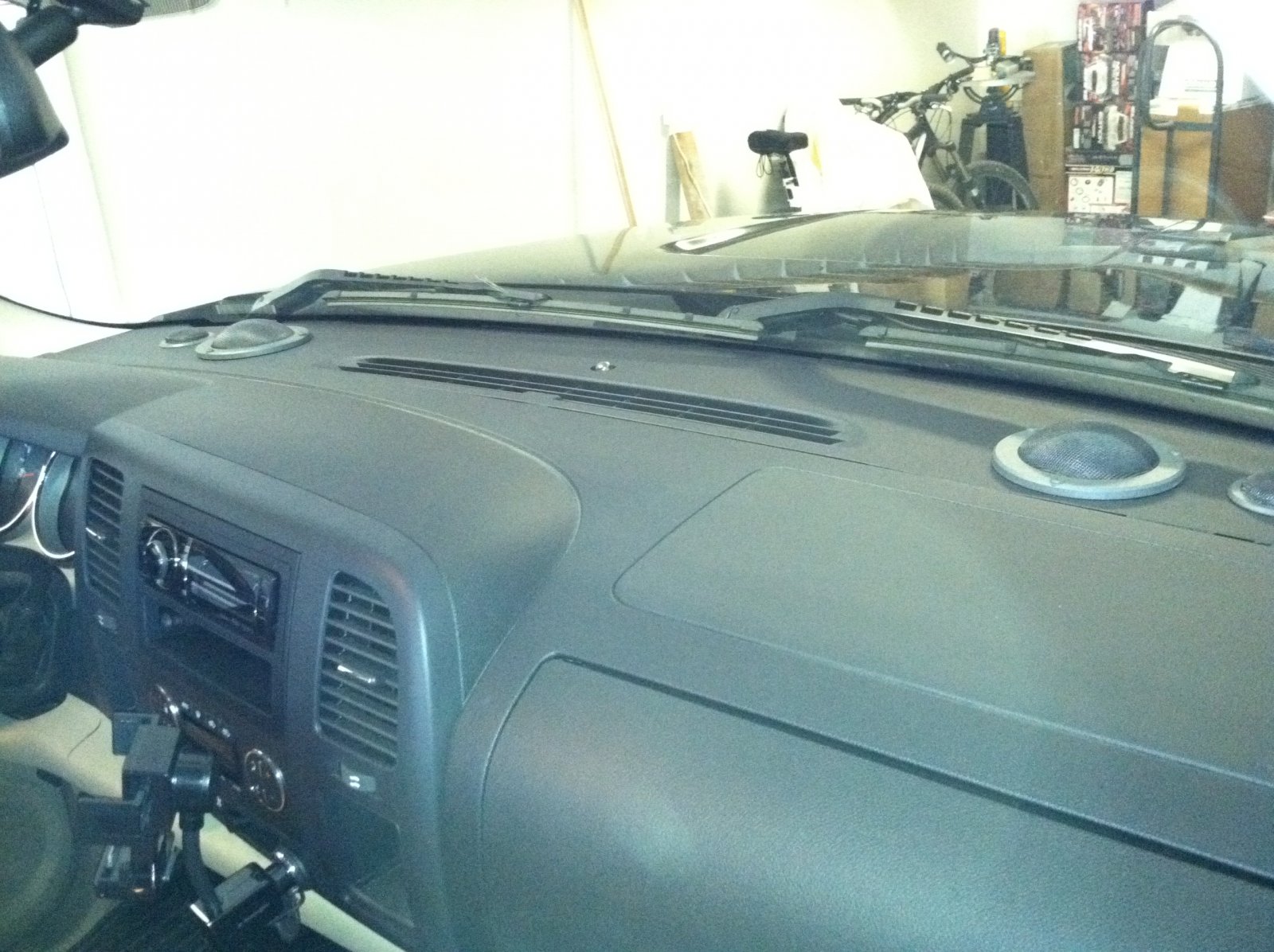

I started with the Dynaudio 8" in the doors, 3" dome and 1" Dynaudio tweeter at the top of the dash. But because the 3" did not go down low enough for me, I changed the 3" to a focal 4" mid and 1" tweeters with the Focal 3-way passive crossover. I had to cut out the dash and heat/bent the AC vents under the dash panel to get the 4" to fit. I ran this 3-way with a JL audio 300/2 and had a single 10" JL sub ran off a 500/1. This along with about 100lbs of sound damping material made this truck one of the best sounding/ staging vehicles I have put together. Here is a photo with the original dash speakers before I changed them to the focals.

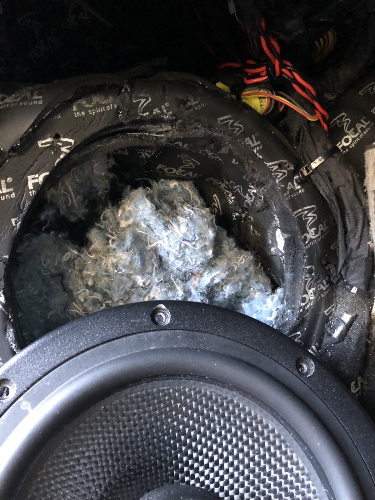

Great idea. I haven’t thought to place the mids and tweeter on the dash. Currently my setup is stacked in the door panels. The imaging is good but I’ve been thinking about relocating the L3SE’s in the sails with tweeters in the factory Bose location. The doors I cut up are from an Escalade so I have the old ones in storage. The sails could be difficult to execute well. Especially since I use fiberglass one every 10 years. Might have to go the dash route now.
I also used about 100lbs of deadening materials along with 40’ of aluminum L-bar and gallon of panel bond.
I have a tendency to go heavy on the sub stage.
I do love the mid-bass response of the 8” in the doors vs the 6.5” I started with. Have you thought about sealing up the large opening on the door behind the panel? I used plexi(because I had it) then sealed up with deadening. It seemed to isolate the rear wave more and helped provide more punch. I am running 300 watts to each 8” so I could feel airflow around the bottom of the door prior. Now there’s far less and mostly around the glass. Thanks for the info.

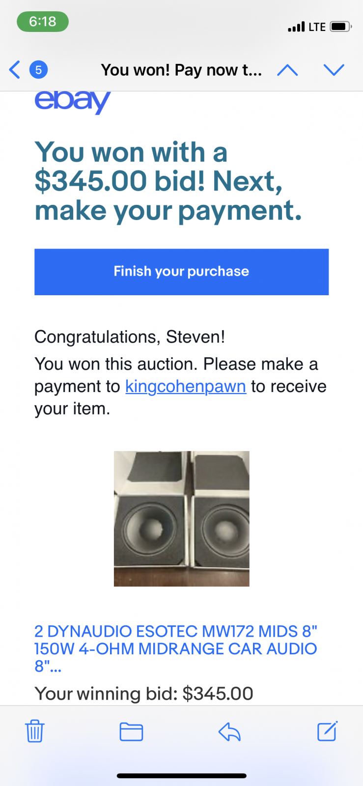

I hadn’t thought about sealing up that hole but can certainly see how that would benefit; maybe I’ll do that on my next one which I’ll be starting soon. Speaking of 8” mid bass, look what I just won yesterday
That's an absolute steal! If I recall correctly those retail for $1000. Great midbass drivers as well! You been thinking about going active? You could run 200 watts just to those drivers with the right filtering. In the car audio world the DSP has been the biggest game changer in 30 years. There's a bit of a learning curve but I wouldn't build another stereo without one.

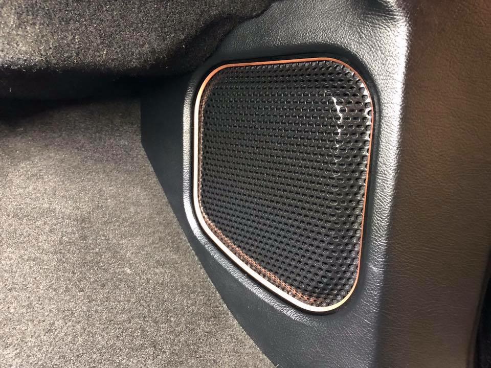

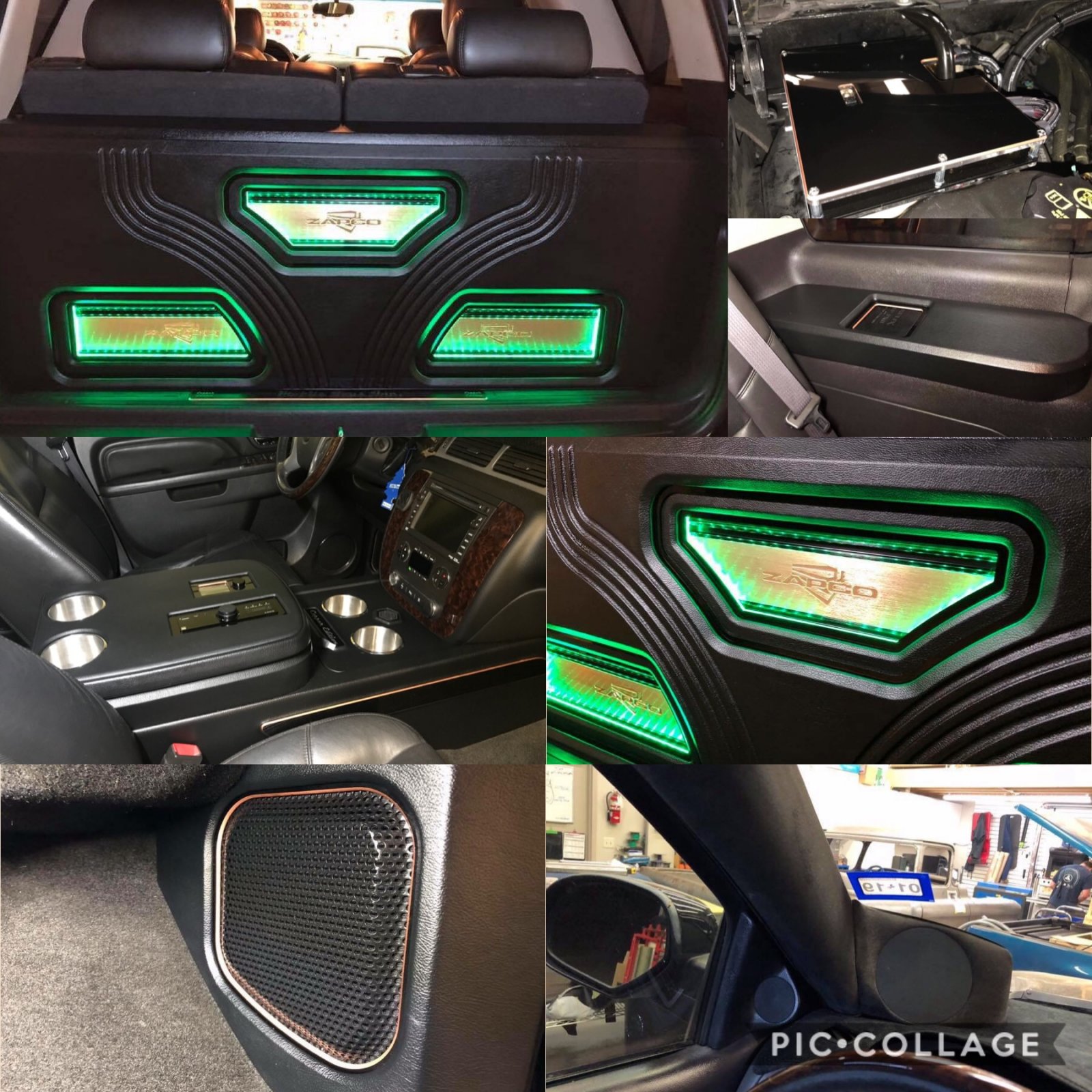

Kick Panels for the MB win- imo. Ive been running 8” Illusion Audio C8’s for a couple of years and couldn’t be happier. Making sure your subwoofer to midbass phase and transition is correct really helps.
Also have a 10” Raven clean subwoofer in a custom console firing up into the dash.

lol.... nice mic drop there.
obv... beautiful setup. it flows well. pretty nice mounting the director in the console lid... personally i would've put it in the console tray, and omit the cupholders there. If i had the money I'd send my yukon over to Peter @Pssound. i'm almost done sound deadening up front, def gonna need it with the JL in the console, and i love that its placed all the way up front. Tuning will be easier i think with that config. i am definitely using that idea of mounting the midrange in the dash. My tweeters are perfect in the pillars, this should be fun. just takes time since its my daily. i can't leave it apart for long. Thank you for posting such beautiful work!!
