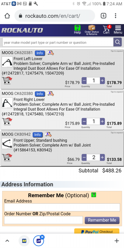

I'm about to fix the ball joints, thinking about just doing the whole control arms instead of messing with pressing out everything, because I've never really done that. I have the Moog parts in my cart, but I read here that moog's quality is going down.
The better Moog arms are right at 500 with shipping, which is already more than I really want to spend, but I don't wanna have to replace them again. How much more would it be for genuine gm? I'm not seeing them on RA. Or is there another aftermarket that is better than Moog? I've seen people post about polyurethane bushings also, what are your thoughts on them?

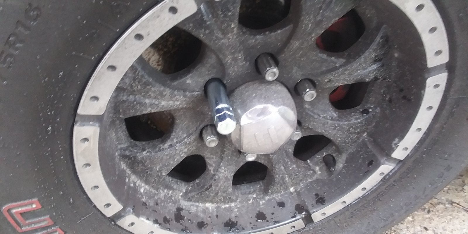

Oh, I can also pop this wheel off and see where the brake leak is now. But it's storming and I'm not trying to waste my shop access right now lol

I tightened the bleeder valve on the caliper, and fixed the leak, then stabbed a hole in my radiator trying to see why this latch wasn't working. Guess I'm headed to pick and pull in the morning...

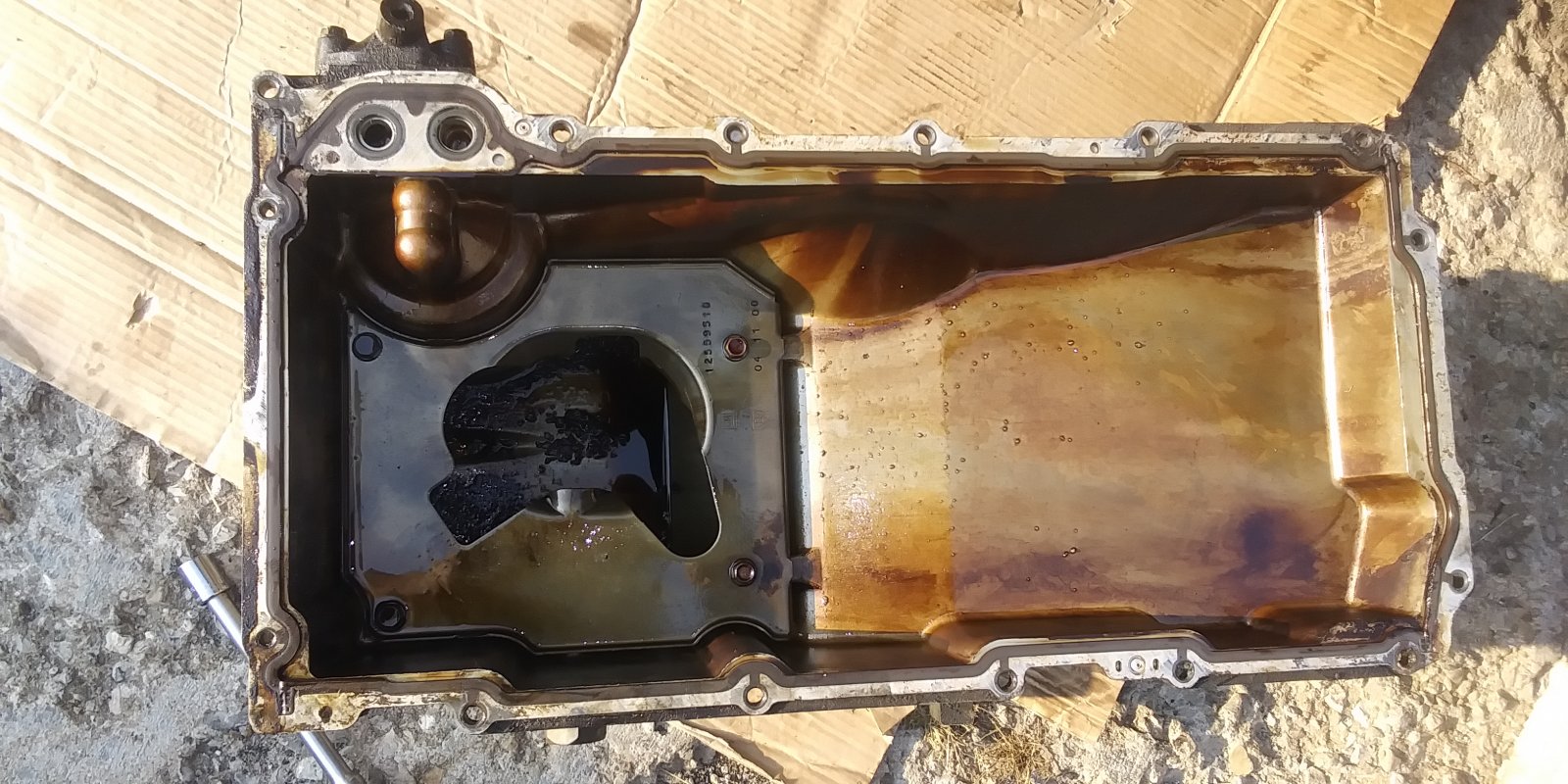

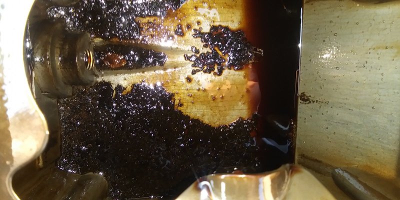

So yesterday I pulled the front diff down, dropped the pan and puta black fel-pro o-ring on the pick up tube. It fixed my low oil pressure for about a minute or two, then went back to 20psi. I wish I would have went and bought a red o-ring like I saw on the YouTube videos, because I really don't want to tear it all back apart. Probably took us about 8 hours of crawling around under there. There was a little sludge, and definitely some metal in the pan, plus some stuff that looked like welding spatter stuck to the bottom of the pan. Idk wether to keep ******* with it, or just drive it till it blows up and drop a rebuilt motor in. I wish I would have seen the extra 2quarts of oil trick before I did all of that work. Definitely not the 7k mile motor the guy told me it was, hopefully the tranny isn't junk too.
