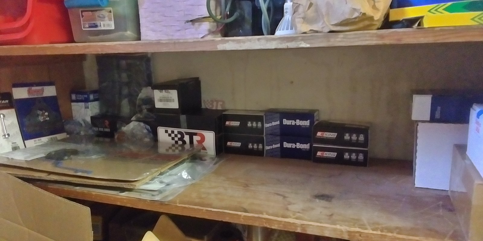

Parts pile still growing, GM knock sensors, oil pressure sender, and cam sensor. Bunch of gaskets, oil pump, lifters, springs, valve guide hats, head bolts, barbell, rings, GM rear cover. This shit really adds up, lol.

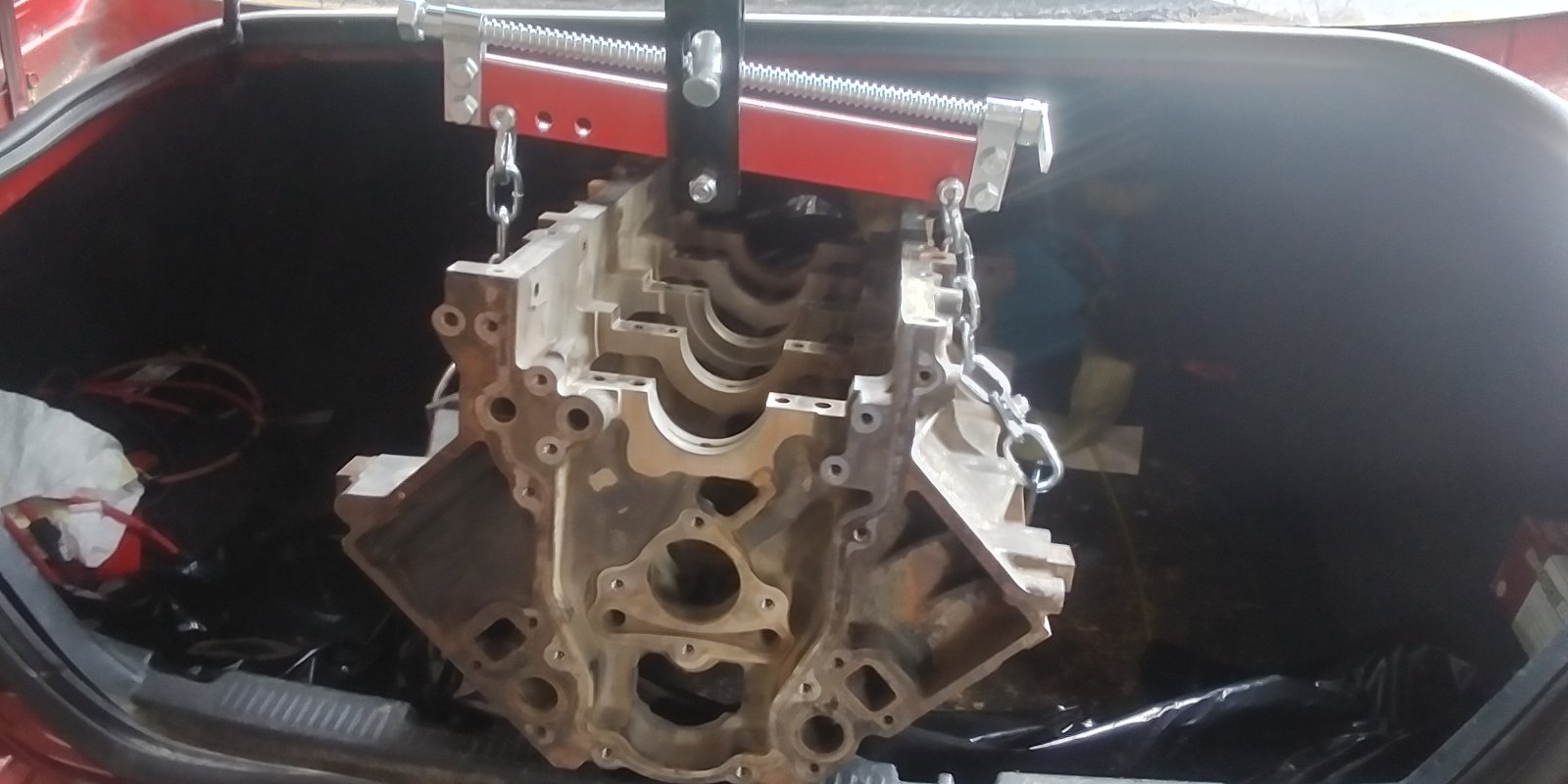

I'm gonna do some research and get this block painted. Sprayed it down with WD-40 until I figure something out

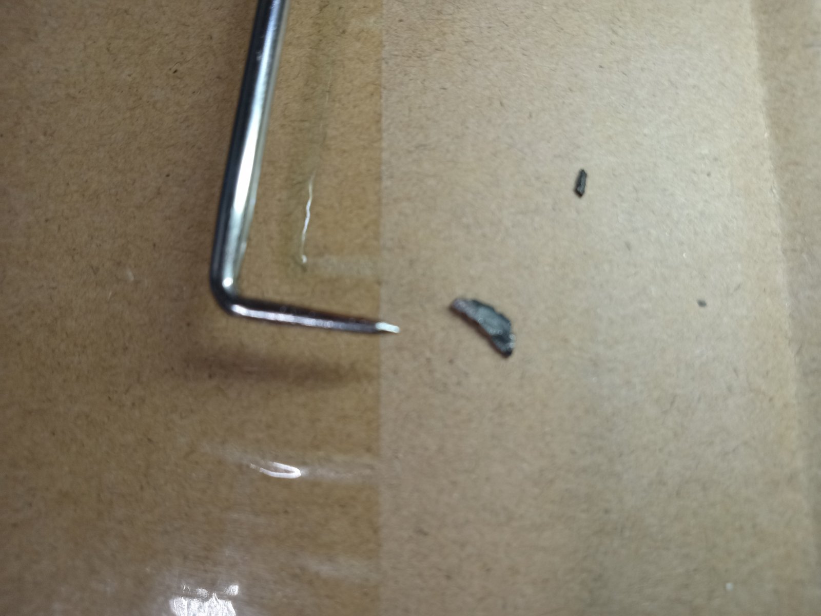

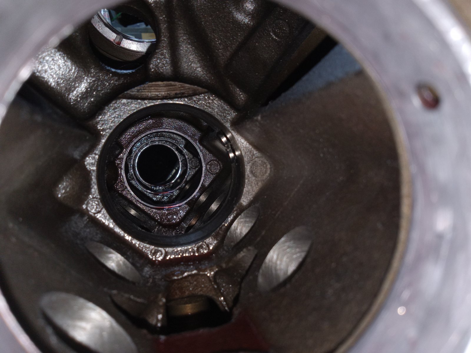

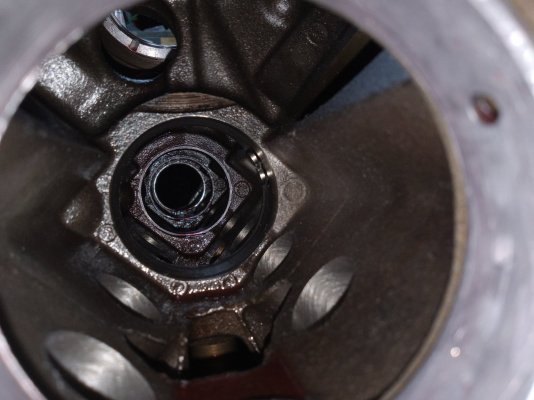

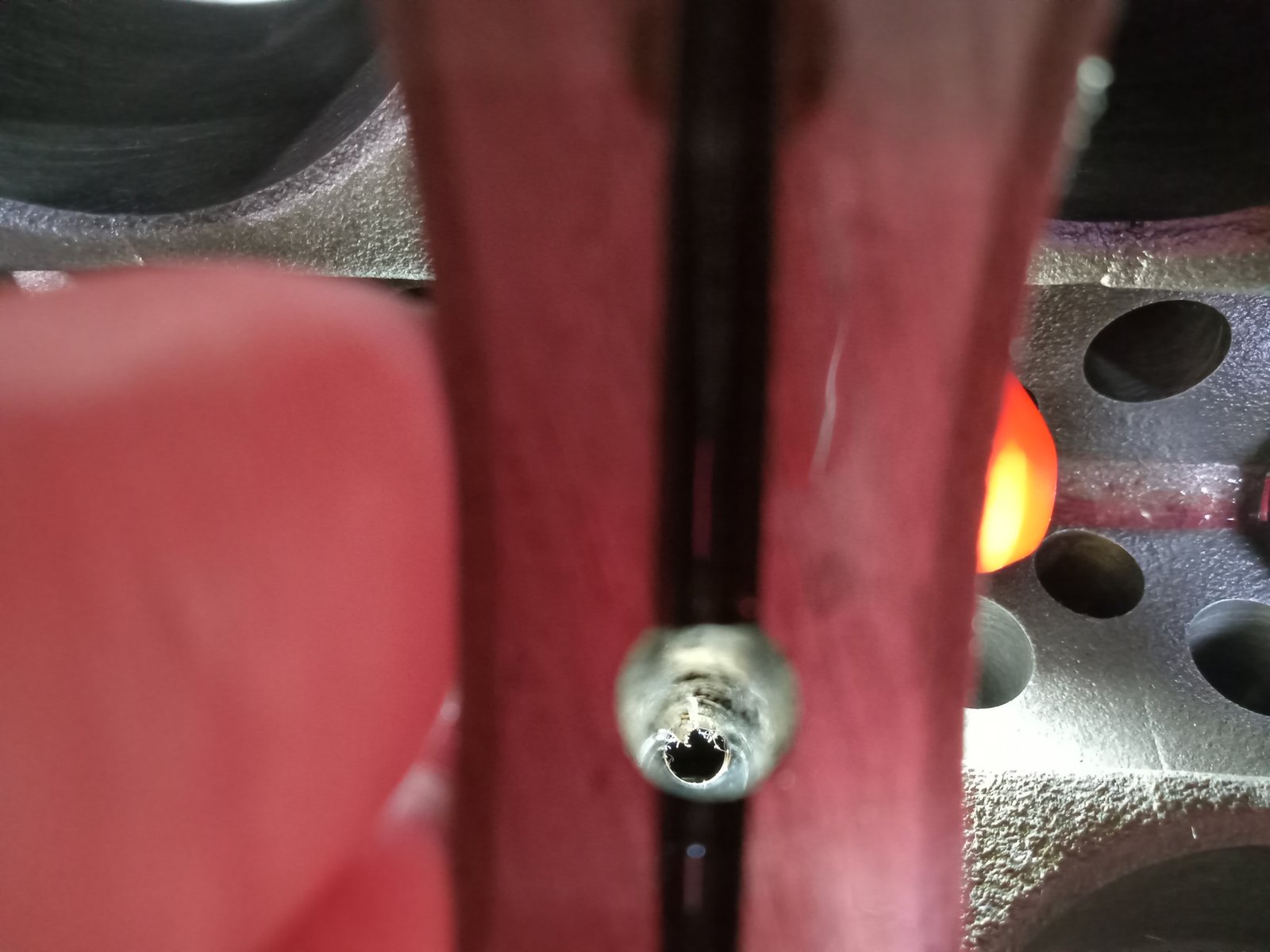

Piece of "lint" removed, #4 cam bearing in with permatex 640000 sleeve retainer. Bout to put sleve retainer on the rest for peace of mind.

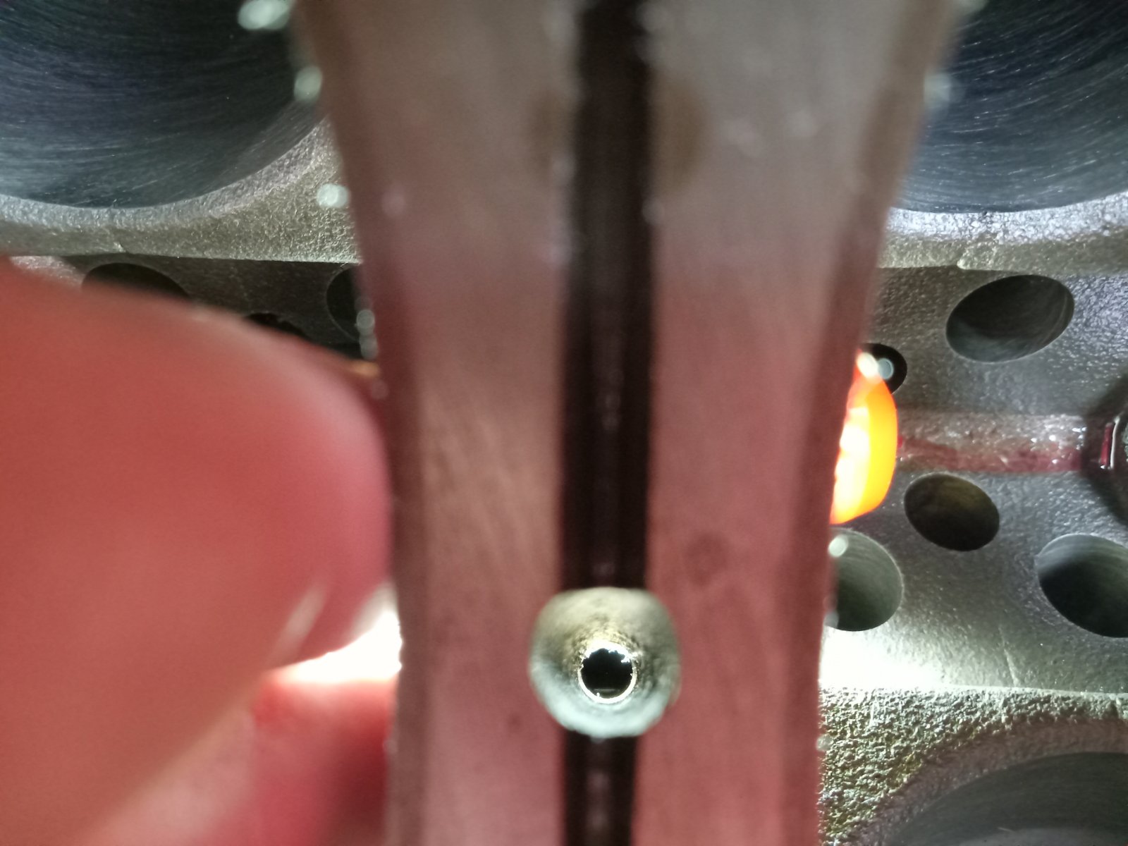

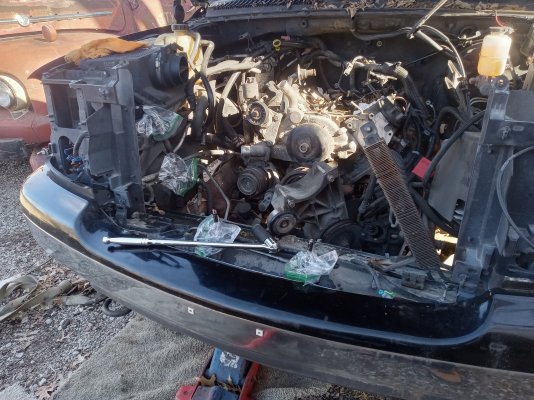

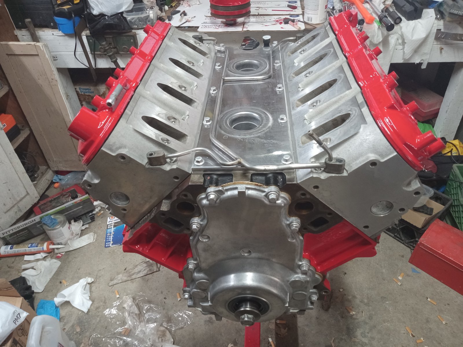

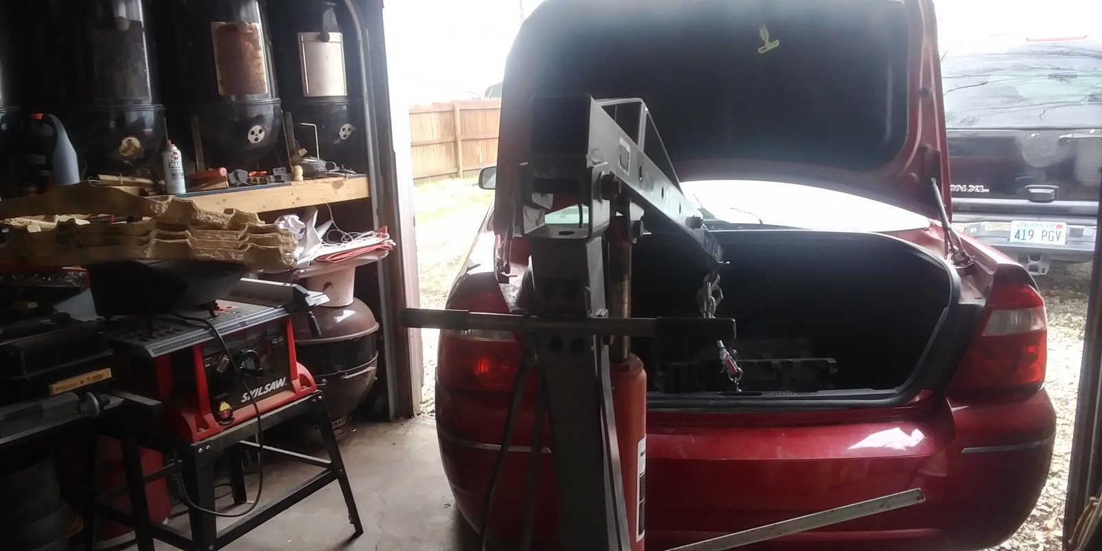

Ordered BTR 11/32nds 7.375 pushrods and have the rockers torqued down now. Gonna toss one more coat of paint on these valve covers and then it will be time to start pulling the old engine.
Got the shed cleaned out this week, so I can move some of these webers out of my way. Need to get the truck turned around too.
My garage is trashed too lol, I'm kind of a hoarder.
