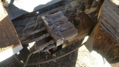

In other news, if someone just so happen to have a hydraulic leveling unit from an RV, what would they be able to do with it in a project like this? Asking for a friend.
