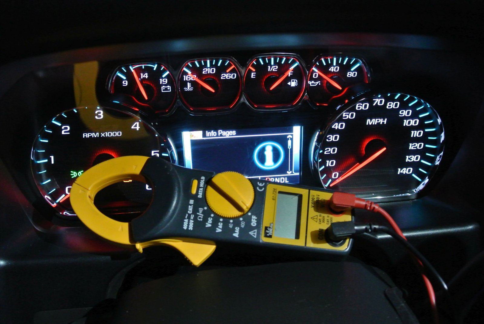

There are detailed explanations on how this system works in the shop manual and the GM Upfitter's manuals. Look up the key words EPM (Electric Power Management) and RVC (Regulated Voltage Control).
For those of you with radio controlled cars, planes, boats, etc. this is basically a smart charger built into your truck, pretty cool.
