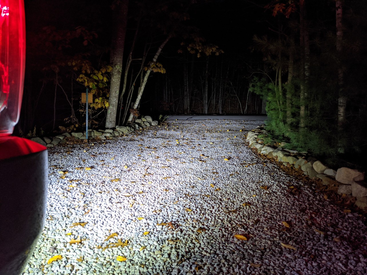

The backup lights on my 07 Yukon XL Denali were weak, IMO. So, I replaced those back-up lightbulbs with LEDs, and there was a significant improvement. However, my driveway has a stone wall on either side, and at night, even with the LED backup lights, there was not enough light for me.
So, I added two 8" light bars, just below the rear bumper (but still protected).

The brand of LEDs that I used for the backup lights (JDM Astar) is not longer in business (pandemic victim), but I believe that most other 'known' brands will provide you with a partial improvement.
I kept the hyperflash, because it is more noticeable to other drivers on the road around you, and isn't that the purpose of a directional after all? I will note that hyperflash is illegal in some states, though.

I added auxiliary lighting on mine too, but I'm a bit concerned with drawing too much power for the circuit. The pod I used is rated at 20 watts, but considering it's only on for the few minutes I'm backing up, it shouldn't be an issue.

Mine were routed back to the fuse box with a direct power run. Then, an electronic relay was added to switch on the LEDs when the backup lights were switched on. An additional on/off switch was added under the dashboard, so that I can manually turn on the LEDs for extra lighting for loading and unloading and camping/outdoor activities.
