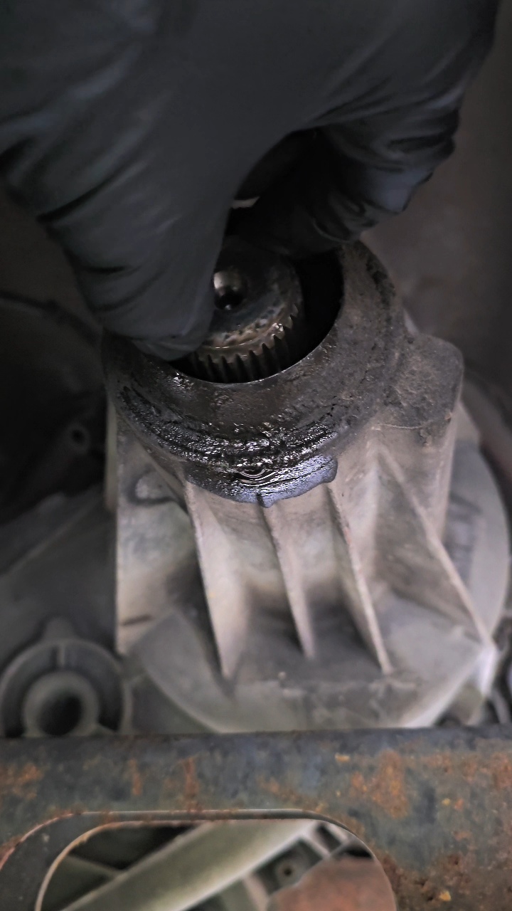

Well im taking it to a shop. I noticed some fluid on the rear yoke and when I checking for play it's pretty bad im thinking a bushing and maybe a bearing. I tried uploading a video but it wont let me. So I took screen shots at the furthest point of travel
