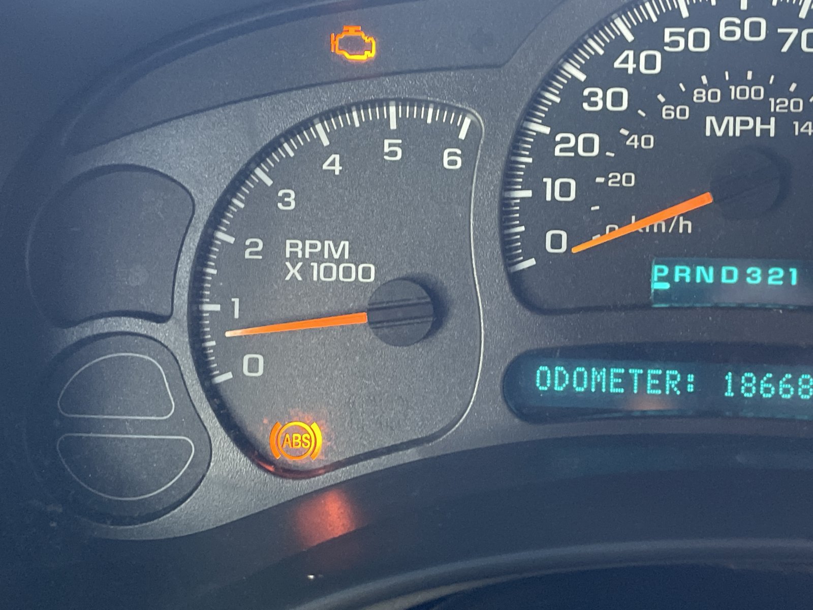

The ABS turned ON on my dash.
there's your sign, if you have 160k or more on it you can pretty much bet money it is the hub, but check things to be sure, you can swap the front abs sensor left/right and see if the problem follows the sensor or not, you will need a scanner that can read abs codes.

ABS turned OFF a while ago while I was driving home, but I still feel a slight vibration and then a few pulses while pressing the brake pedal at around 8MPH.
Moderator
16,626
34,414
People's Republic of Colorado
To be clear, when the ABS light is on there is a malfunction in that system. Put a capable scanner on it and read the code(s) and post them here for more suggestions.

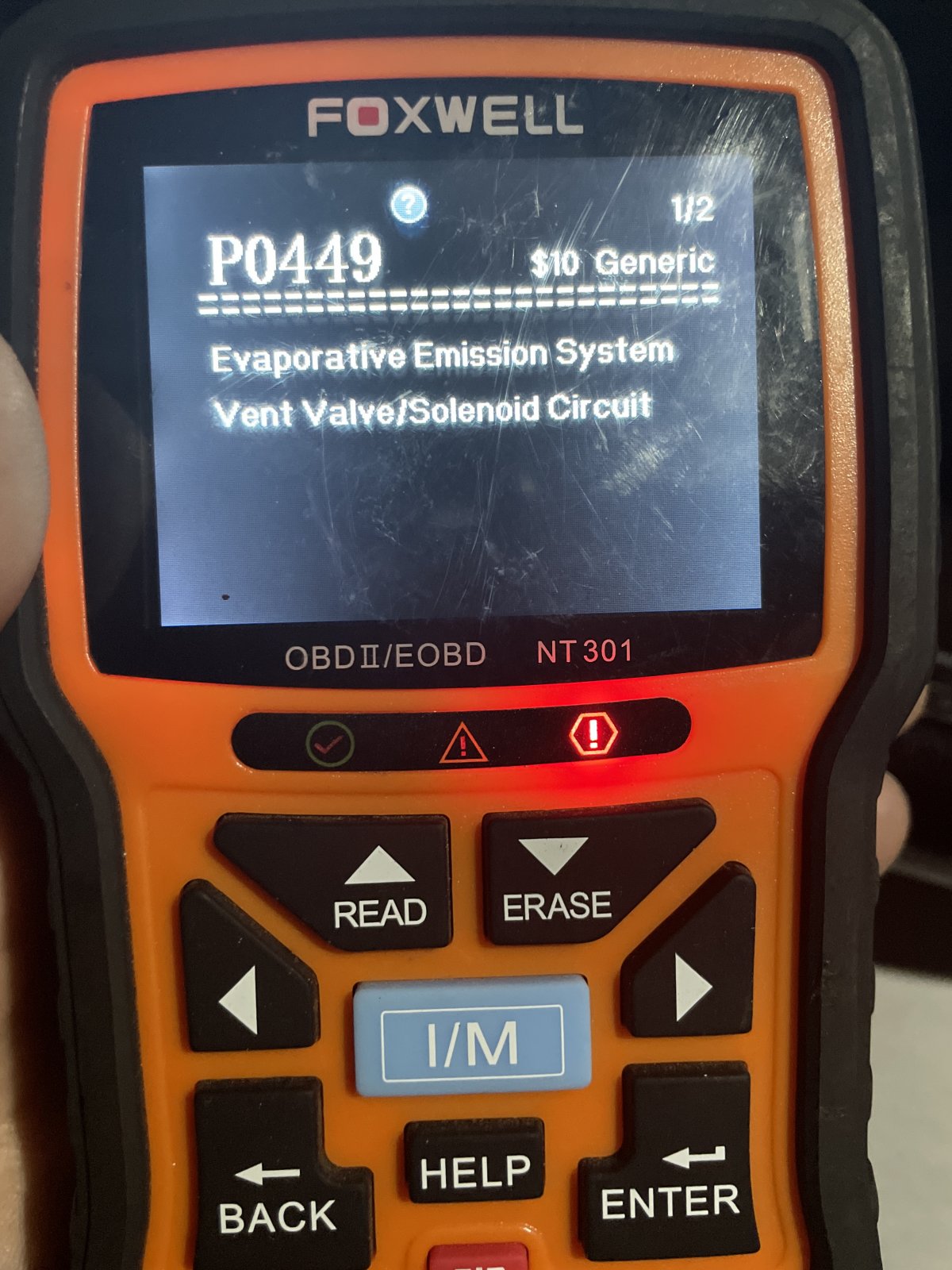

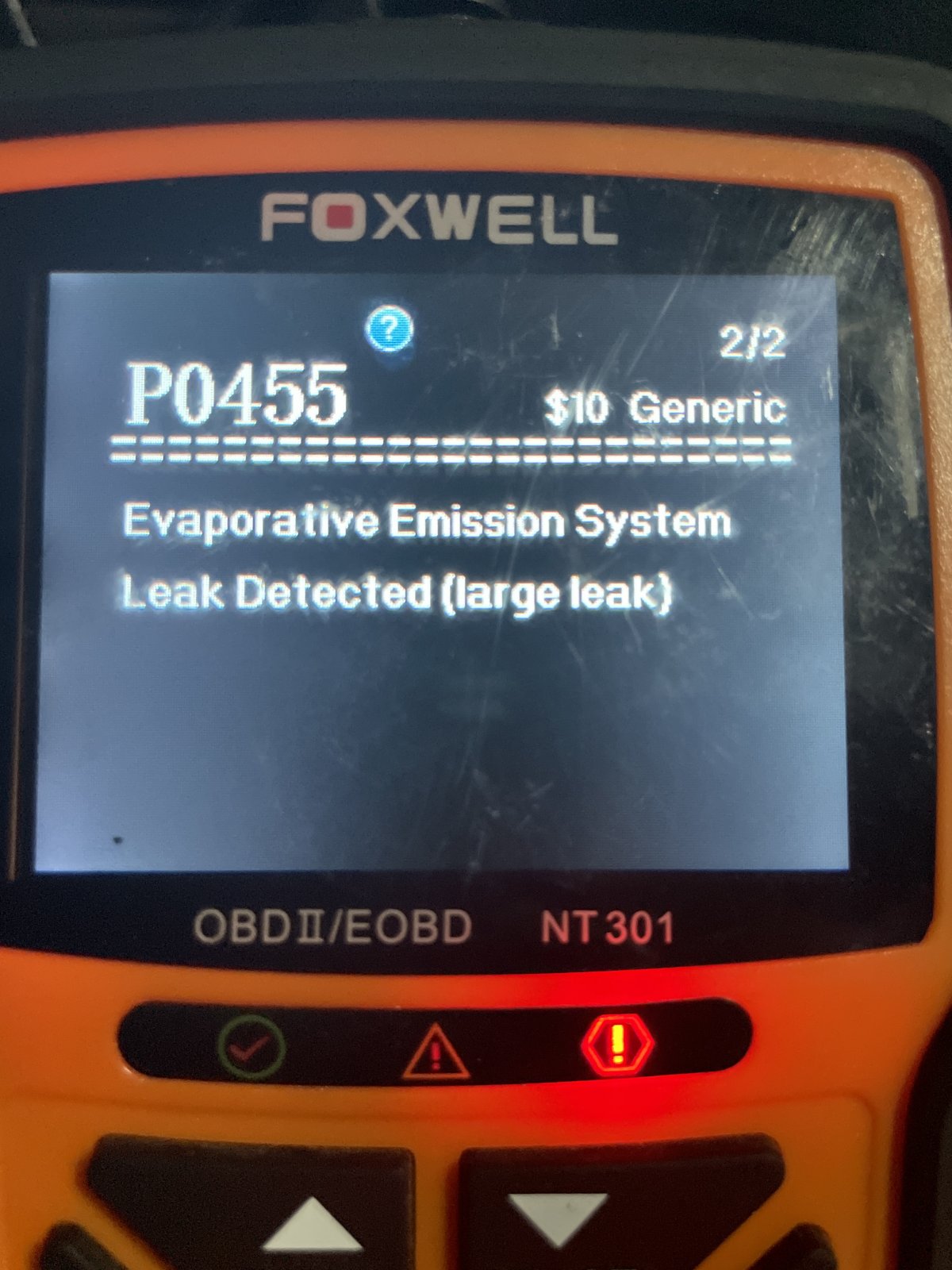

My scanner only gives me a....
P0449 and P0455
If I swap the sensors how will I know if one is bad. Like what tells me it's the hub itself.

My scanner only gives me a P0449 and P0455
If I swap the sensors how will I know if one is bad? Like what tells me it's the hub itself?
To paraphrase myself ...
If the problem is the hub, the problem will stay on the same side before and after you swap the front ABS sensors.
If the problem is one of the sensors, the problem will 'move' from one side to the other when you swap the front ABS sensors.
P0449 and P0455
that scanner should be able to read abs codes but abs is different than obd, you will have to scan it while the light is on. And/or you could bring up the abs live data and watch the sensors as you drive around and stop, one of them will be erratic/funky.
when abs does not detect a error it self clears, hence no code unless the abs light is lit up.
P0449 and P0455
When I looked up that scanner on Foxwell's site, it shows that it can display the vehicle speed sensor, but I'm not sure if it will display individual wheel speed sensors. See if you can find the wheel speed sensor selections in live data, then compare them (all 4) while someone else drives.
Looking at the manual, the ABS system is not referenced, so it appears that it's a scanner for generic OBD codes only.
