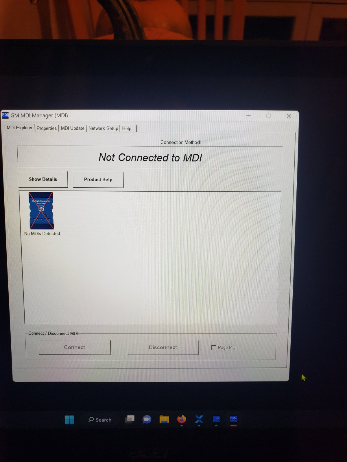

I'm having a difficult time setting up the nano to work with tech2win. After several attempts of installing software im stuck with the tech2win app not recognizing the nano. When i plug the nano via usb , vx manager and Gm vci recognize it as plugged in. Gm mdi and tech2win wont. I don't know what else i can do.

the vcx nano software has to be running first and then left running while you open gds2 or tech2win

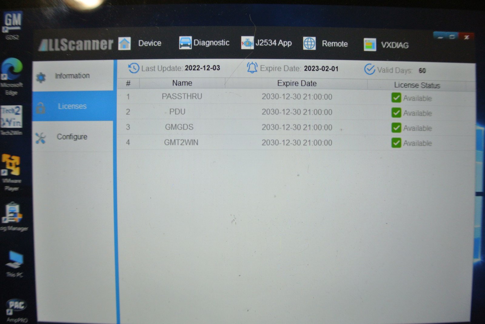

try these, i checked both work, the vcx link will come up chinese but just change it to english, right click on the download link and select "save link as"
allscanner vcx
TECH2WIN
