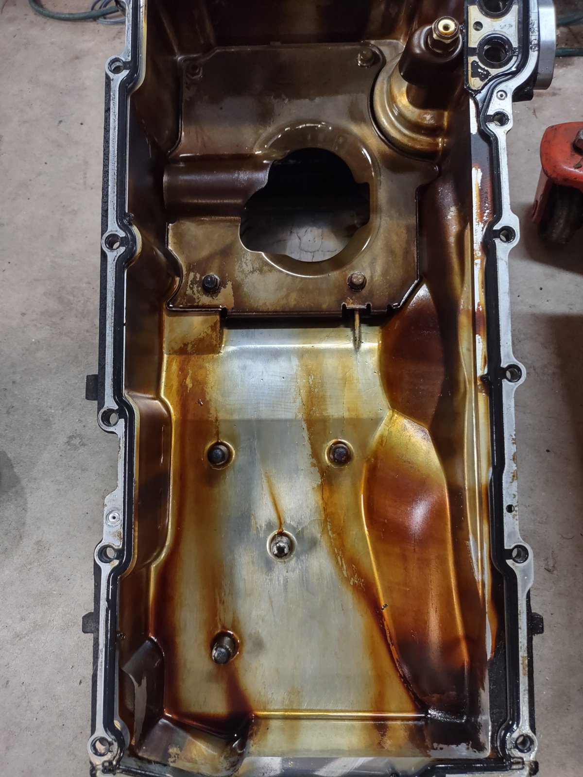

And here's what the oil pan looked like when we dropped it. Keep in mind this engine only had two oil changes with the Valvoline..... You can clearly see it was even working on cleaning the pan in the area where a lot of oil flowed down from the front. The very bottom of the sump was very clean aluminum, no sludge. Never seen that even on an LS with 90,000 miles.

Do you think the loosened sludge could gum up other internal areas? Like oil passages, push rods oil pump, oil pump pick up screen etc? Also what was the oil change intervals? I change mine every 2500-3000 miles. I do that on all of my vehicles.

Oil change interval was between 4 and 5000 miles for the life of the vehicle. The the pickup screen was clean, as was the screen under the oil pressure sending unit. Haven't pulled off the oil pump yet, but I want to look in the relief valve to see if there's anything there. But so far it seems to have pretty much dissolved any deposits, instead of just breaking them loose. Timing cover and oil pump, etc coming off tomorrow with pictures.

while I've seen that nice orangeish red in just about everything engine I've ever seen inside of with any good amount of miles/hours on it. I used to consider that a happy well maintained engine and was happy to see it vs any build up or black gunk. I considered them totally different things.
but I can't argue that it's nice to see it clean that up even if I don't really see it as something leading to an issue. not seeing much down side to running this oil over anything else right now.

Am I missing something here? Where's your 'before' picture?

I doubt he pulled the pan for a before. but just seeing the middle clean and outside normal looking vransh says a lot.

'Too far before' would be a brand new engine, of course.
To steelman the argument, the LONG-TERM goal is an engine that looks brand new.
Keep using it. That's what I'm gonna do.

No before picture needed if you've ever cracked open an LS engine. Normally well before 100,000 miles it has that nice gold hue to it. Nothing wrong with that, pretty normal. And if there's been any lapse in oil changes, especially if not using synthetic, it's pretty common to find some sludge the very bottom of the oil pan. Sometimes baked on really hard. For the mileage on this motor, it actually looks really good inside. The evidence for the Valvoline is the areas that are too clean.... You would never see those even on a well-running engine as this was. The heads were also quite clean, while the push rods themselves didn't appear to benefit from the Valvoline. The lower half of the push rods definitely had some carbon build up on them. No extremely clean areas on them. Nothing remarkable about the lifters. They basically looked like they should. The inside of the timing cover tomorrow should have something to say, with a chain slinging the oil around the inside of the cover.

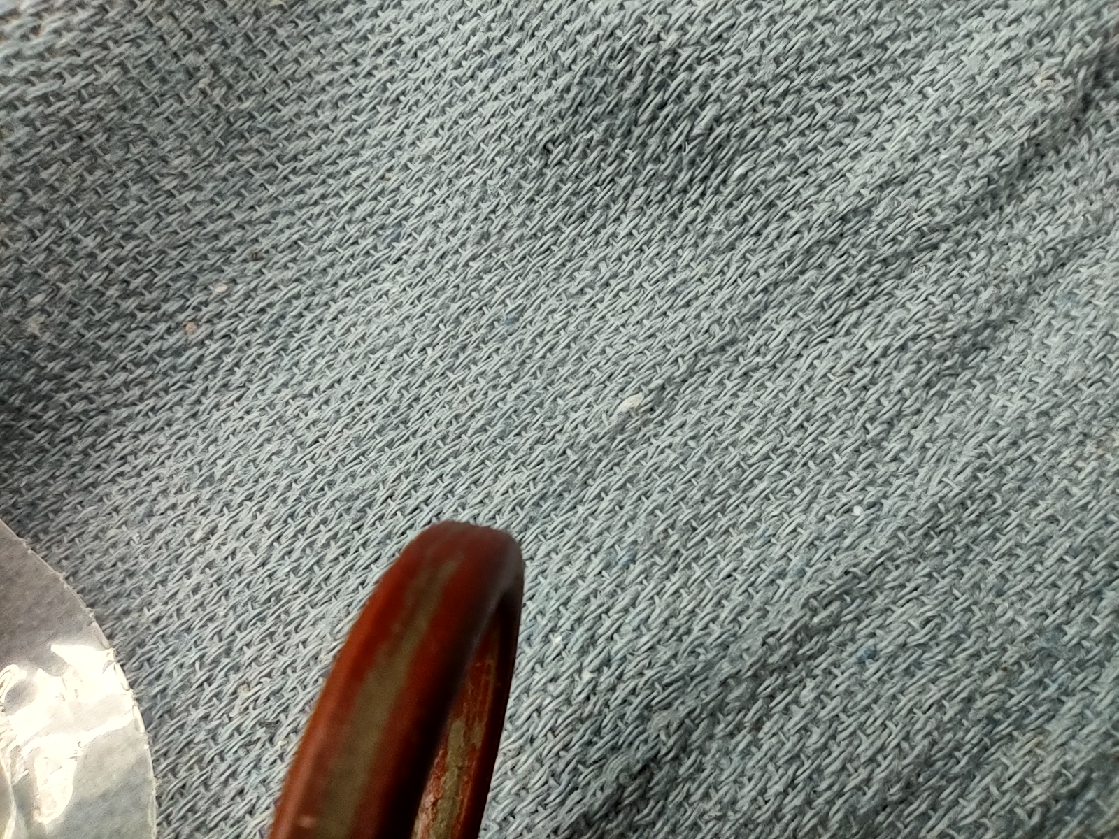

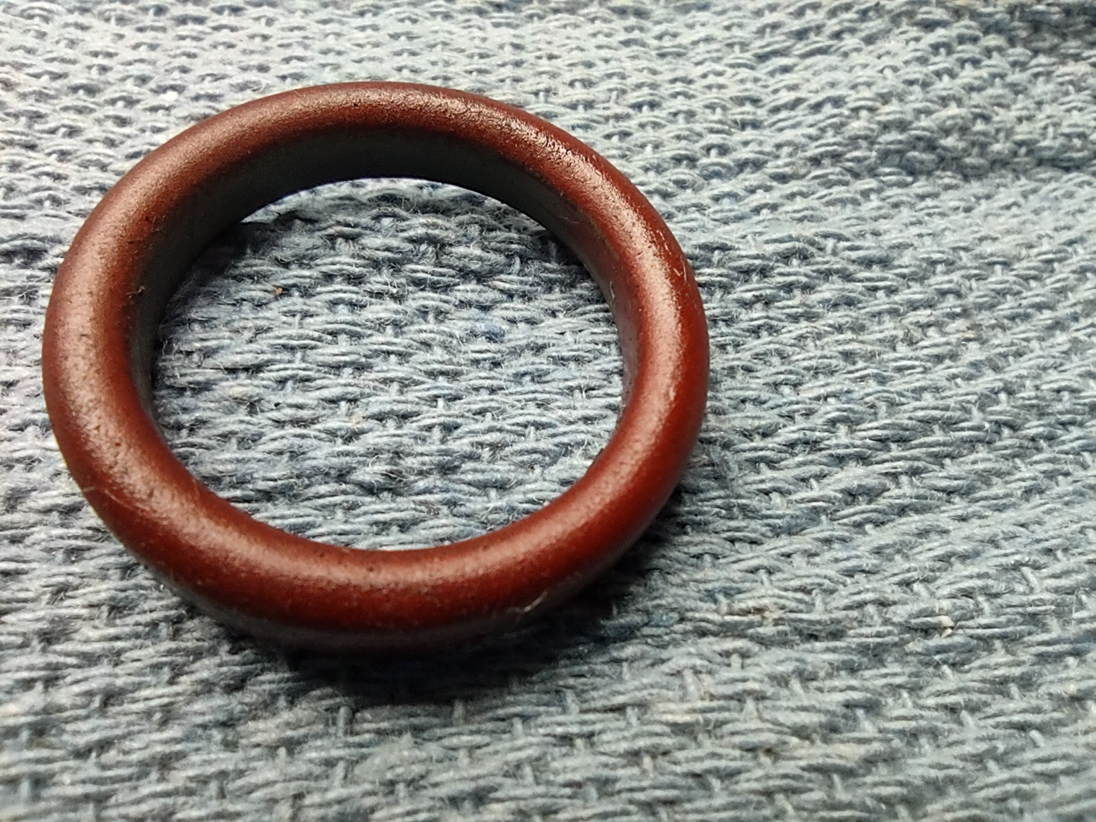

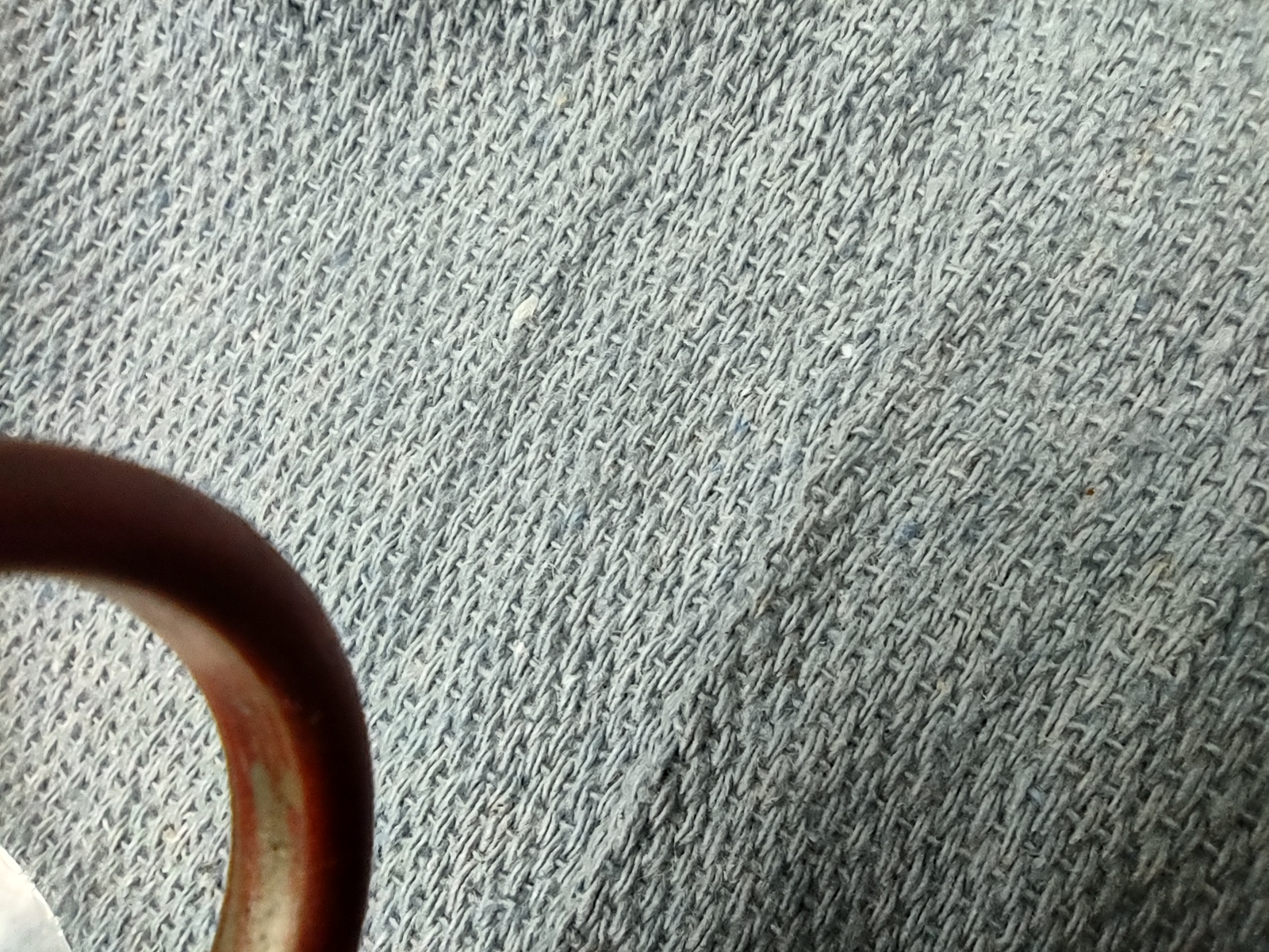

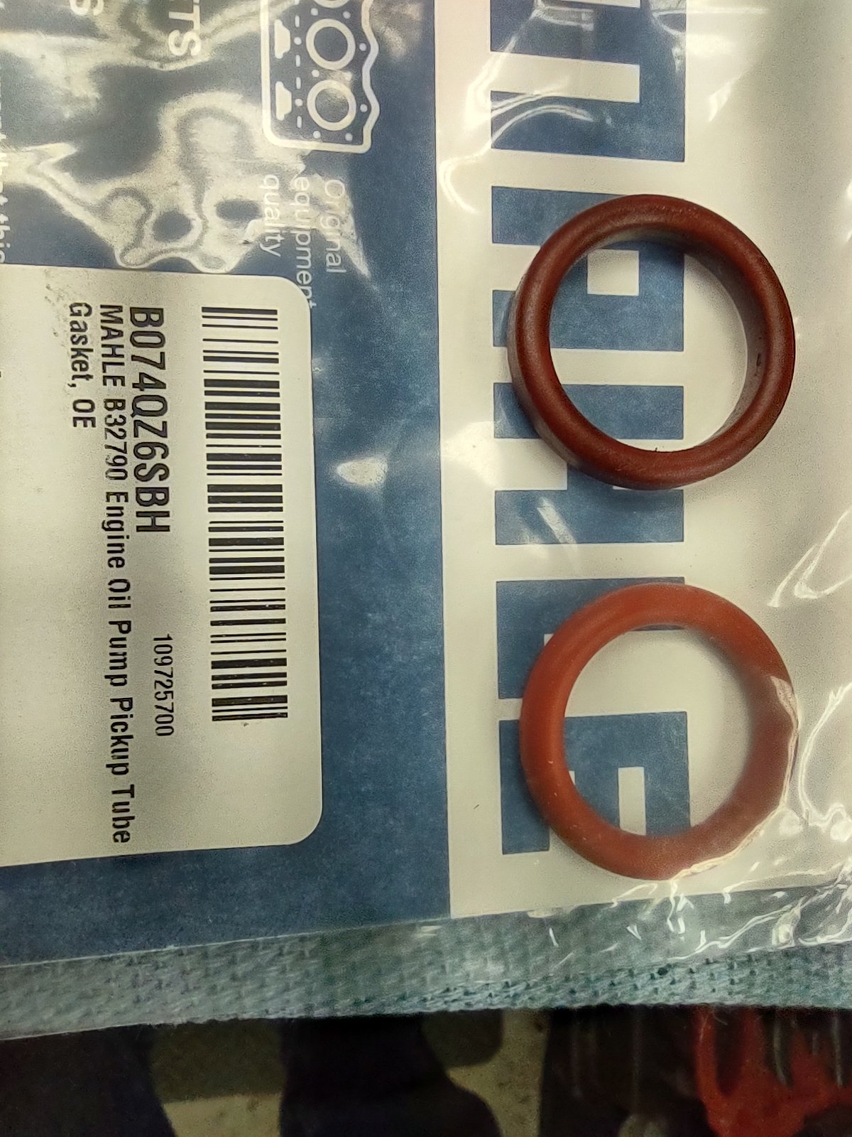

By the way, that clean streak from the front of the oil pan? Really made me wonder about the oil pressure relief valve on the oil pump, and how much oil it dumps out. The o-ring on the pickup tube was pretty well squared out. Pick up to freely dropped out of the pump..... With the o-ring staying put up in the pump. Here's a couple different angles of that o-ring, along with a comparison of the new OEM one will be installing.

So oil pressure was still good? Or a little low?

He was running between 15 and 20 psi hot oil pressure at idle coming off a freeway run. Said it was running 31 PSI at 70 mph. So I'd call that on the low side. (Although GM might disagree) As part of his AFM delete, will be plugging the oil pressure relief valve in the pan and going with a Melling 10296 with the +10 PSI spring installed. He's keeping VVT, so we have a GM OEM L92 camshaft ready to go in. We already plugged the oil towers with steel plugs, and he bought a flat valley cover. He turned off his AFM with a Diablo tuner about a year ago, so we're just doing the hardware change. The condition of the cam bearings will determine if we end up pulling the motor. (Which is really easy to do with the heads off. Those top bell housing bolts are like right there.) His LS7 lifters with the gold clips arrived last week..... We're holding off on pushrods till we get some measurements after bolting the head down.
