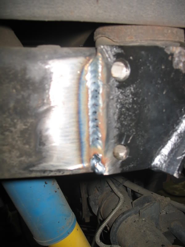

this is pretty much a c notch i had to do on my blazer... cut bumpstops off then cut frame and weld a notch that was for it in.. i lost the picture of it all in there. ill try to get one side shot of total thing in.
