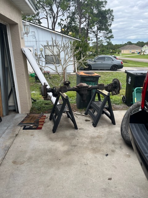

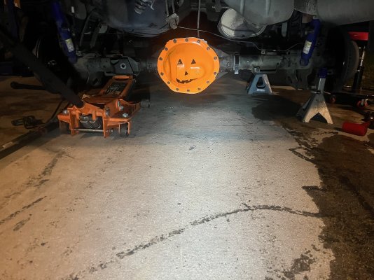

The 14-Bolt, 9.5" Axle project is nearly complete. We are into the break-in period now.
I purchased a used complete IFS with 3.73 gears and my helper installed it with new mounts and GM CV Axles of the latest design intended to keep more dust out of the rear of the knuckle/hub. He also replaced proactively the other Timken hub with a GM OE unit and new bolts. In the interest of time and because none of them were bad, we kept the universal joints. So far it's working flawlessly even in 4LO and even the original actuator it came with.
We put new parking brake shoes and axle shafts onto and into the 14-bolt rear axle and new anchor blocks for the parking brake cables and new rear brakes. Speaking of which they lasted 84.899 miles with about an 1/8 inch of material left. I could have left the rotors but changed them for new. The axle has run flawlessly with no noise so far.
Sometime after the next refueling we'll pull the cover and inspect the inside and refill it with fresh fluid and drain and fill the front and inspect the magnet.
I'm delighted beyond words that this long project is over. Now I can get the garage cleaned up and better organized and get to the long list of wood-working projects that have been put on hold for years because of these axles and parts taking up my work space. Thank you to my helper and most of all to the Lord!
I had wanted to document this with photos but could never remember to, sorry fellas. This is all I have:

Love the prototypical "pumpkin!"
