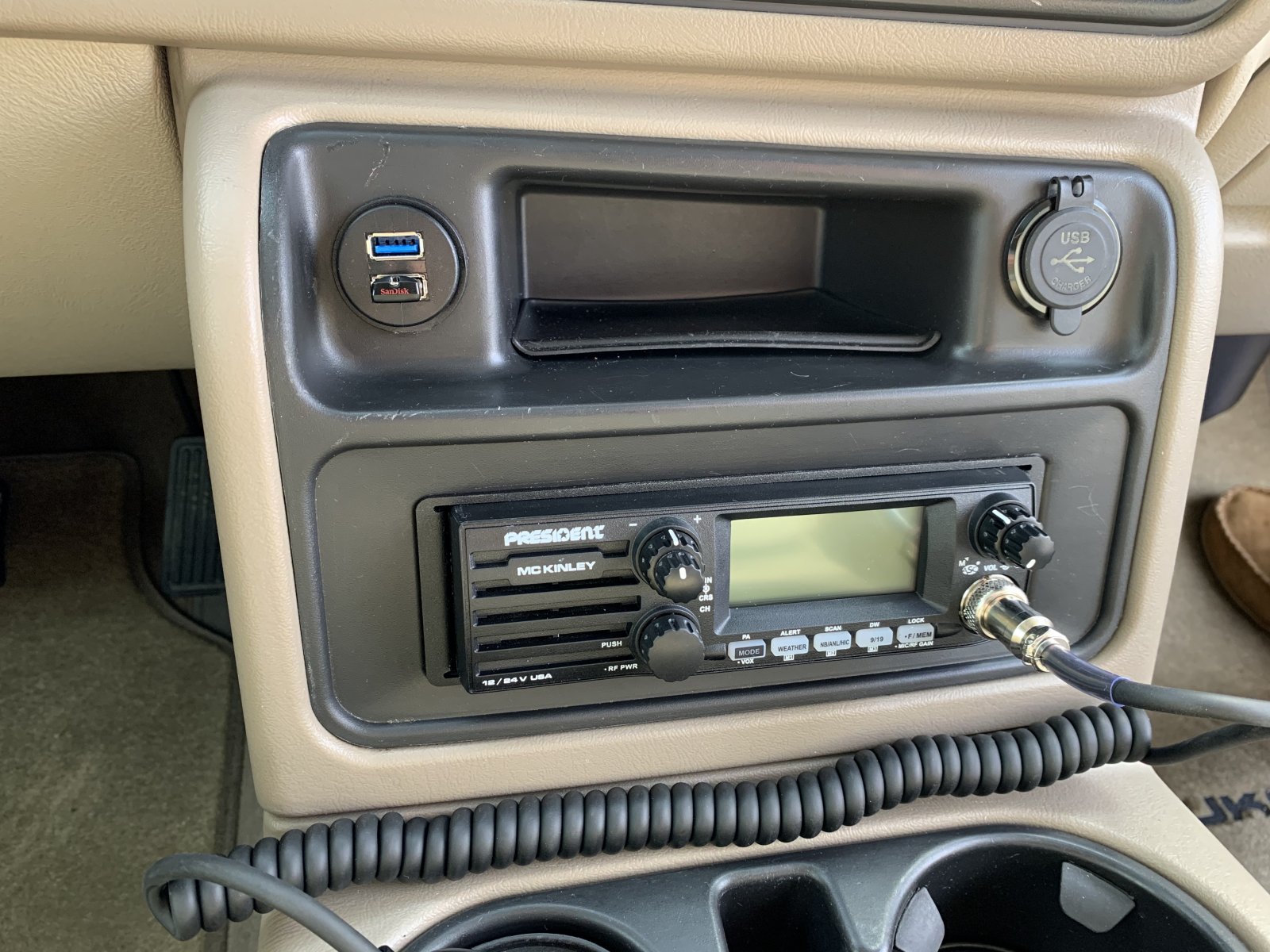

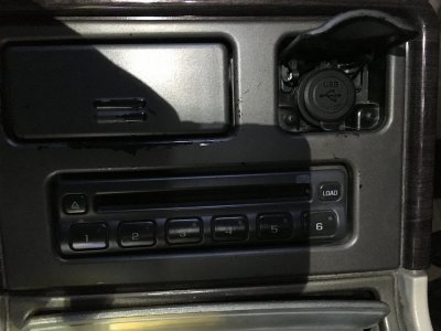

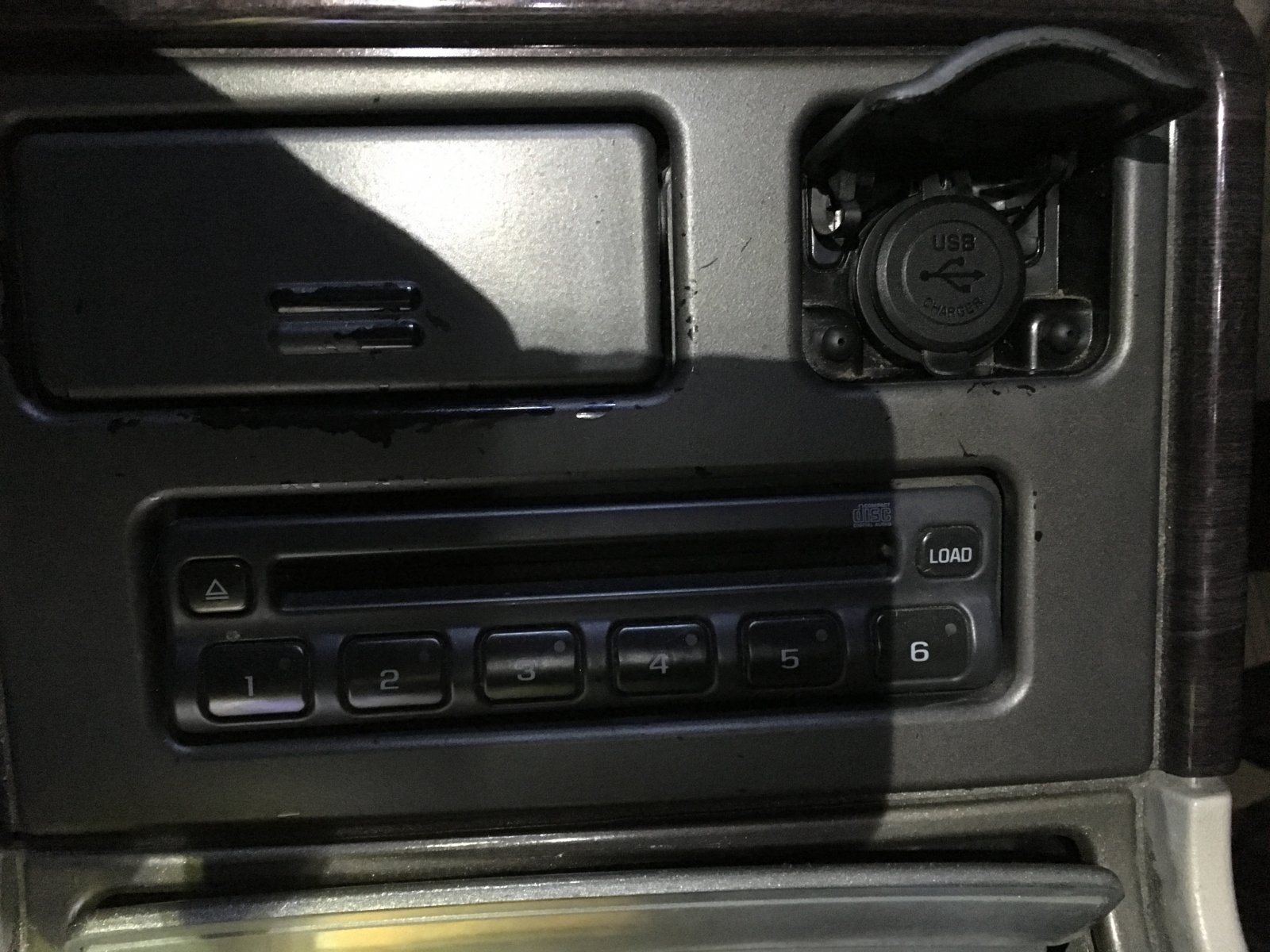

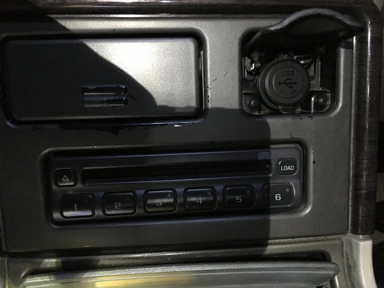

Here’s what I have:
It replaces the cigarette lighter piece entirely. 765728A2-009D-4C20-BBB5-FC18A6450D03.jpeg
Super easy install. Clip the factory pigtail off the back of the cigarette lighter, and splice in the two wires from the USB port, and it’s ready to roll with power. Only thing I had to do was widen out the plastic bezel that the cigarette lighter fits into in the dash bezel. The USB port I bought was just slightly larger in diameter than the cigarette lighter. But an extra few minutes with a file took care of that.

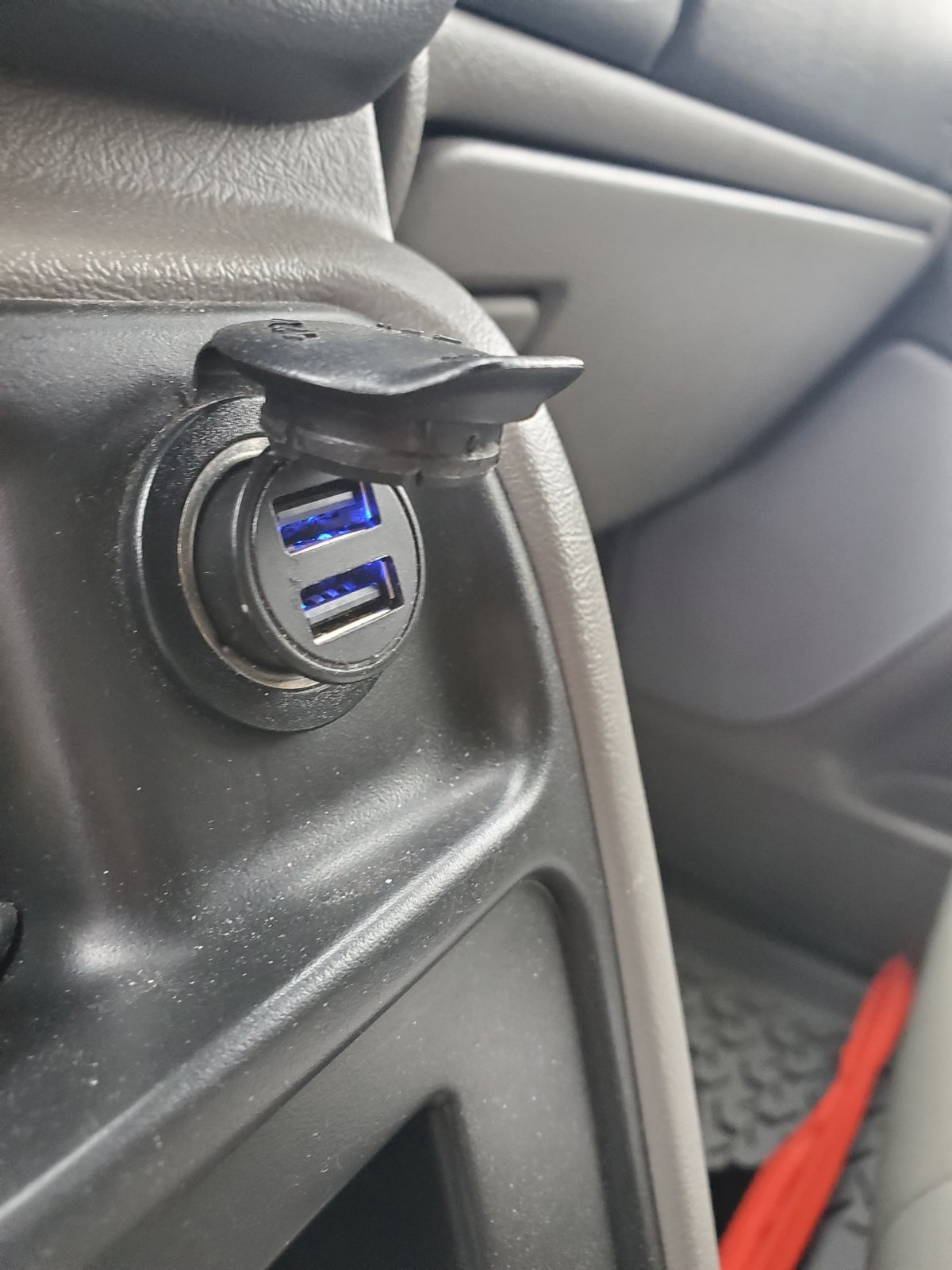

I put the exact one you showed in mine, and I love it, it gives me 'turbo power' on my phone and no other outlet has, I have had 3 in my Yukon now... the only complaint is, the blue light on the voltmeter is too bright.

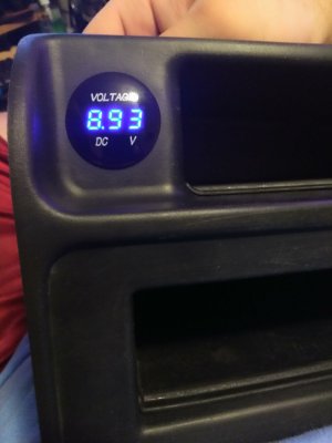

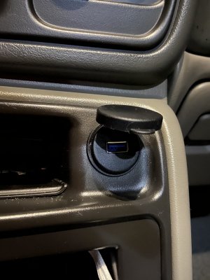

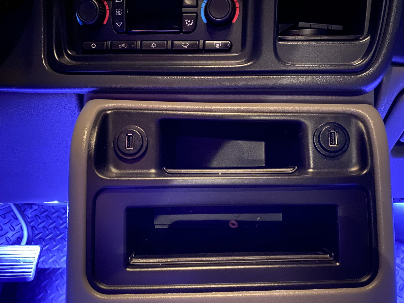

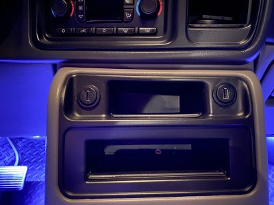

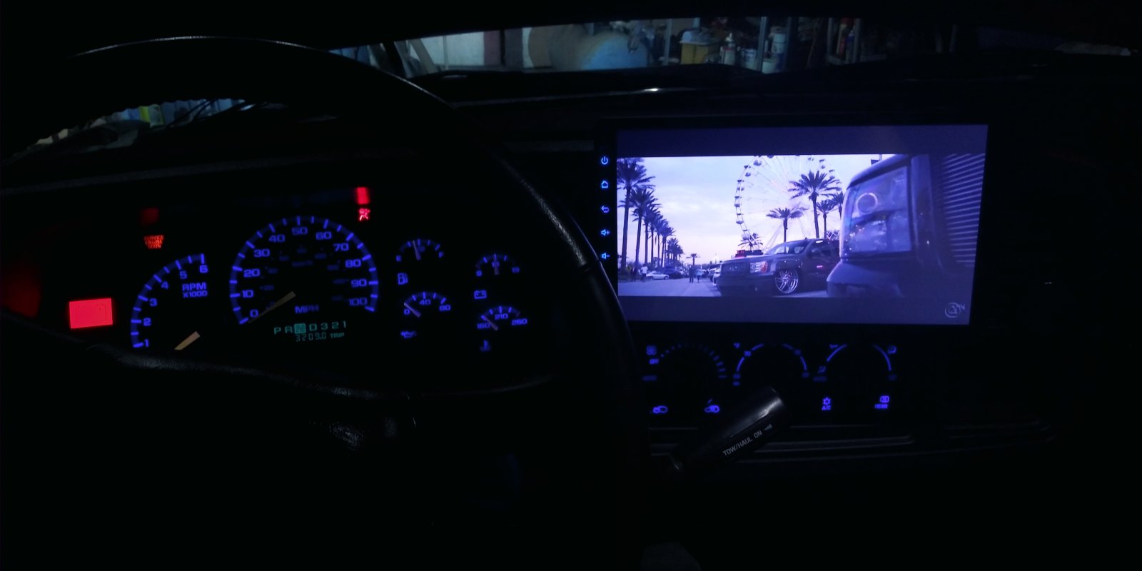

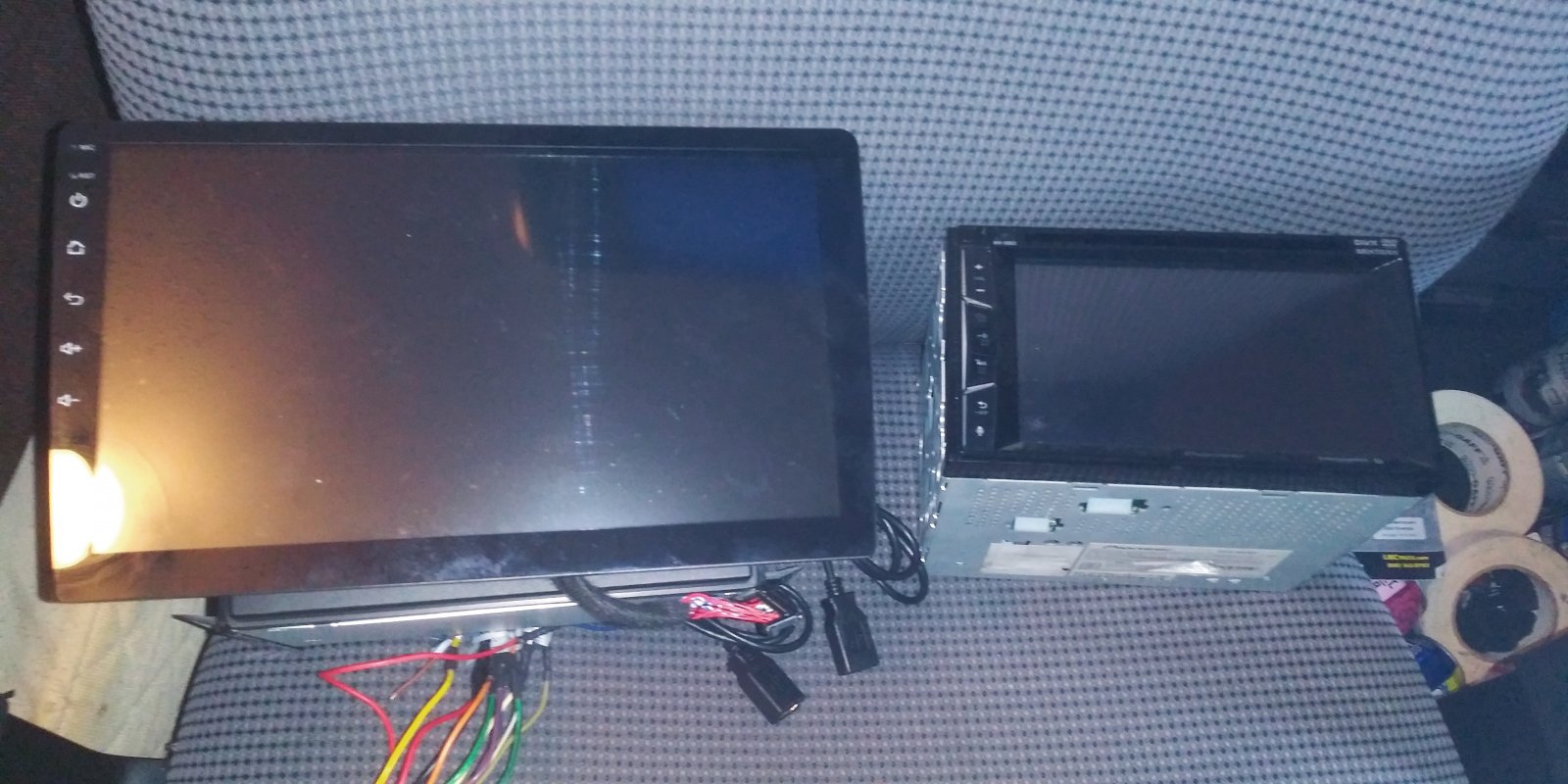

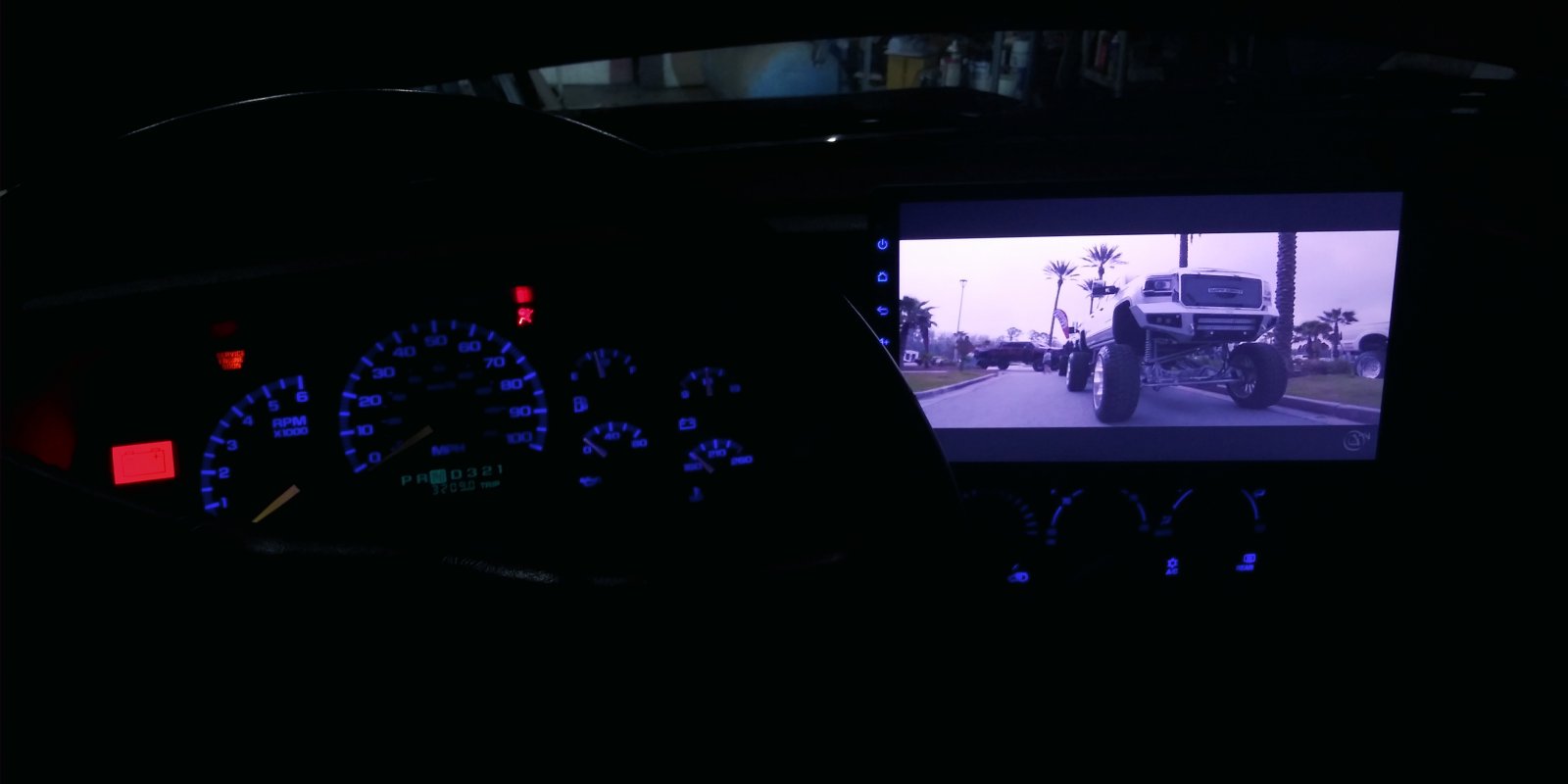

I replaced my cigarette lighters all with USB charging front and back plus added a voltage gauge. They are all hard-wired in as far as radio integration I have a portable hard drive in my glove box and I put the USB running into the back of the radio with music and movies. This way I could take it out and add more anytime I want to. Don't mind the voltage gauge read out I was testing with 9 volt battery lol.
20190516_015455.jpg 20190516_033943.jpg IMG_20190411_181005.jpg IMG_20190411_180840.jpg 20190516_034009.jpg
