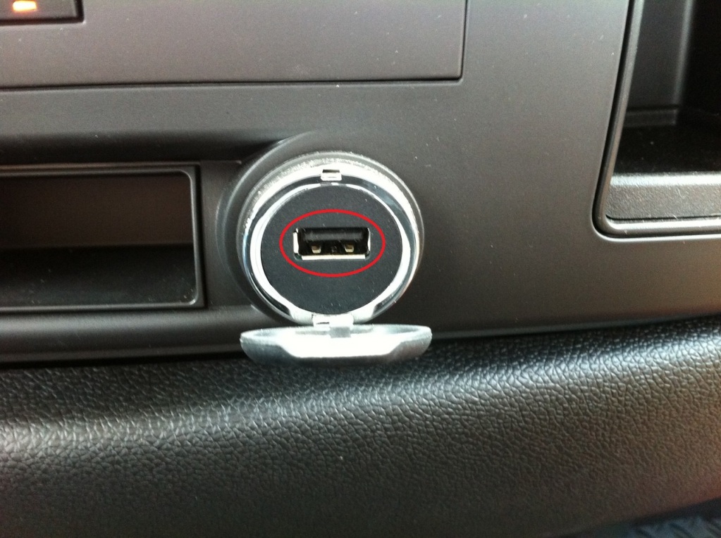

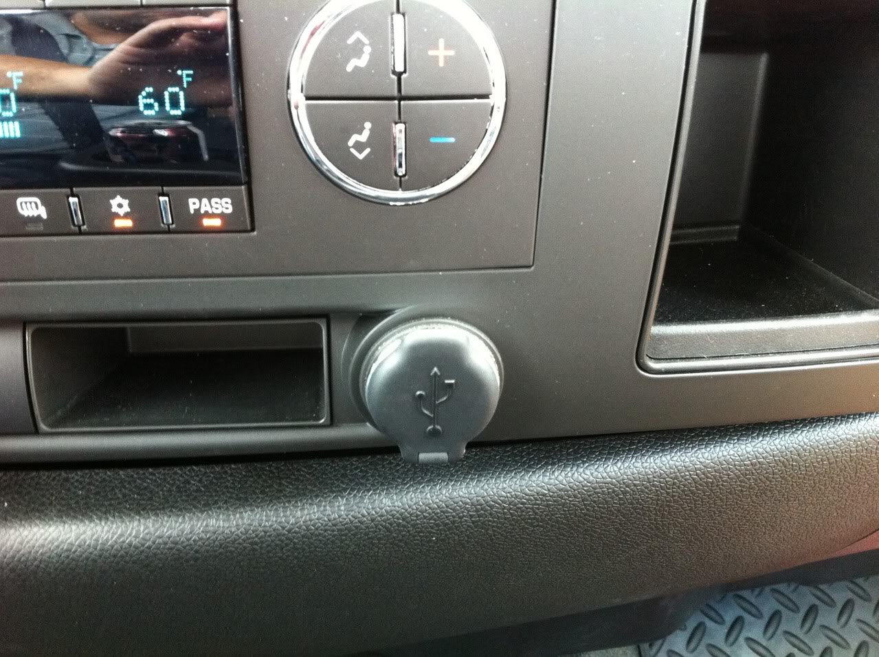

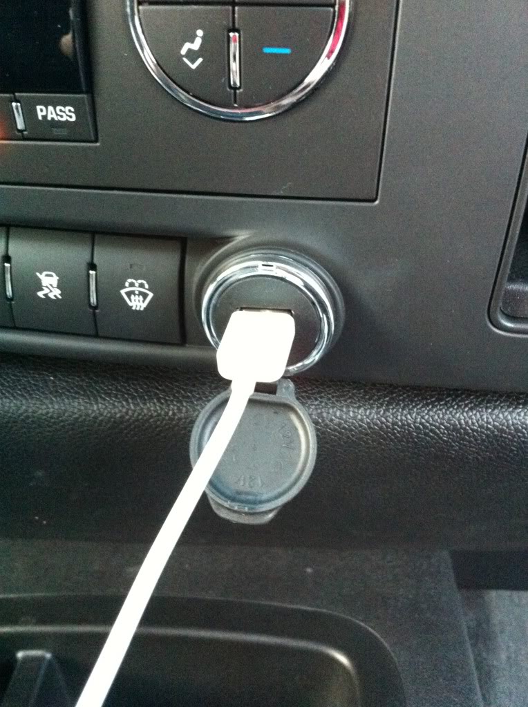

The other day I noticed that the second cigarette lighter port in a Sierra was actually the USB port. Has anyone tried converting one of the front two lighter slots to the USB port instead?

I don't know your goal, but that USB port hooks to the radio and if you hook an iPhone to it, you can play the music on your iPhone through the radio and control the selections with the steering wheel radio controls.

Can anyone get me a pic of the back of it or tell me if it is just a regular USB plug (I would assume female plug)
messy
Banned
Jun 19, 2012
59
GM P/N 20888040 USB Port Cover
GM P/N 20944422 USB Port
GM P/N 20944418 USB Port Custom F/CMPT FLR CNSL (D07)
P/N 20944418
P/N 20944422
