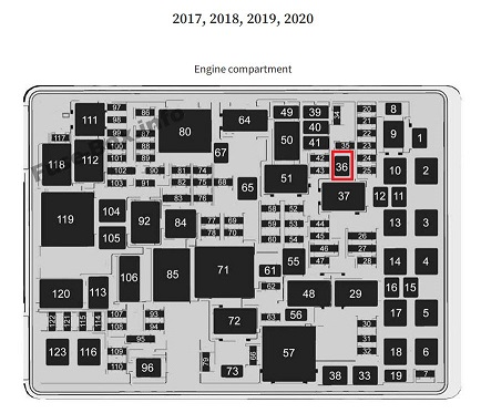

I'm a ham radio operator. My previous 2013 Yukon Denali had an "upfitter port" in the driver side under dash electrical box that had a battery connection for 12 volt equipment that I used to power my radios without having to breach the firewall. My 2020 Yukon doesn't seem to have such, but I have a harness that I am told is for a trailer brake controller that also supplies 12v. Does any body know the current rating for that connection, and where it is fused? Thanks much.

From what I see it's the #36 J-case fuse in the underhood fusebox. Usually the trailer brake circuit is a 30-amp circuit, always powered. Might see if there is already a fuse in that socket.
The pigtail for trailer brakes should have four wires; two are heavy wires and the red one should be on that circuit. The blue one will tie back to the 7-blade connector at the hitch.
