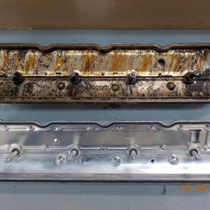

Your Denali doesn't have a pvc valve. The pcv system is built into the driver side valve cover. The original valve cover sucks engine oil out thru the valve cover into the intake manifold and into the combustion chambers where it is burnt. Result at best is oil consumption. Worst yet (like my 07 Denali) would be stuck rings which causes even worse oil consumption.
The GM updated valve cover pt# 12570427.

donjetman
Oct 22, 2018
1,987
3,642
