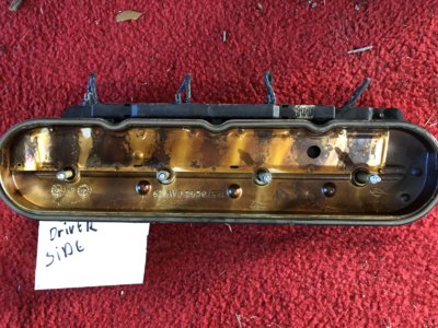

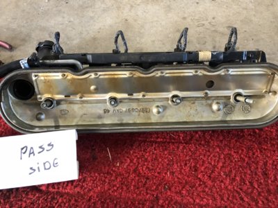

Here are some current photos of my stock valve covers.
2007 retired police Tahoe 5.3lt
For some reason the passenger side is really clean looking but not so much on the driver side.
