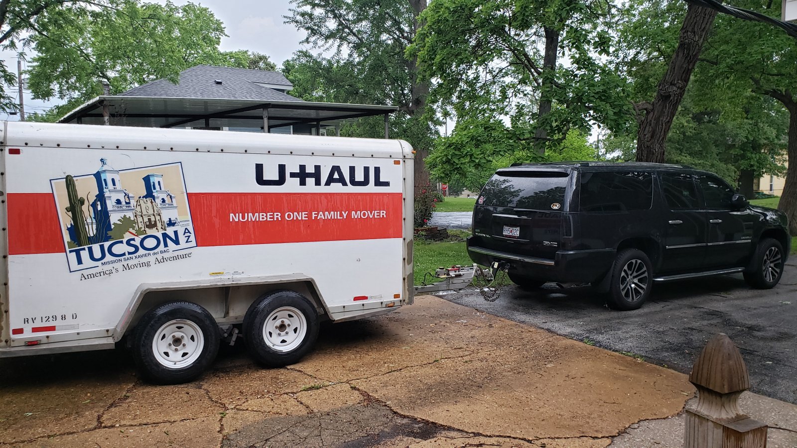

The travel was a success. I never reported back however there were no issues along the 1,200 mile journey. Averaged about 12-13 mpg. It was heavy, acceleration was lacking, however once cruising I experienced no issues to report, no bouncing, sway, etcetera. Braking was also acceptable. I'm late to reply as I returned the trailer nearly 3 weeks ago.
Bigburb3500
Jun 7, 2024
854
1,340
You must have had that trailer loaded with stuff to squat the back of your Yukon! Glad your trip was safe!
It was completely full, front to rear, top to bottom. I eagerly unloaded it and forgot to take a picture of how full it was. Also, the Yukon was also loaded as well, contributing to the squat.
