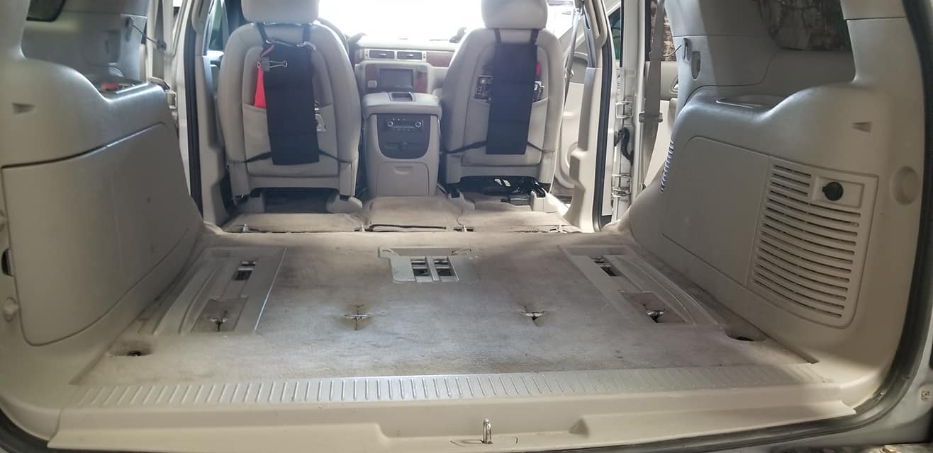

I decided to remove the 2nd and 3rd row seats for more efficient storage and a more usable area for over-landing. For today I only have photos of what it looks like with the seats out and I will add more photos and information after I design and start building this out.
I seldom have passengers in the back and if I really need it we can drive my wife's car.

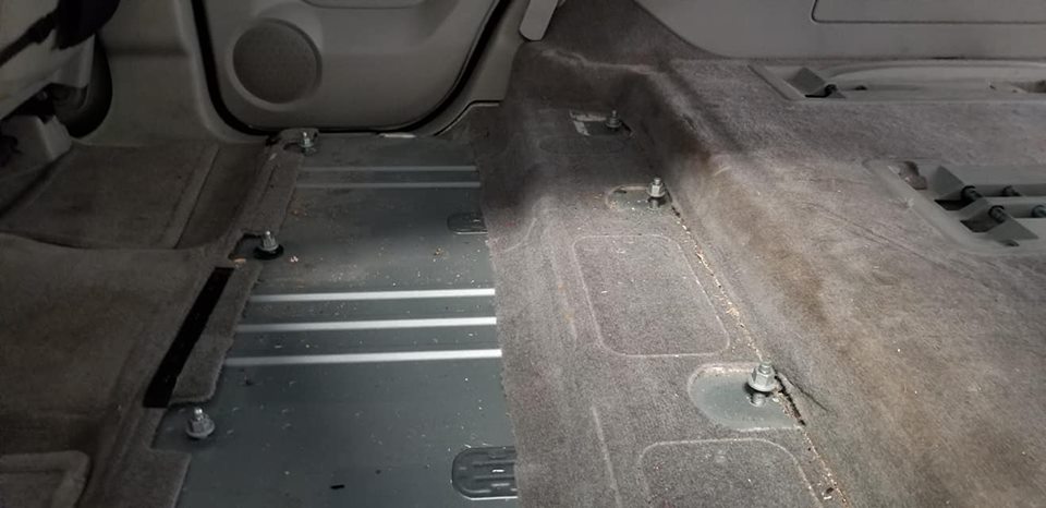

Sooo. I decided to remove the second row seats for more storage room. I put a level in the back area to see how deep the area is compared to the back. It is roughly 6.5 inches at the deepest point and 4 feet wide and 36 inches front to back.
I am thinking of installing a heavy lockable storage unit here that will be bolted down on it's inside with the existing seat bolts. This storage area would be 6.5 inches or as deep as 12 inches allowing for a lot of storage space. It will be carpeted to blend in with the original carpet.
The rear section is 4x4 feet.

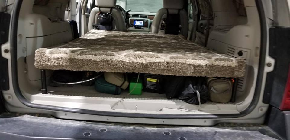

I can configure this several ways in this photo there is no second row seat.
Under storage area give a lot of room for essential items.

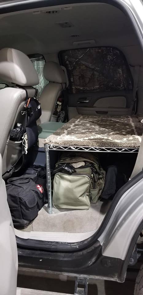

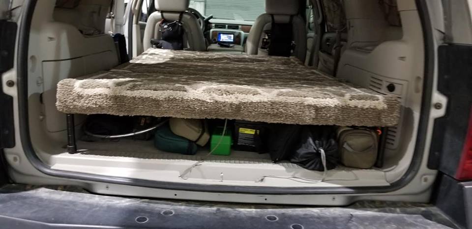

I have added ton of stuff to this build... lol I will just post up some of the photos here. If you have questions feel free to ask. This is is a steel shelf I made it fits a full size 5 inch memory mattress on top.

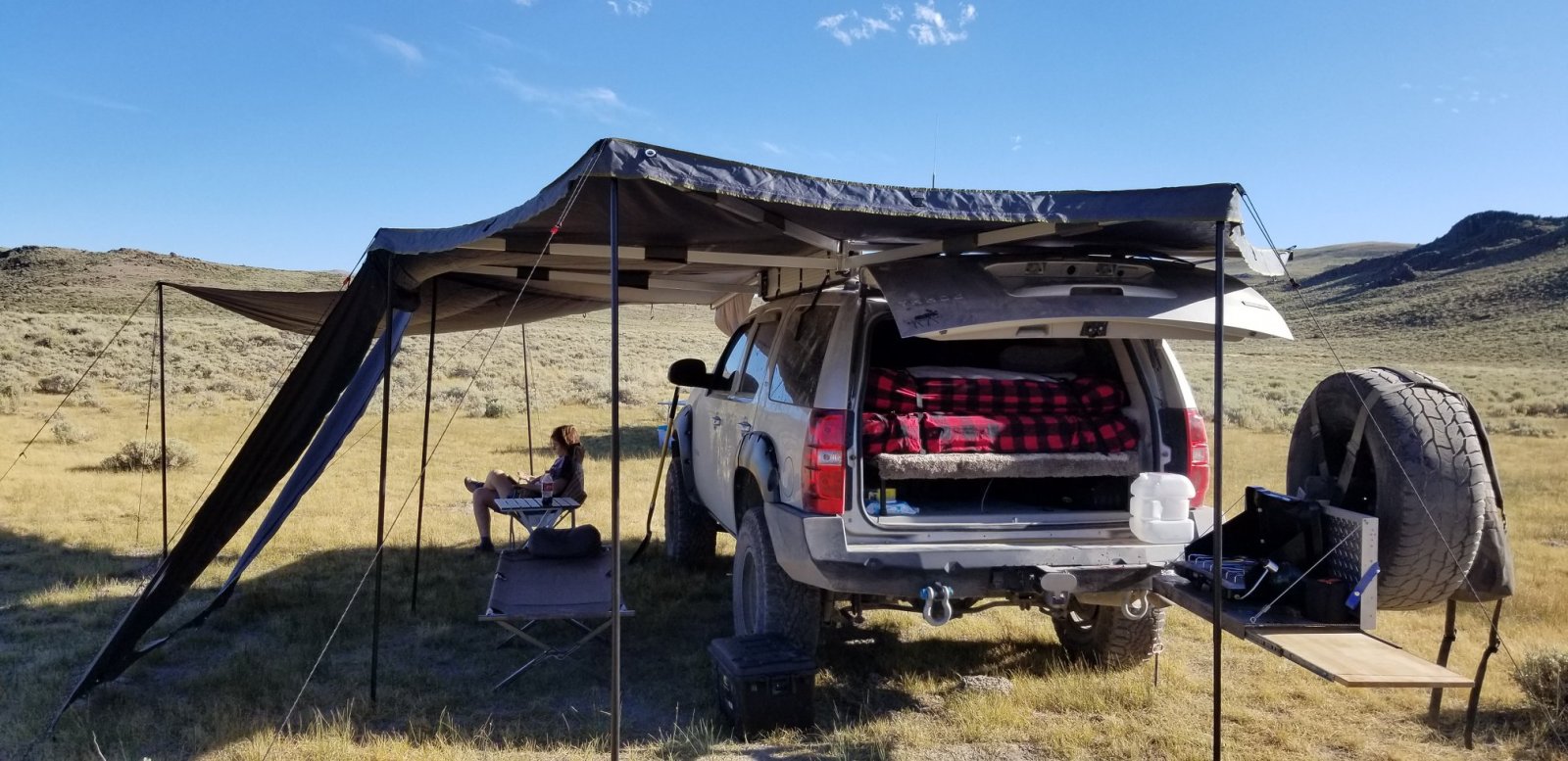

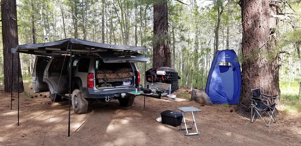

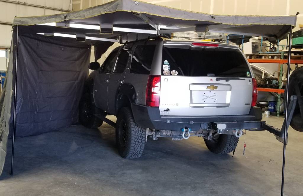

This is my 270 degree awning great for off road adventures or anytime you want your own shade.
Camping out in the wilderness we traveled about 80 miles off road to get here.

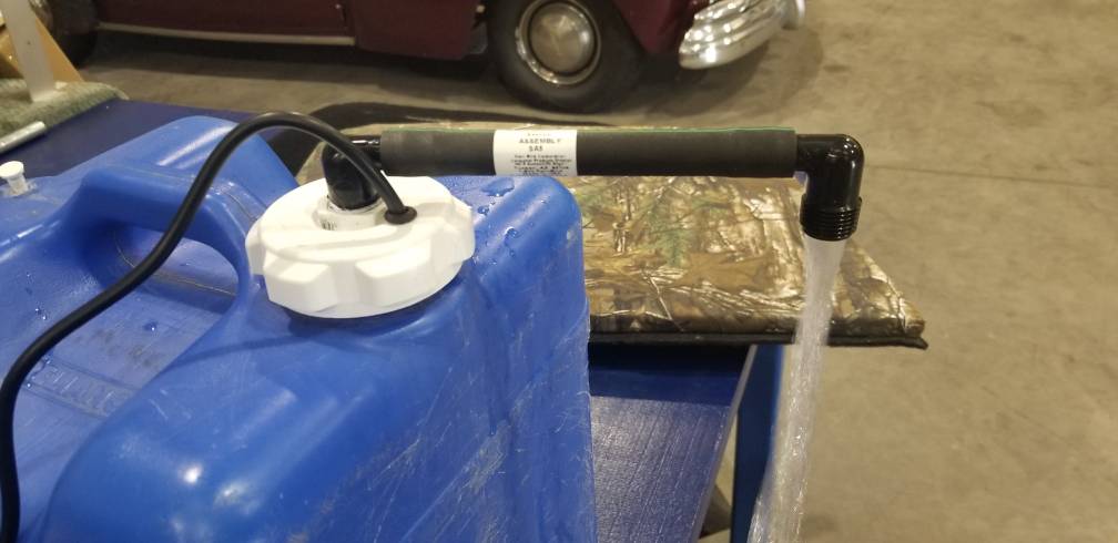

Of course running water...

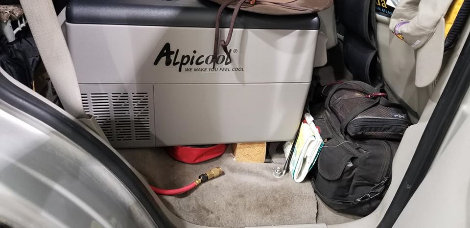

Of course you have to have a refrigerator this one goes from -4 degrees to 60 degrees I keep my medical trauma bag right in front of it.

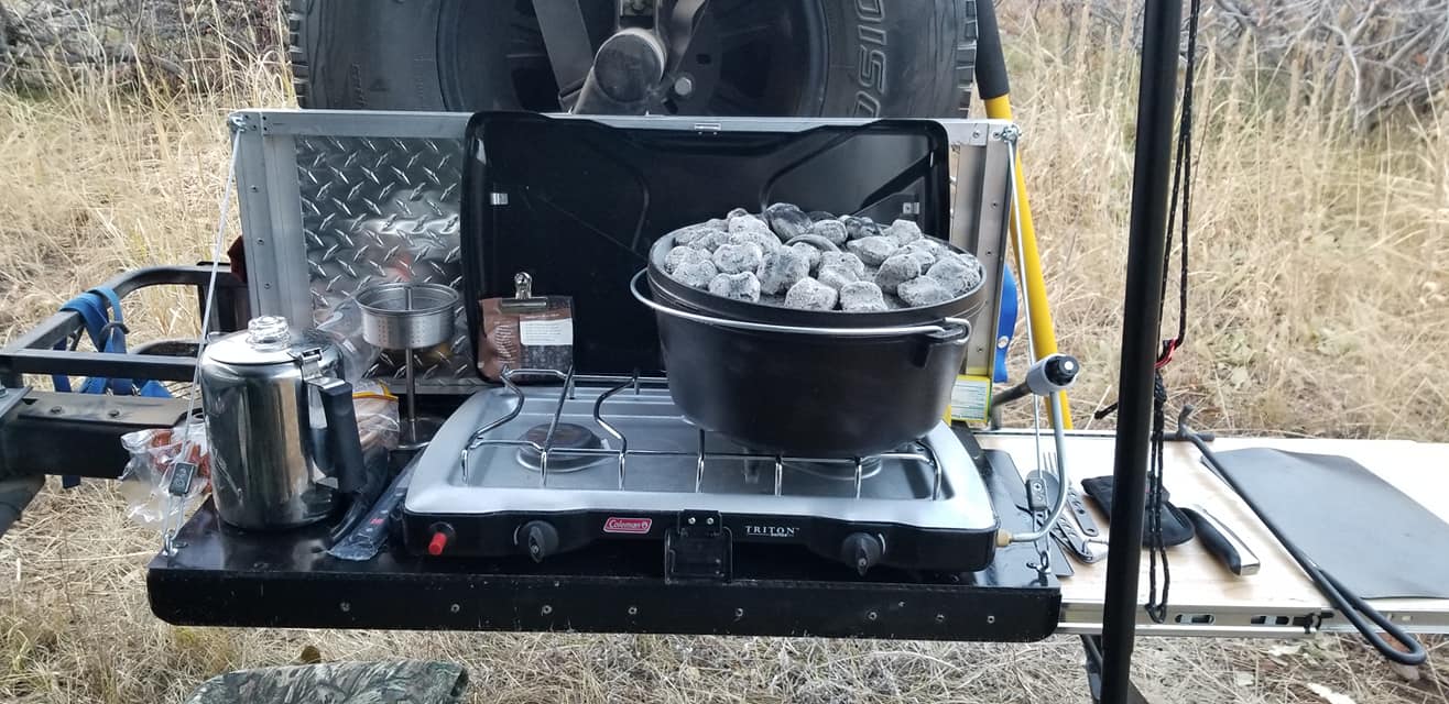

I built this fold up slide out table for cooking outdoors there is also a table that mounts to the left side and the running water posted above fits in the rack to the left... No water tank outside on this trip because the highs were 30 and lows only 8 degrees even the dutch oven needed gas to heat it up... lol

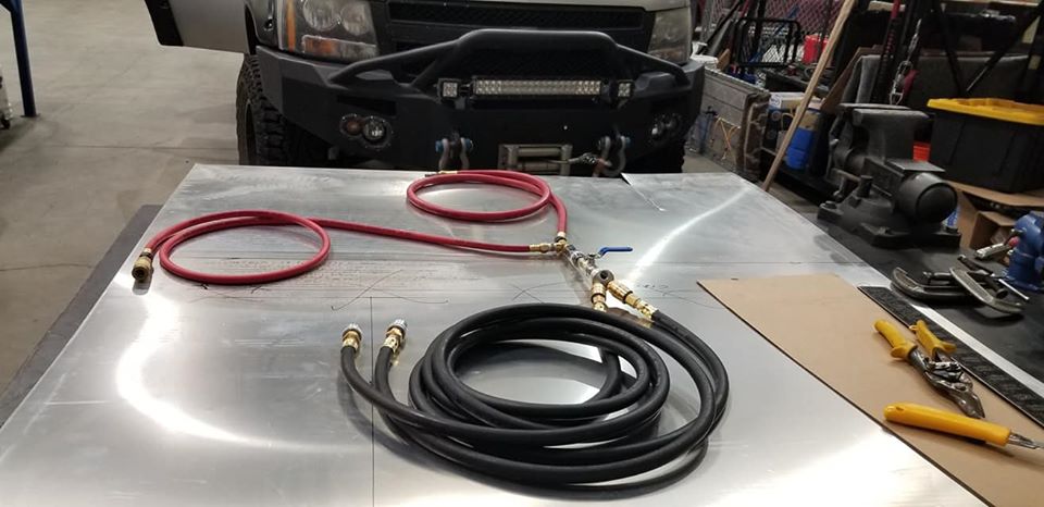

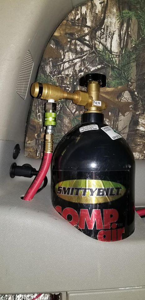

On board air tank it can air up all four tires in less than 5 minutes.
Air lines the red ones are installed under the carpet.

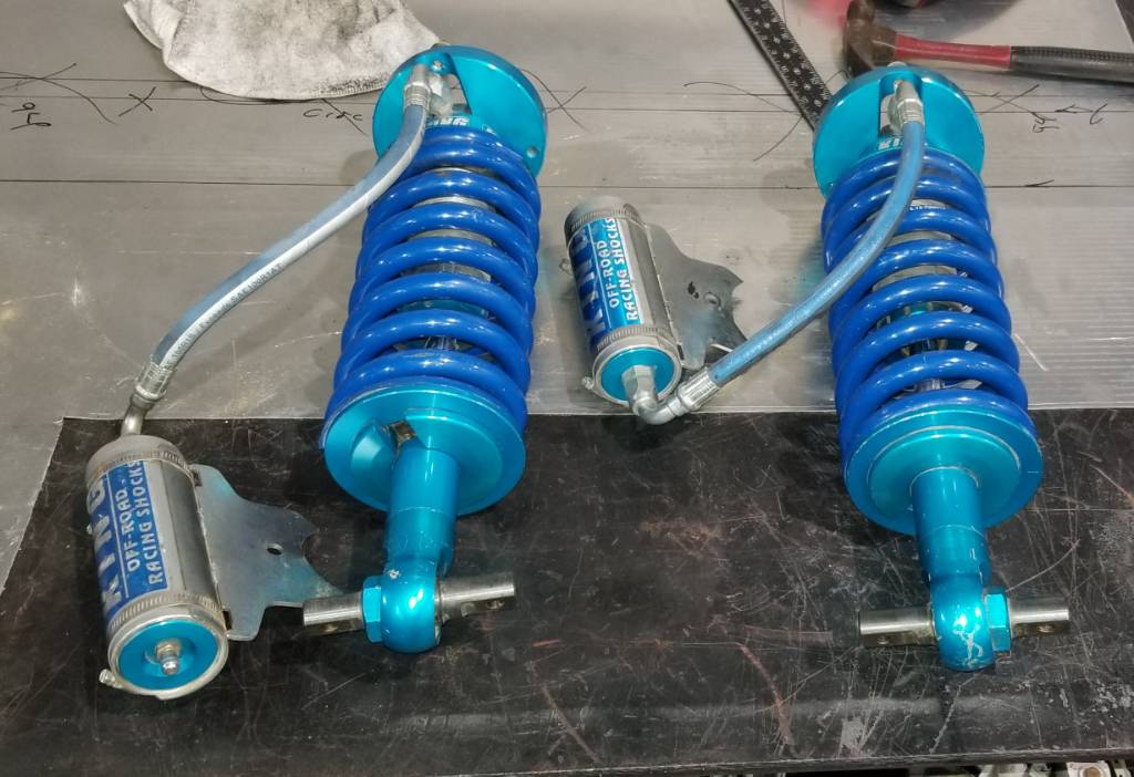

Those Kings are crazy. How much lift will they provide or is it going to be stock height just better performing set up?

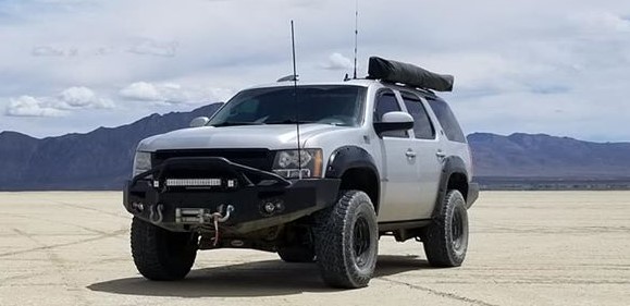

Thank you, I run a 4 inch lift now and most likely will pick up another inch for a total of 5 inches front and rear. The kings will enable more wheel travel most likely up to 8 inches or more depending on how much the axles will take... They should preform better although I have no complaints about the RC 7000's on there now. The rear for now will most likely stay the same

I have a Ranch 4 inch lift with over two inches of sag up front I plan to use the King shock to raise in up another inch in the front to total out 5 inches.
On the rear with the lift kit I have the rear wheel is re-centered with the Rancho lift kit and I am looking at putting King shocks and a little more spring back there to get a little more height.
To answer your question when dropping it you should be able get the axle in the center by replacing the arms with something shorter.

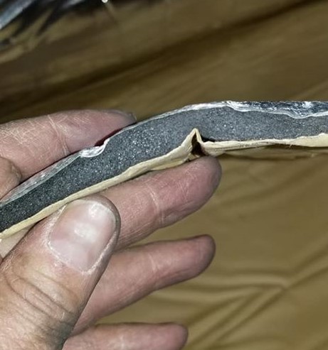

This past year I installed 13 mm of sound / thermal insulation in all the side panels, doors, rear door and also the roof it drops the inside temperature at least 20 to 30 degrees when sitting in the Arizona sun. Combined with the tinted windows driving this is like riding around in a cave. The 13mm insulation is glass reinforced on one side and adhesive on the other and sticks really good to the sheet metal.
This is the roof insulation. It is amazing how much cooler it is with the roof insulated the cross member sections are also sealed off.

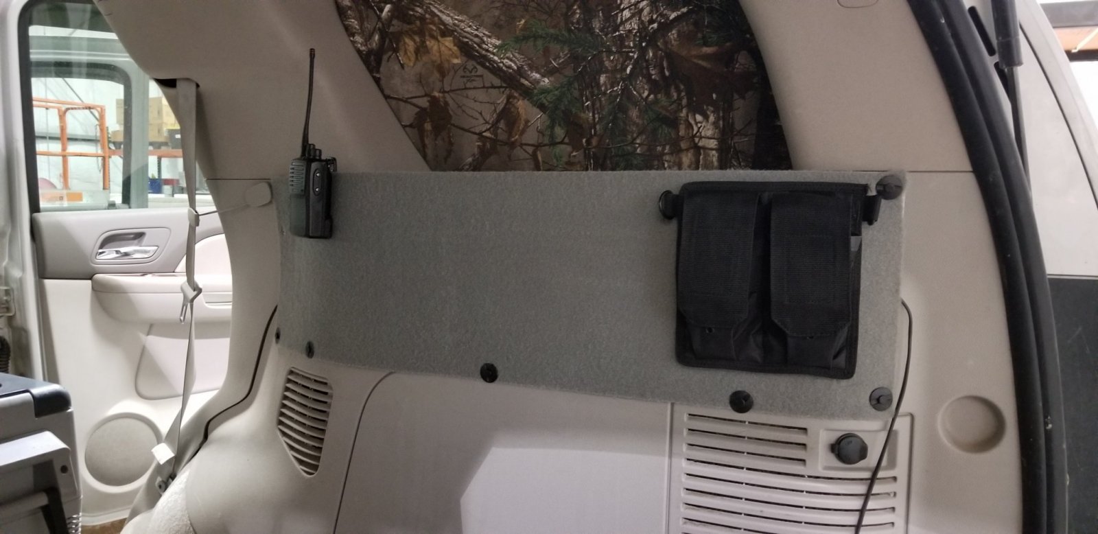

I added more storage space on both sides in the back. This is the shelf I made for the left side. It is mounted with two quick disconnect pins so it can be removed for access to the storage underneath. I made it out of 10 Gage aluminum with a carpet covering. You can also see my Co2 tank, magazine holders and Radios. Our 8 radios are encrypted so no one can listen in to our conversations.

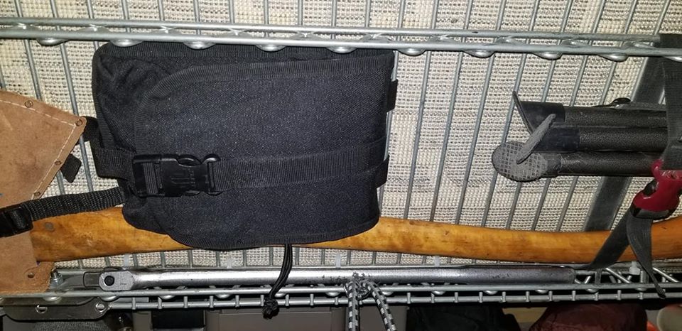

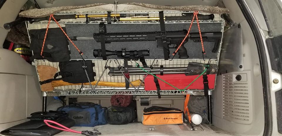

This is part of the load out I carry under the shelf I also have a weeks supply of food, water and stuff for sleeping.
We also have 7 gallons of running water.
This is the right side storage area. We normally have down jackets or other seasonal gear and / or sleeping bags.
This is what it looks like when camping. 270 degree awning full fold out kitchen and of course a blue changing washing or bath room set up outside. you can also see our bed with pillows from home in the back. It is almost glamping in this rig.
