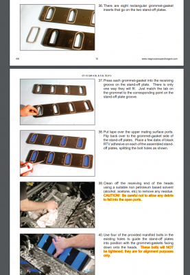

Here's some info from the magnuson instructions.
Is this already some kind of spacer plate they include to make sure the blower is up higher? If so, I could just eliminate these and put the LSA adapter plates in and order square port blower.

Reading over the instructions, looks like the kits are identical outside of the spacer plate for the 5.3 which I assume is to clear the DOD valley cover (which I don't have). Only other discrepancy I saw is the 5.3 instructions have you grinding down the alternator bracket for some reason, but not on the 6.2.
I also saw no required pinning of the crank, which I found odd.
I had to grind the alternator bracket down but that's easy. I ran up to 19psi on my 4.8 without a pinned crank. But that's pure luck and a ticking time bomb just like a G80 or 4l60.

Ok it must be because the supercharger is lifted up a bit over the 6.2. Since I am going to lift mine up anyway with the adapters, I'll plan on that step.
I will just order the 6.2 kit and buy separate spacer plates.
