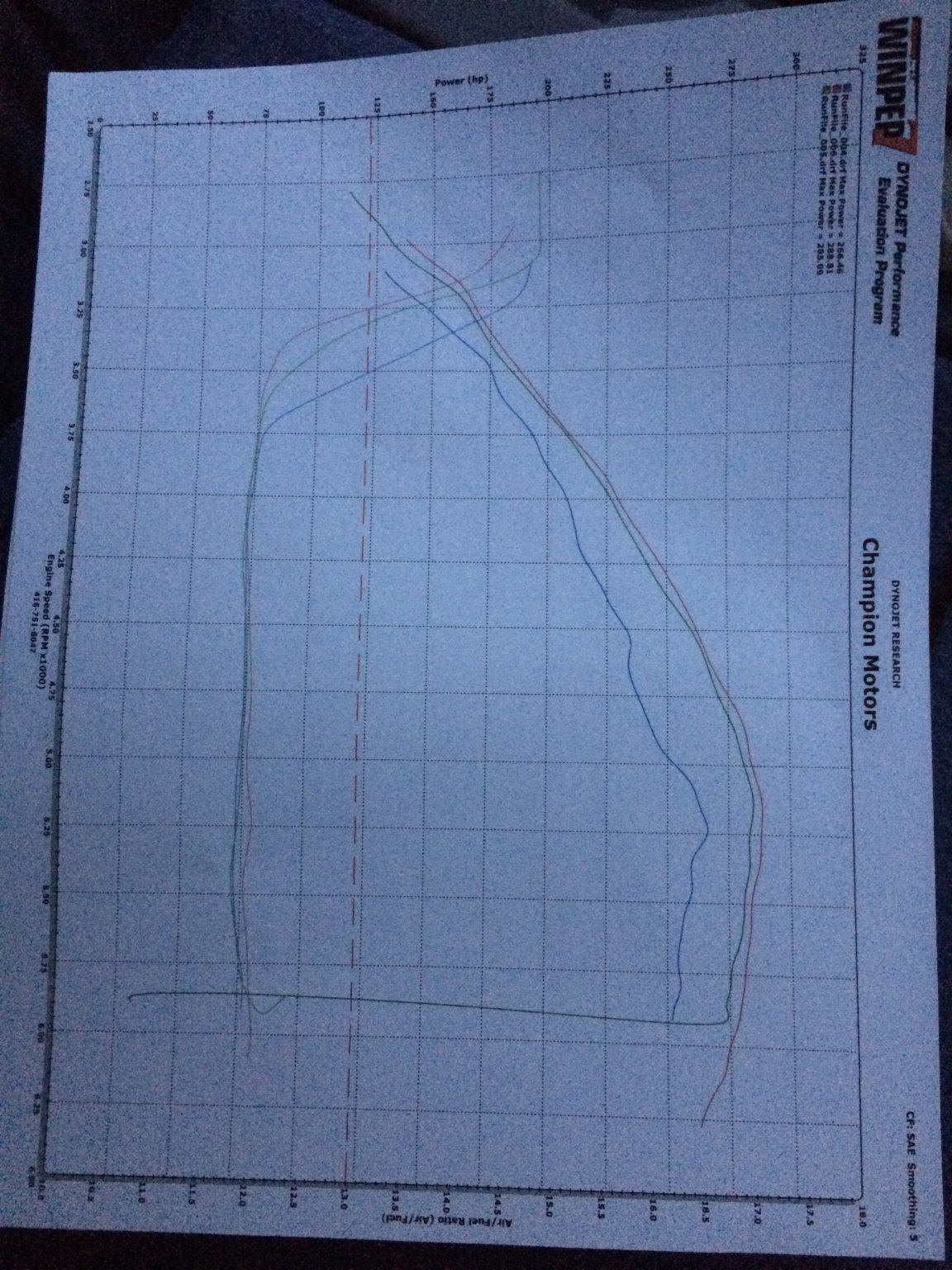

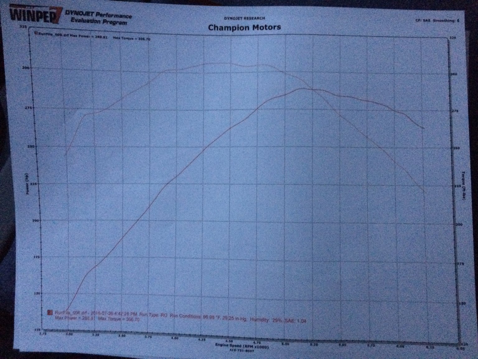

well finially finished. 6.0 LQ9 and rebuilt 4L65 and dyno tunned. 288 to the rear wheels on 89 octain. I am sure I can get more but for a daily driver and family mover I was happy with it optimized. It is a far far far more power than the 5.3. In the tune I got all the normal timing,fuel trim adjusted, shift points and line pressure boosted,took the speed limiter off,raised the rev limiter,no torque management, Vatts removed and the Efans turned on so all I have to do is plug them in to the computer. I think that was all. Runs and drives like a new truck. So for the Canadians in the Toronto area Champion motor sports is where I got it done. The answered every question and let me help and watch with every step. Keven was an amazing guy there. I have a video but can't up load it. Crapp

Glad to see everthing went well! How much hp u got at the crank? What all mods are done to the engine or is it completely stock?

I have a few small mods left. They will retune for free. The guy was telling me I should have 370-390 to the crank. Factory Hp is 345. Not too I think it's up that high but it feels good.

I bet it feels like a ton compared to the stocker! Nice work buddy!
