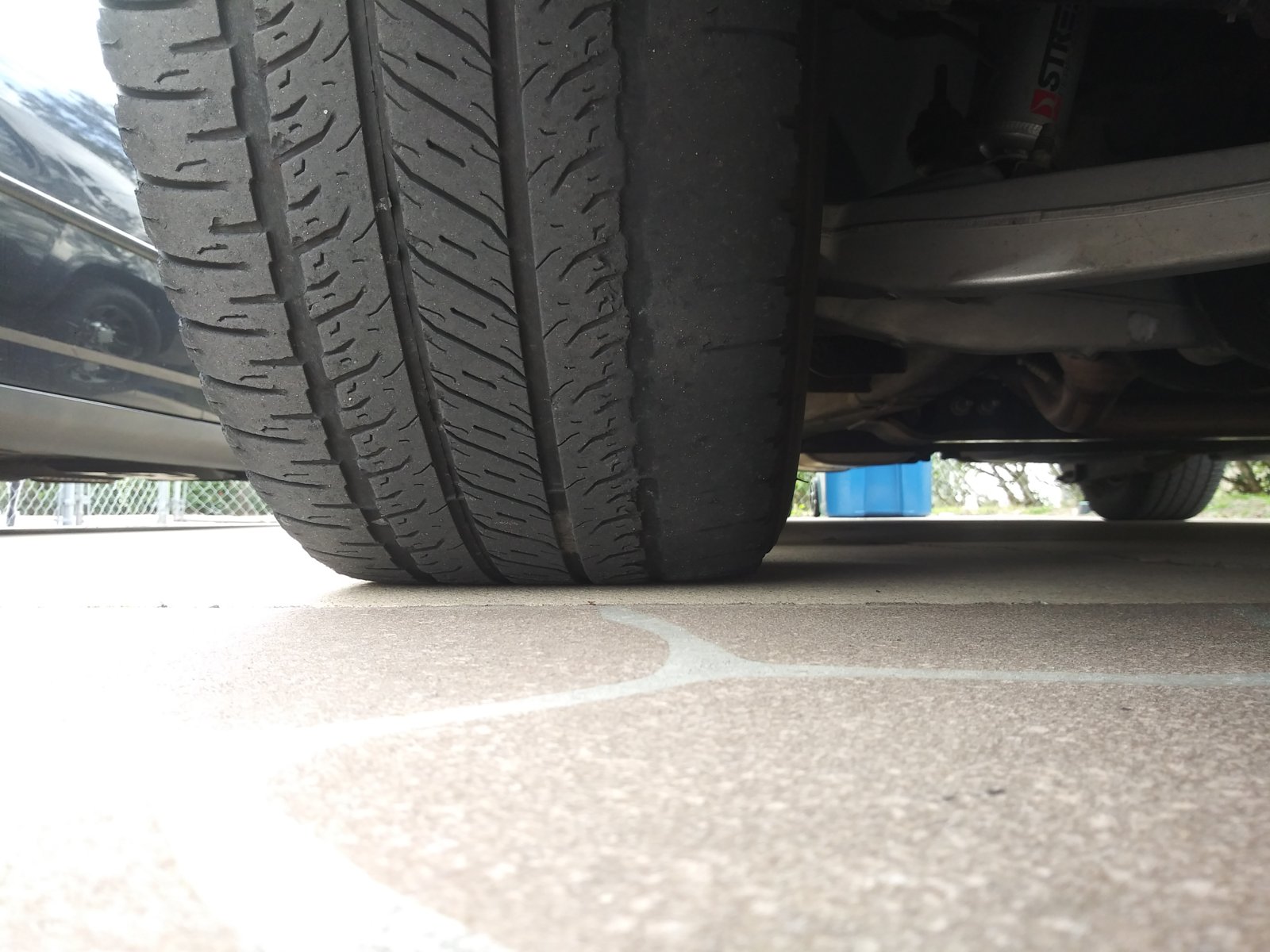

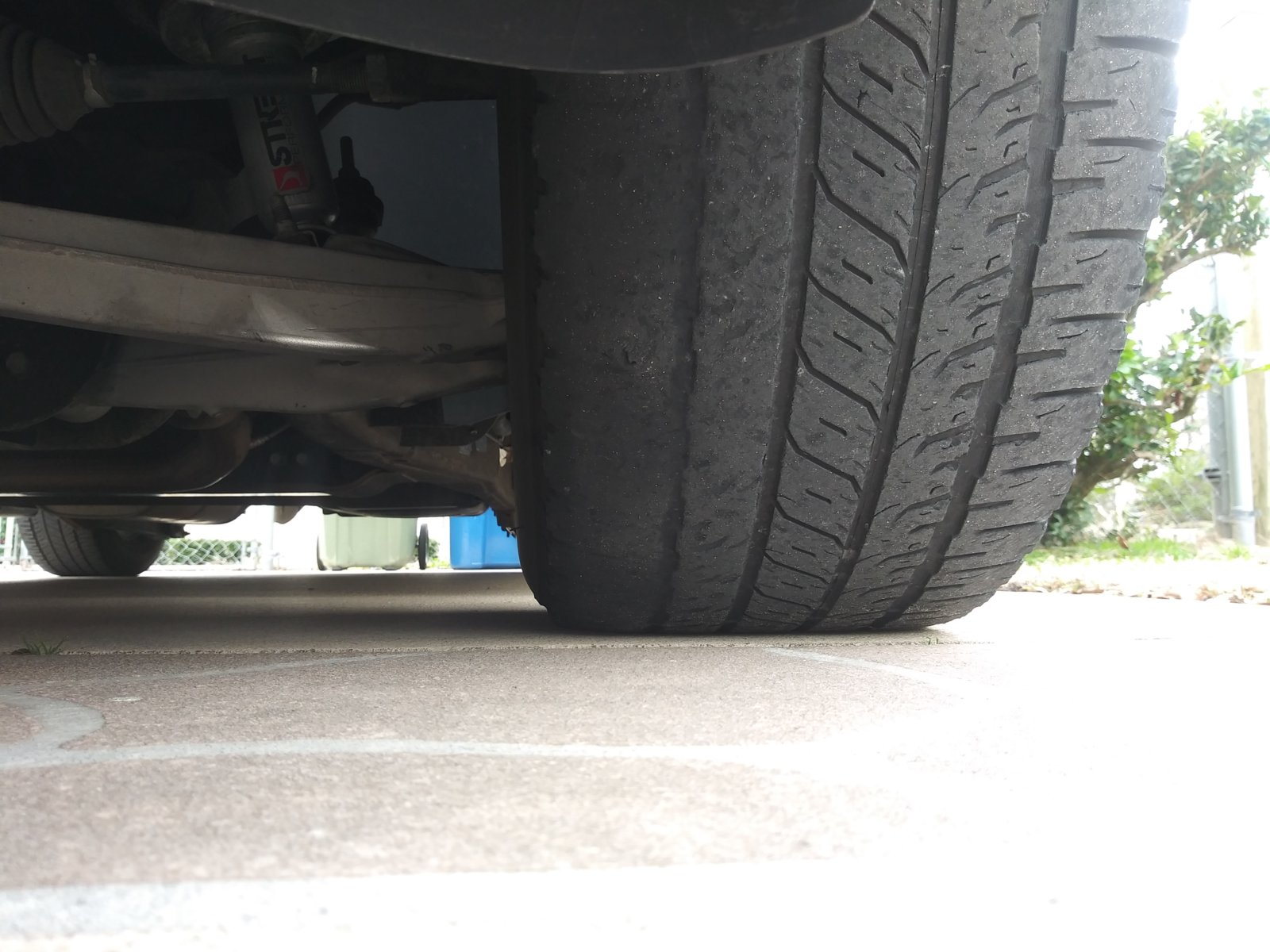

Went out and got a shot of the tires. Talk about negative camber, pretty ridiculous if you ask me.

I didn’t go back through the thread but did you add a camber kit?
G-d I'm trying to remember what the heck I did.
I know when I installed my suspension, I did not have any camber kits installed. That was roughly 4/6
Then I adjusted my suspension (to lower it) and installed the adjustable cam bushing. That was closer to 5 or 5.5 up front.
Finally adjusted again (to lift it back up) and removed the arms w/the alignment bushings and put new arms back in. That time the alignment was in spec or very close to it. Ending back at roughly 4".
Looking at the way it sits right now. I need to bring the front up another inch for it to sit fairly level. Or, remove the rear set up and install coil overs to lower it down to level it out that way. But, this is not really a priority right now so once I get the front situated, I'm hoping I will be able to set it and forget it for a while. I'd like to focus on the body this spring/summer and fix the damage from the jackleg who hit a few weeks ago.

Could be toe in too.
Unless there's some serious caster issues, toe OUT would be the more likely culprit for inner shoulder wear.

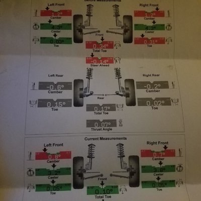

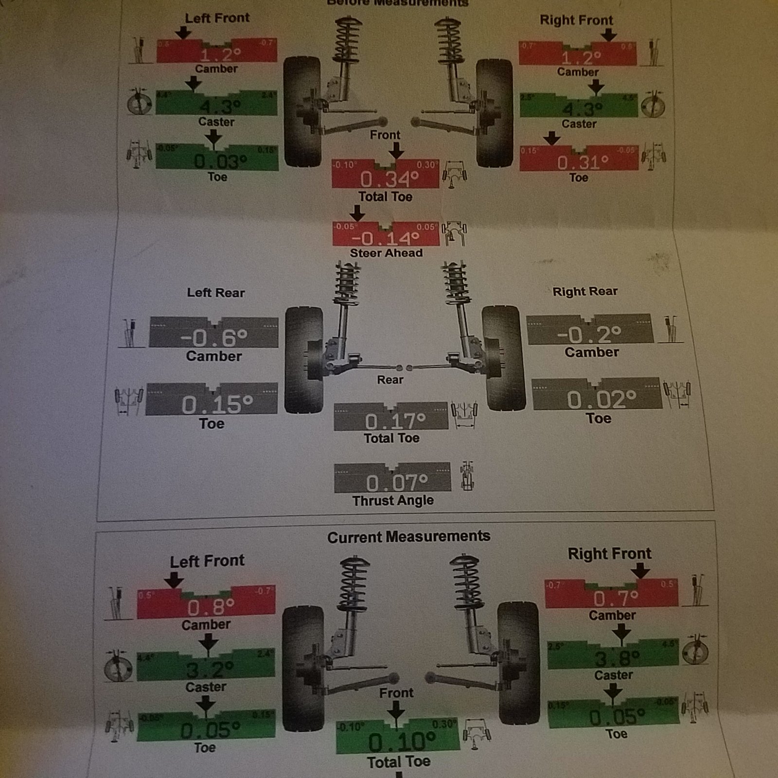

In all honesty, I don't recall.
I did use the same shop to do both alignments, not sure about techs though.
I think I still have the printout. I do haha.
Isn't that how they align it? Setting camber and toe? How should they be doing it?
Sorry, I'm not familiar with the process.

The top was when you brought the truck in and the bottom is when it left.
The camber is still off... only it shows positive camber which would cause the outside edges to wear faster.
My outer edges are really scrubbed out from my alignment. I run 22's in the summer, so it took awhile for it to show up. Gonna try to get another alignment from a different shop.

There are three dimensions to adjust for: toe, camber and caster. Well, there's thrust angle, but let's keep it basic. Toe and camber are the easiest to nail. Getting the caster set is a little more of a pain cuz it affects the camber when you adjust for it and vice versa. It can kinda be a balancing act. Also, if you have aftermarket control arms and/or spindles, the way the parts swing/tilt/articulate as the suspension is cycled when driving could be vastly different than with the stock parts. For instance, with the stock parts, the toe, caster and camber may only move out of their static settings a few tenths of a degree (just to throw out a number). With the aftermarket parts, the new geometry could cause the toe, caster and camber to swing more than a full degree(again, just throwing out a number) away from their static settings. This is why I asked if you felt a difference in the steering after it was lowered and aligned. A "drastic" (even as small as 1 degree or maybe less) change in caster and toe could very well make a noticeable change in the feel of the steering, especially when hitting large and shallow dips and humps on the highway.
Looking at the that printout, and as Ken pointed out, your camber is almost a full degree out with positive camber. I believe the stock settings call for a slight bit of negative camber. If so, you're almost a full degree out of spec on the camber.
Also, as Ken mentioned, positive camber would cause the outside edges to wear. I'm no expert, but that printout and your inner shoulder wear tells me that the tires are toeing out or cambering in as the suspension cycles, like there's a lot of extra movement going on.
I'd first make sure your parts are all good- no loose bolts, etc. and have another reputable shop check the alignment. There's a chance the first shop's equipment is out of calibration.

There are three dimensions to adjust for: toe, camber and caster. Well, there's thrust angle, but let's keep it basic. Toe and camber are the easiest to nail. Getting the caster set is a little more of a pain cuz it affects the camber when you. It can kinda be a balancing act. Also, if you have aftermarket control arms and/or spindles, the way the parts swing/tilt/articulate as the suspension is cycled when driving could be vastly different than with the stock parts. For instance, with the stock parts, the toe, caster and camber may only move out of their static settings a few tenths of a degree (just to throw out a number). With the aftermarket parts, the new geometry could cause the toe, caster and camber to swing more than a full degree(again, just throwing out a number) away from their static settings. This is why I asked if you felt a difference in the steering after it was lowered and aligned. A "drastic" (even as small as 1 degree or maybe less) change in caster and toe could very well make a noticeable change in the feel of the steering, especially when hitting large and shallow dips and humps on the highway.
