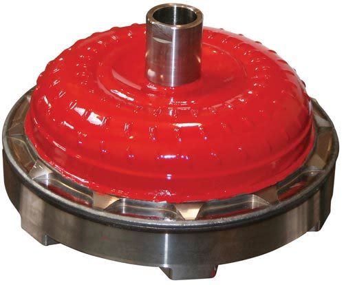

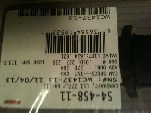

Nice! Basically have the same mods as I. But I went with the 219/227 .607/.614 112LSA which is the little brother of your cam. I need a converter though.
nice combo. I would do a 2800-3000 stall with that setup. The thing about my combo is that Im runing the NEW LS3 heads as well as intake!

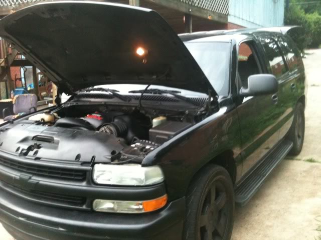

quite a few nit nats Im doing to my truck; changing my combo around slightly.
but as now she is sits:
6.0 LQ9 (vortec max)
L92 head swap
FAST 102 intake
102mm throttle body
85lb injectors
4L80e transmission
4000 rpm 9.5" stall converter
4.88 gears set
Detroit trutrac LSD
305/50/20 (32" tires)
Airaid CAI

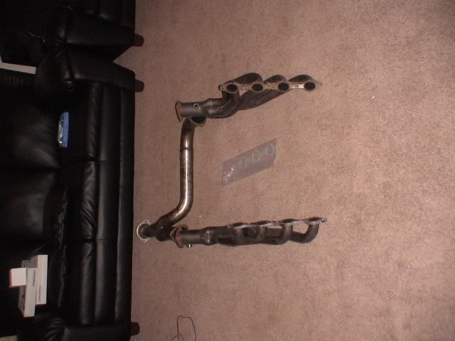

LPP long tube headers 1 3/4" primary
3" X-pipe (catlesS),
True duals Magnaflow dumped
street tuned by Alvin @ www.pcmforless.com
**** Pics are old, Ive added a couple new ones, and Ill updates as changes are made. I will also update this 1st thread text of my list as things go. ***********

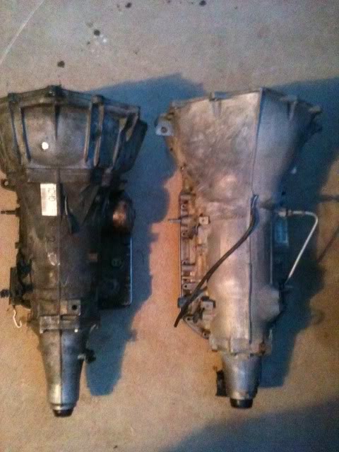

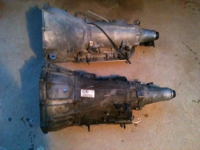

also going to lift it up 2" and Install a 2007 4l80e with almost no miles. I will finally get to install the gears at that point.

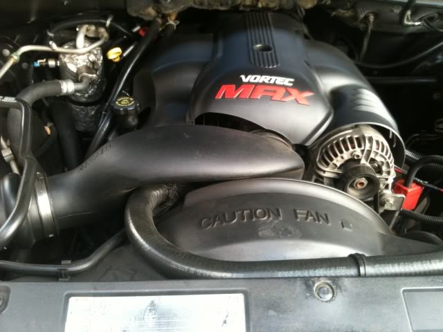

its not just the cover. Its the 6.0 vmax

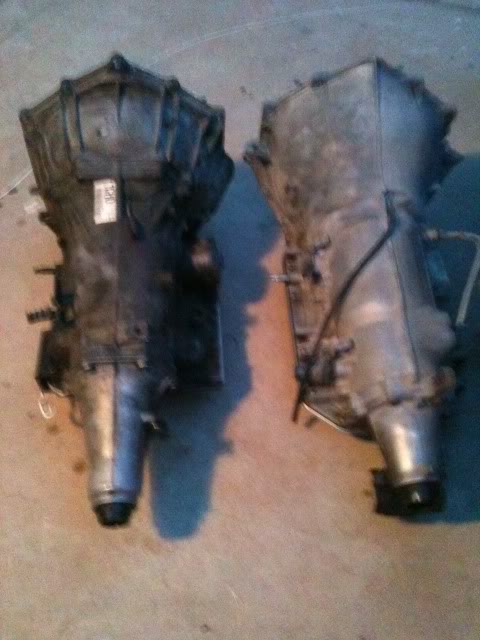

4l60e VS 4l80e

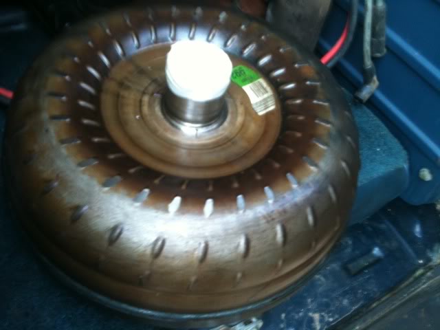

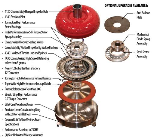

stock converter
MY tiny 9.5" converter

Lpps

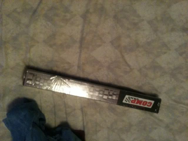

the cam Im looking at is around 232/238 duration specked for my combo on a 113 lsa

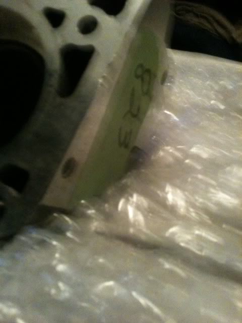

so more updates...

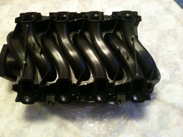

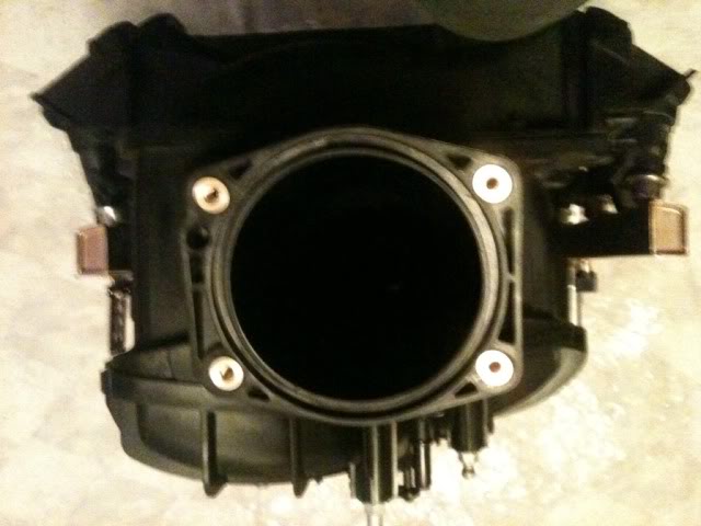

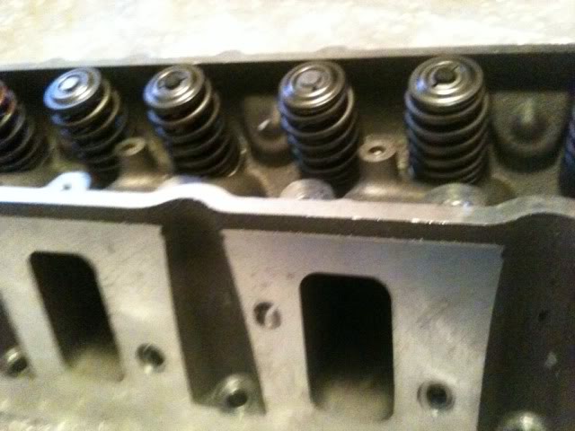

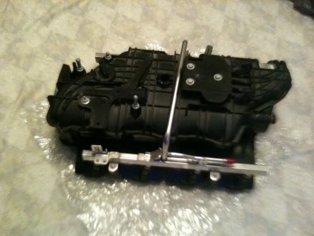

went with the l92 intake instead of the FAST 102
went with a 92mm instead of a 102mm, due to fitment.

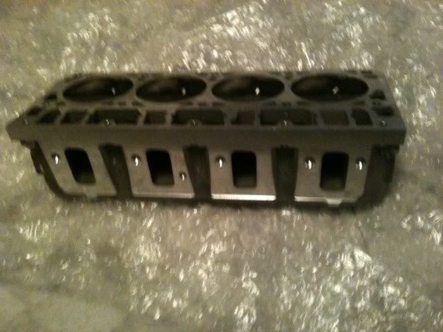

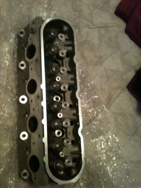

Compression on the motor should be 11:5.1 or near it. (should be a animal)
decided on Brian Tooley Racing springs and lifters!
couple pics of the collection. hopefully by xmas its running!

so im droping the compression from 11:1 to 10.3:1 as Im also deciding to drop a Trick Performance Turbo kit in the truck by summer time... hehe :)
For those who heads this is over... my engine has basically been converted to a 6.2L engine in essence minus the .2 (the engine in the newer escaldes , Ls3 camaro and corvettes...)
With the turbo Im adding, with my l92 top end swap, it would prob net another 100hp than just adding a turbo only to my 317s headed 6.0.
that said 7-800hp is expected.
