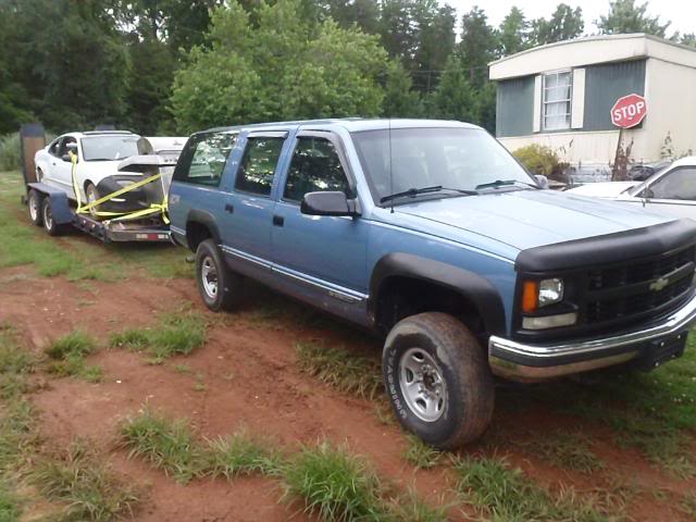

I have a scrap metal business and I use my trucks to work. So while my trucks aren't beautiful they are dependable and useful.
I have worn out 2 1/2 ton trucks and when this truce became available I jumped on it.
This will all be copy and paste till I get to something new.
Important numbers 1994 454 4l80e (rebuilt 500k ago) 2500 14 (bolt) 3.73 (g)80 4(wd) 160(K)

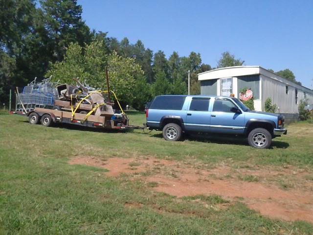

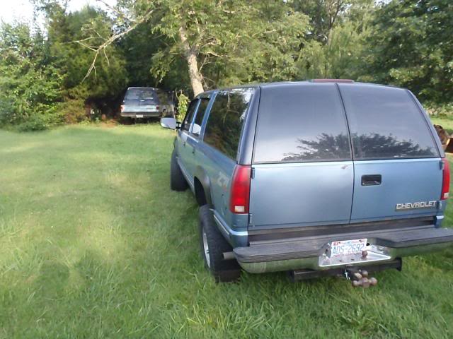

Yes the huge trailer is hooked to the LUV, it kept trying to wander off and I had to restrain it.
It didn't even know that trailer was back there.

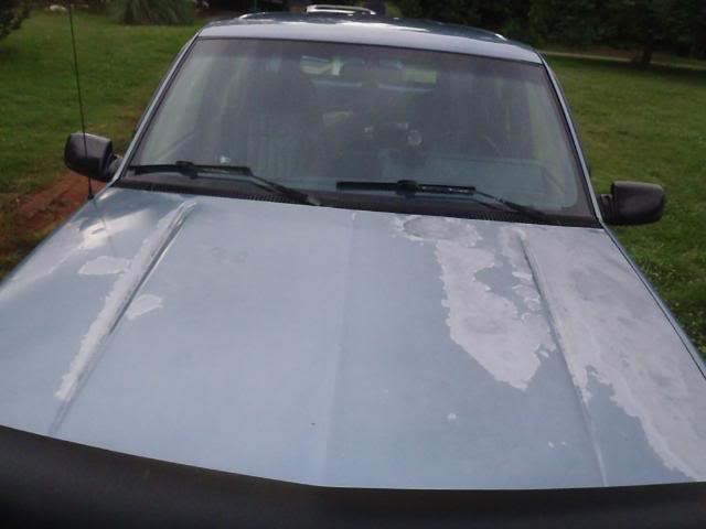

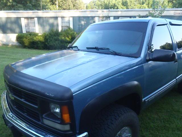

Hood needs paint

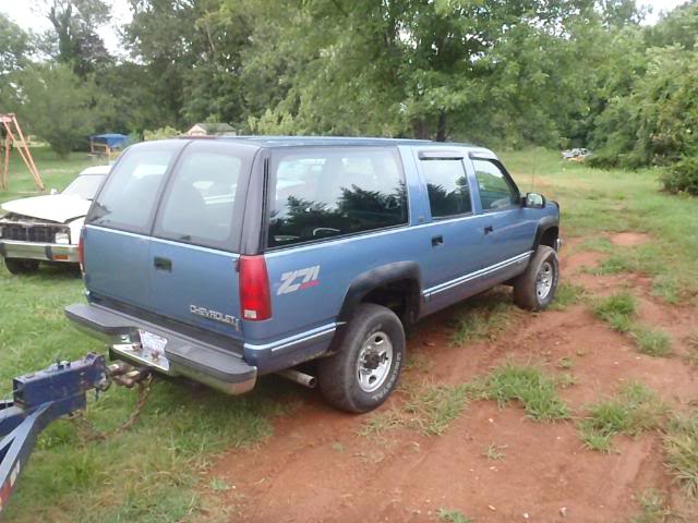

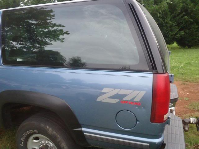

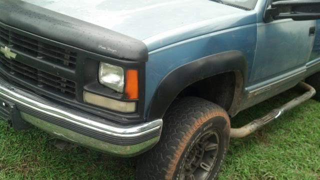

PO stuck on stupid Z71 stickers they have to go
Bubba approves

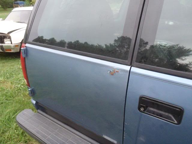

Tiny rust spot

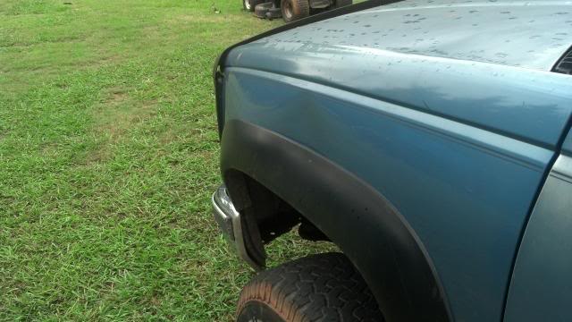

Small dents

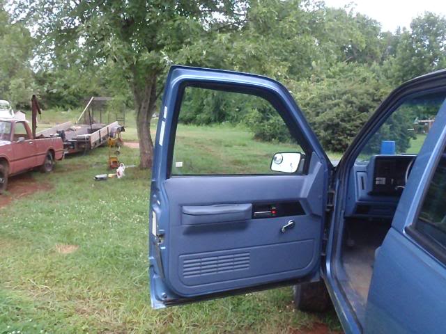

Drivers door needs repainting too.
Not going to do a whole lot to it. here is the list
Needs tires desperately.
The bucket seats have to go they are too soft and hurt my back. I have a set of 96 seats for it.
Side mirrors are crap and wont adjust - looking for a set of towing mirrors
Swap tach dash from WarBeast
Get a horn that can be heard
Install louder exhaust. I can't hear the truck run
Remove body lift
Paint hood and door
remove Z71 stickers
Tint windows
install center console
install radio
Install brake controller
Probably something else that I forgot.

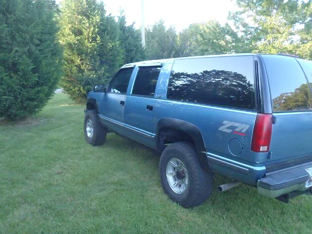

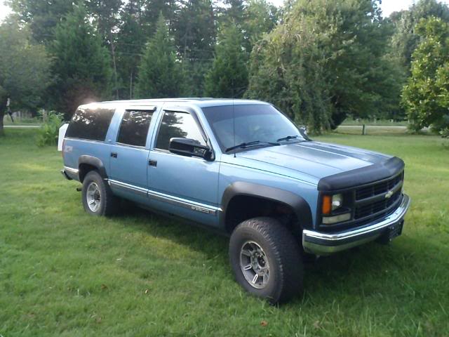

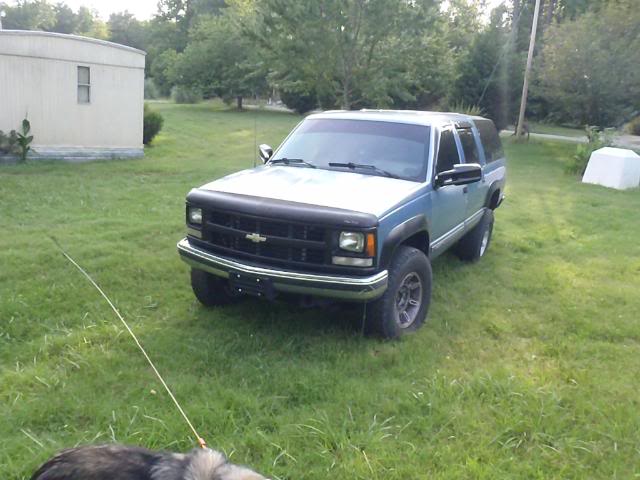

Just got her back from the tint shop Got it 5% in the back and 35% up front with a 6 inch visor.

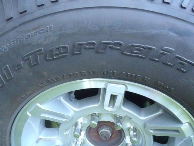

Also managed to find a set of H2 wheels that I swapped and traded for.

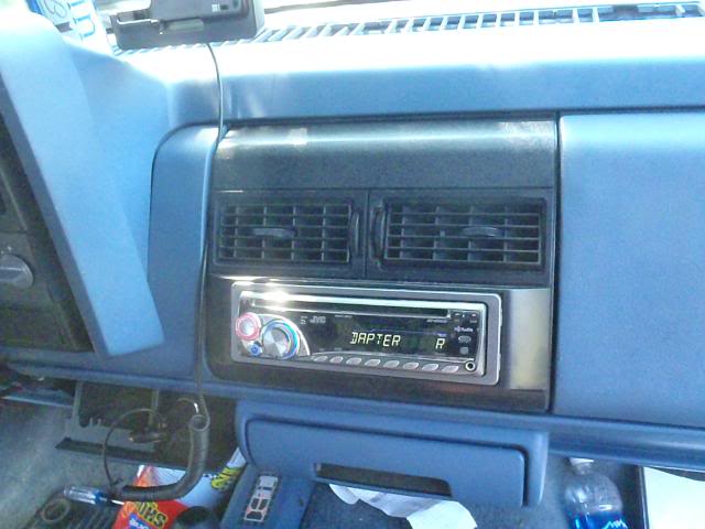

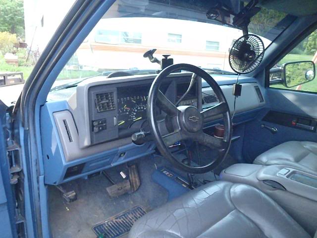

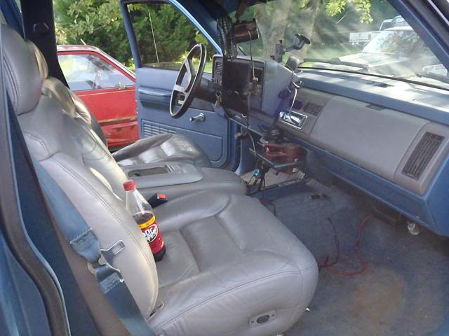

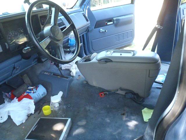

Jerked out the old buckets and stuck in a center console
and buckets out of a 96 Tahoe. They aren't perfect, but my back thinks they are great. I will find some covers for them soon.
Installed a brake controller
and a stereo.

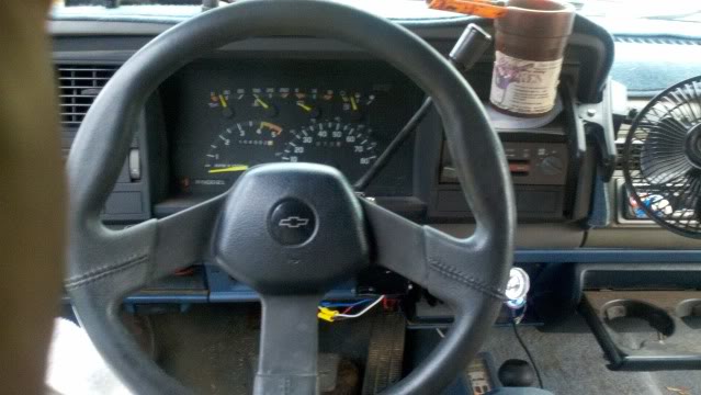

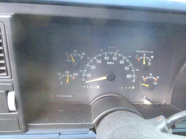

Swapped the instrument panel for the one from the WarBeast and got rid of the knee banger tach.
The old dash panel was cracked and broke so I stuck the grey one from the WarBeast in there for the time being. That is why some of the switch delete plates are black and not gray. I have another Panel somewhere I just didn't have time to dig it up today.

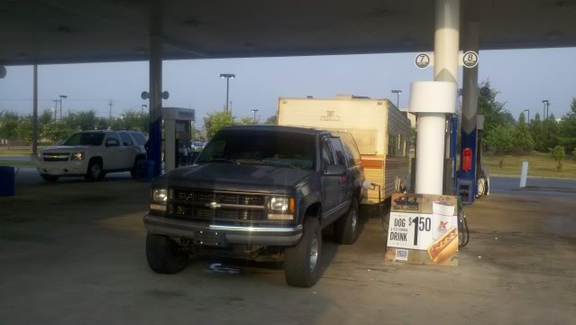

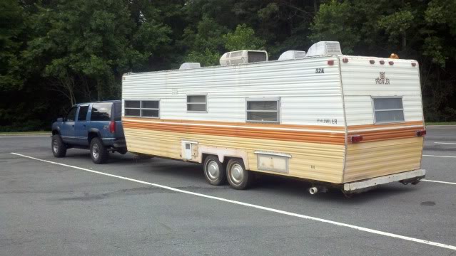

I drove it about 400 miles to visit the mother-in-law with a 28 foot camper in tow. It tows like a locomotive and drinks like Lindsey Lohan. Not sure what kind of mileage I got because of the tire swap and not having things recalibrated yet. The dogs loved the open back, and the wife and I loved the AC. However, I do need to find some way to get more air circulating because the dogs were hot back there.
The seats were great. I didn't realize how much higher they sat until I drove all day looking through the tint strip on top of the windshield. I may have to have it cut back to 4 inches instead of 6.
I do miss cruise control, but I will live.
And after driving it about 250 miles the muffler got louder and deeper. I am guessing the exhaust is brand new and never got run in good. I did notice yesterday while I was under it that it has a 3 inch exhaust and factory manifolds.
Filling up on the way out

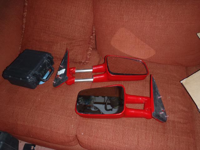

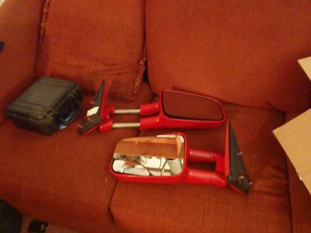

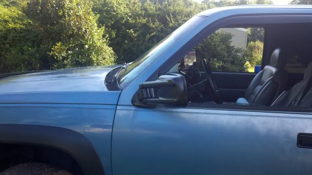

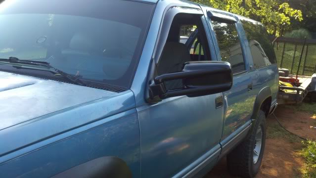

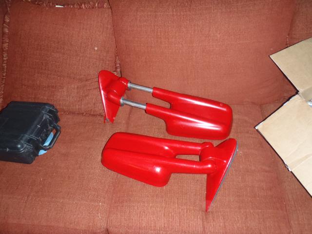

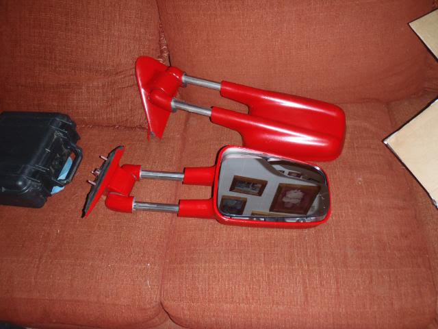

After pulling the camper to Virginia and basically guessing what was beside me I had to find some towing mirrors. Hopped on Ebay and found this set for $50. I guess no one wanted them because they are bright red. One tip got broken in transit. I will be using a bit of JB Weld on it later and painting them black. Then they get mounted on the truck tomorrow in place of the broken cracked non adjustable ones that are on it now.
---------- Post added at 02:32 PM ---------- Previous post was at 02:31 PM ----------

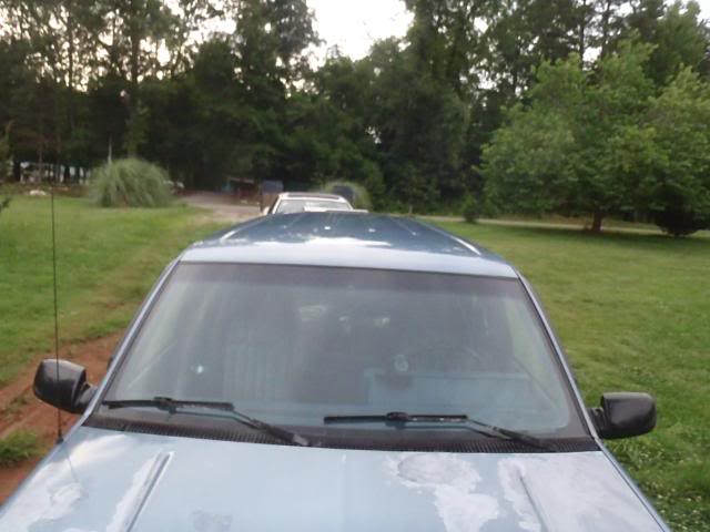

I got my towing mirrors on today. Had to enlarge the two bottom holes a bit and drill a new top hole and they fit great. It will be nice to see what is behind me.

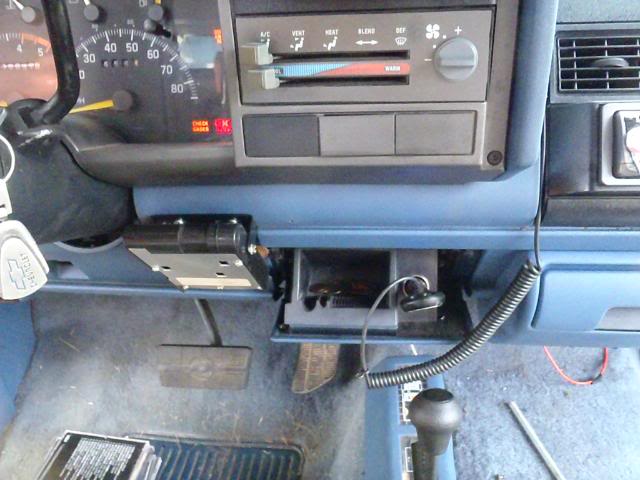

Took some time to finish up a few things today.

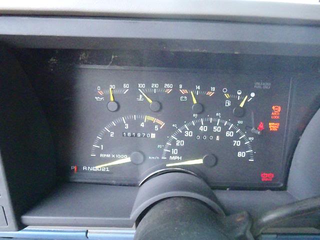

Put in another instrument panel with the correct mileage on it. Other one goes back in the WarBeast. Also painted the bezel so it isnt silver anymore.
Painted glove box door and installed it for the complete blue and grey look.

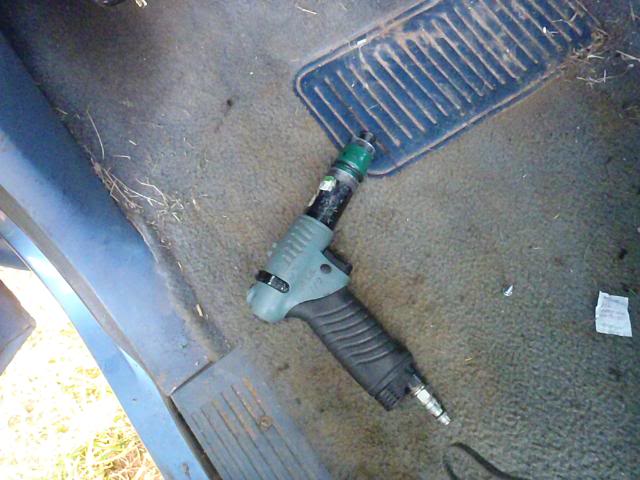

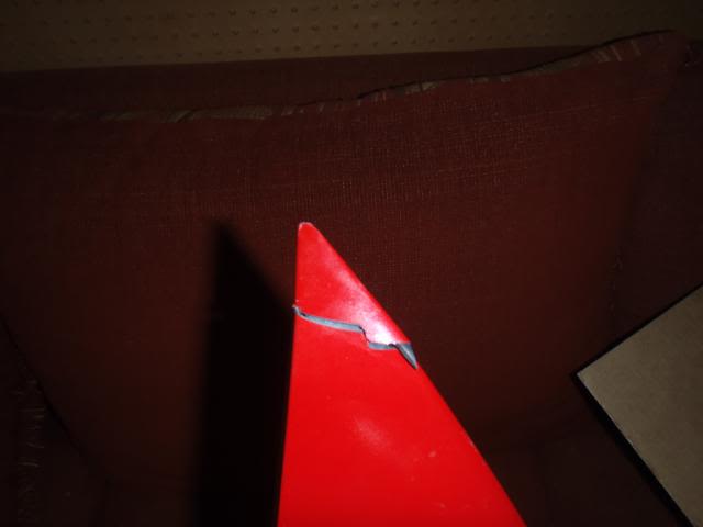

Replaced this broken piece from under the steering column.
Best little pneumatic screw gun I have ever had. Low torque so it is great on plastic parts.

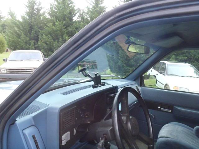

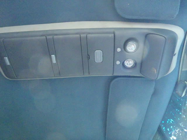

Doing a little work out on one of sheds today I found something I forgot I had. On overhead console complete with the correct screw and retainer clip. Wife did the awesome photography.
---------- Post added at 02:35 PM ---------- Previous post was at 02:34 PM ----------
Made two minor changes today. The truck has not had an accessory position on the switch since I bought it. This week a guy contacted me looking for a steering wheel and I sold him the one that was on the truck. SO while I had it apart I put in a new lock cylinder and added a different wheel that I have had down in the building. Here is a crappy cell phone pic.

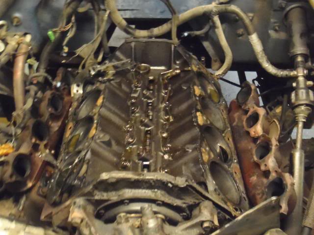

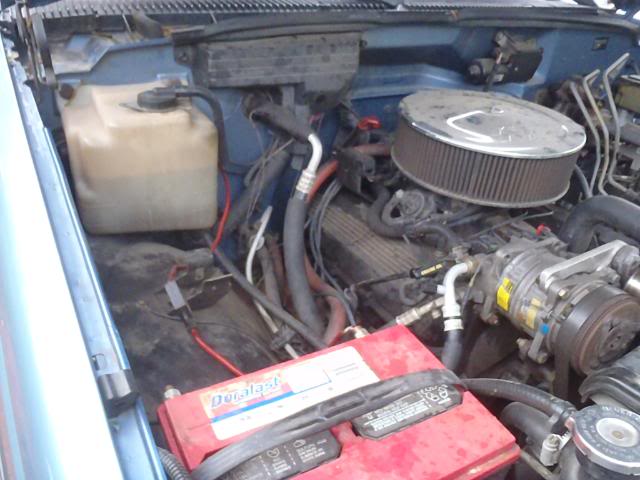

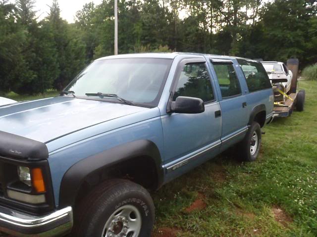

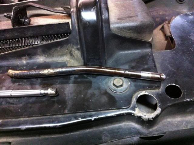

Well to update this thread – the BlueOx ran into trouble. Last week we went to get a car and it barely made it home. It was missing and had no power, but true to her name she pulled on home. She was throwing codes for EGR, TPS, Knock sensor, and Low voltage on the fuel relay. So I replaced those ( and oddly enough it had good fuel pressure) and it was still missing. I pulled the distributor cap and the distributor was in pieces so I put a new one in. It still ran like crap. So I towed it up to a friends garage and let him have it. He checked everything I did and said it was all good. Then he checked compression and it was down on several cylinders. He pulled the intake He sent me this picture.

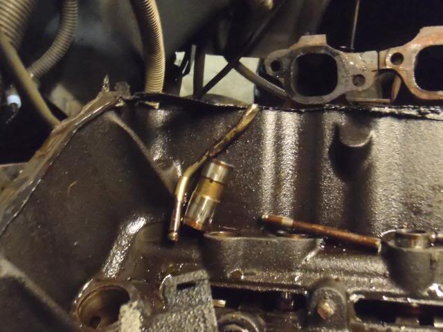

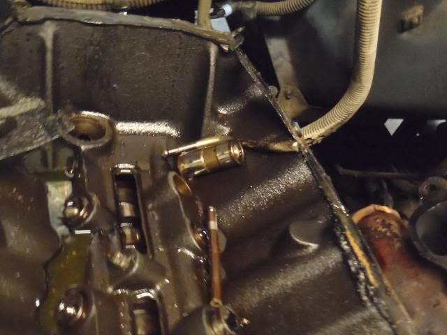

SO today he pulled the heads. They were frozen to the block. He got the bolts out and the heads refused to budge. At some point before I bought it this engine got real hot. I just went up and took him my life savings and took a couple of pictures.
6 valves are bent one is stuck. The drivers side head gasket was about to blow on all 4 cylinders and the back cylinder on the passengers side was only holding on my a prayer. But the block, and camshaft look perfect. It turns freely and neither the water or the oil were contaminated.
After a lengthy discussion with both him and the wife we decided that the smart money was to fix it since I couldn't buy another truck or even an engine for what the repair will cost. $1600 and it should run like new. I wasn't looking forward to having to put the WarBeast back together and work it again. She is old and tired I think that 400k miles is plenty on a work truck and she has earned her retirement. So by next week I will have the Blue ox back and she will be better than new.

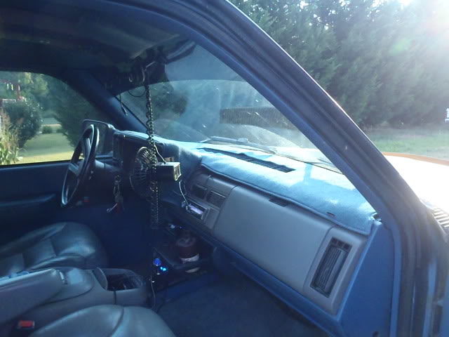

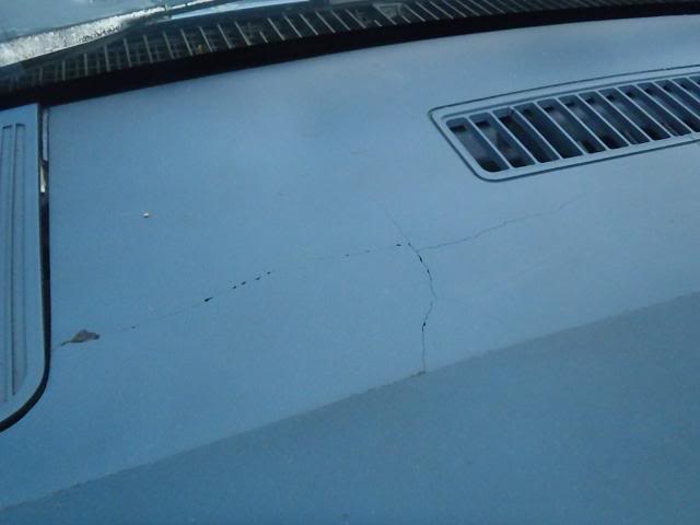

Got a dashmat for the cracked dash.

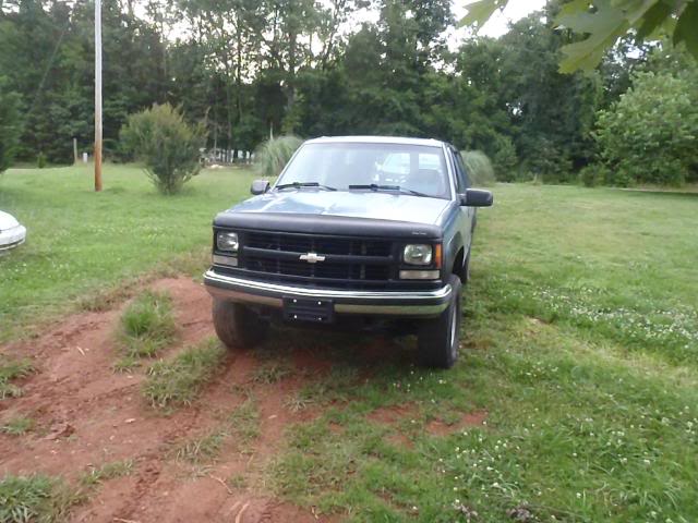

About a month after I got the truck it rained and I needed 4wd to get it out of the yard. When I engaged it the front drive shaft decided to leave the truck. Fortunately it didn't do any major damage to the truck, but the drive shaft was now square so I had a 2 wheel drive for a while because no one could had a 3/4 ton drive shaft. PO had done some transmission work and only put one bolt back in the front shaft for some reason.

Fortunately I have a spare set of doors and a friend that owes me a paint job.

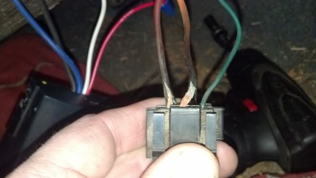

About 4 months back I had an odd electrical short. I searched and searched and couldn't figure it out. It seemed to move all over. So I took it to my biddy who is an electrical guru and he couldn't find it. We searched all over for a wiring diagram and no luck. His scanner kept telling us it was a ton of different things. None of which had any problems.
Finally his friend at a dealership came through. He called and asked if I was sure the truck was a 94. I am positive it is. He said what I had was a factory frankenstien 94 truck with a 95 transmission wired into a 94 wiring harness with some 95 only wiring. Once we had that all figured out and we looked at a 95 wiring diagram.
In 5 minutes we found this plug on the ignition wiring
Fixed everything. Since it was on top of the column we couldn't see it.
