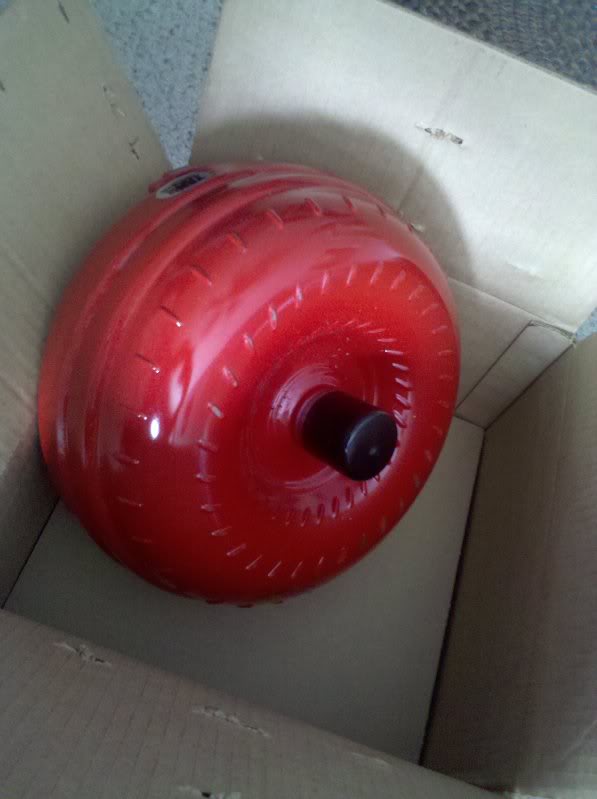

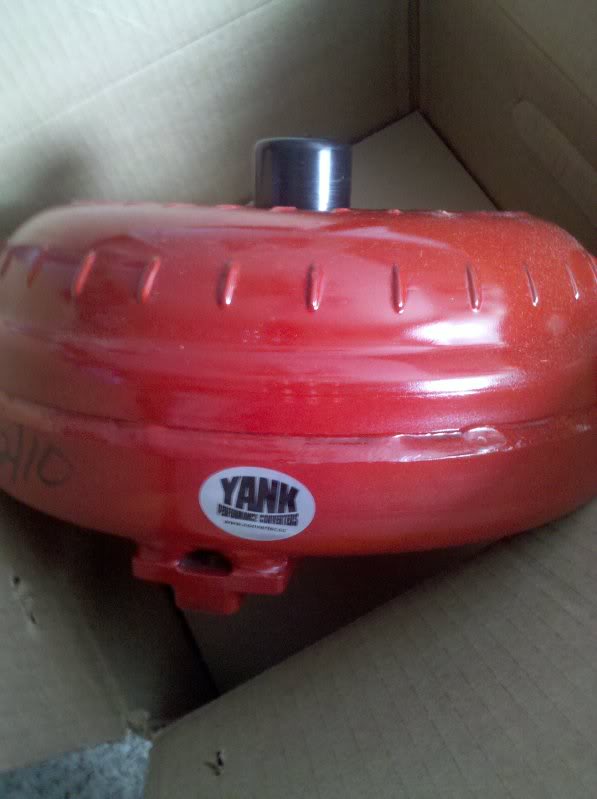

got this in today finally..
Dropped the truck off 20 min ago..
Going to be doing front and rear 5 pinion planetarys, shift kit, servo, Beast sunshell, zpack 3/4 clutch pack, pump upgrade and a few other little things..along with fixing a leaking tcase and kinked trans cooler lines..should be done by the end of next week..
