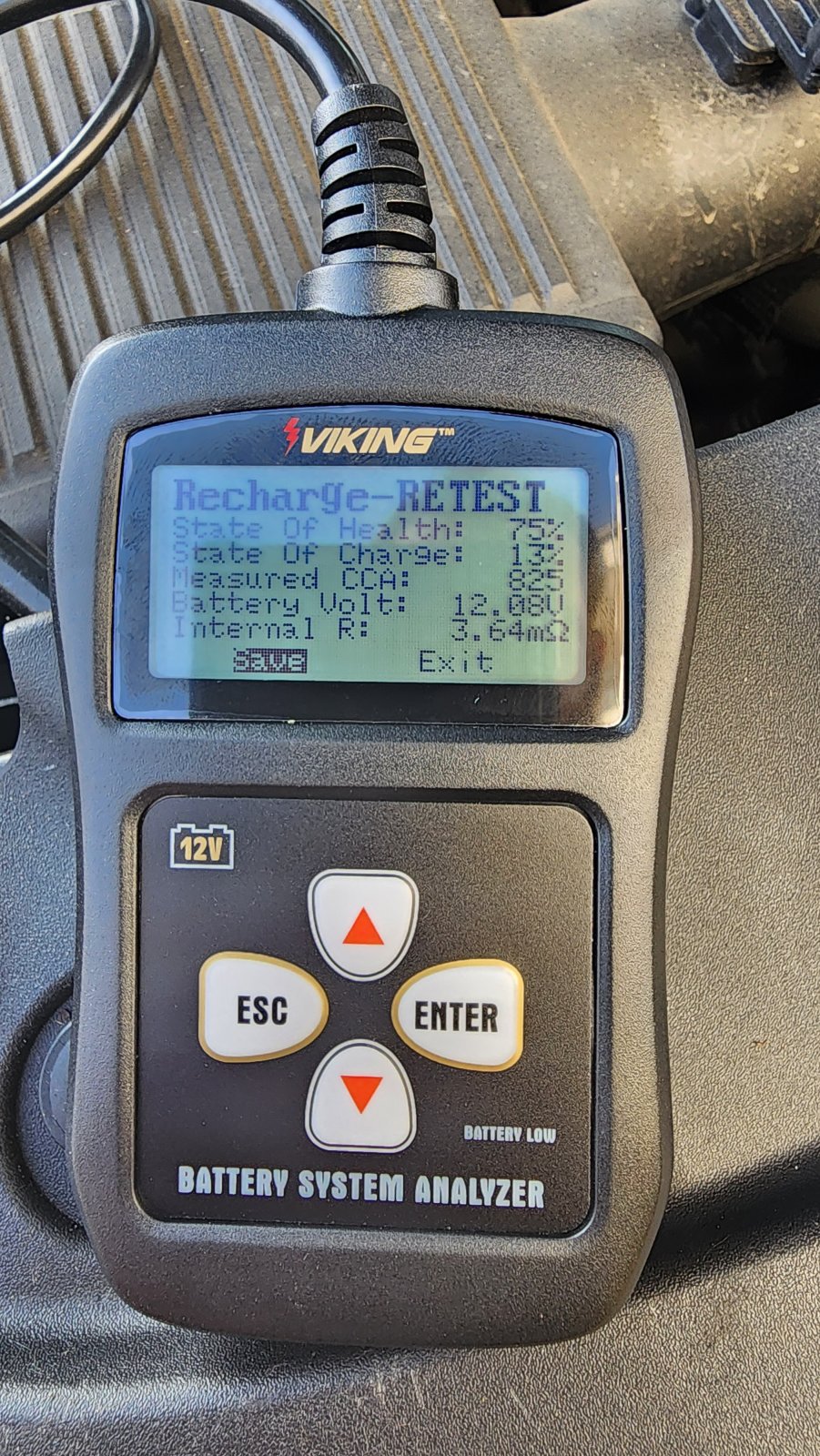

Figured I'd try this forum to get some advice on power issue before I give up and take it to mechanic.
BACKGROUND: last year bought 2016 tahoe ls and within 2 months was getting wierd power issue which was fixed by new battery. Now a year later same issue
PROBLEM: Disconnected trailer after backing in and afterwards car will not start. Acc, radio, lights work but ign won't. On rare occasions it will start and run very sluggish and with messed up idle, but now I'm getting a shit ton of codes and service lights
Codes: P0700, P0073, P07E8 and getting the following service warnings: stabilitrak, power steering, 4wd, transmission control module, trailer brake system.

Welcome to the forum from Virginia. Some real knowledgeable folks here that will probably start with your ground cables and what kind of voltage your battery has with and without the rig running even though the battery is new. The grounds are known to cause tons of problems like you described. When you check them peel the cables back a little and look for corrosion on both ends. As mentioned some folks more experienced than I will chime in soon.

I appreciate the response. I remember hearing that the first time this happened. Just confuses me that all these codes and transmission issues started cause this
