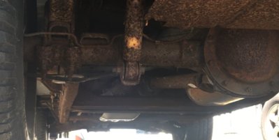

https://www.amazon.com/Corroseal-82...=UTF8&qid=1531331013&sr=1-1&keywords=coraseal
This is Corroseal. It does a great job and it is EASY.
I'll post some pics soon. I'm doing this to my Yukon.
Scrub off the surface rust, just the powder and flakes. Then brush or spray coat the surface. The chemicals turns everything white. It's fine to apply thick coats. A few hours later, the rust conversion turns everything a matte black that looks very OEM.
Here’s what I started with. I’ll post pics of the process.
