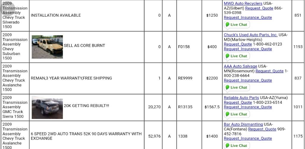

If you're looking for a low mileage factory unit and want to do the work yourself. Check out car-parts.com. you can do a search for the newest year of your generation of your model with the lowest mileage. You may find an almost brand new transmission for a lot less than you think with low mileage, no core charge and free shipping. I bought my hard to find Factory HD hood in my color code through this site and had it shipped to my office. You may even find something that is local.

I've look, there wasn't much in my areas. Cheapest/best option I found was a $1400 (w/$200) unit with >70000 miles on it. I did heavily consider it, but it was a wrecked Silverado and I'm not sure how good of a bandaid it would of been.
