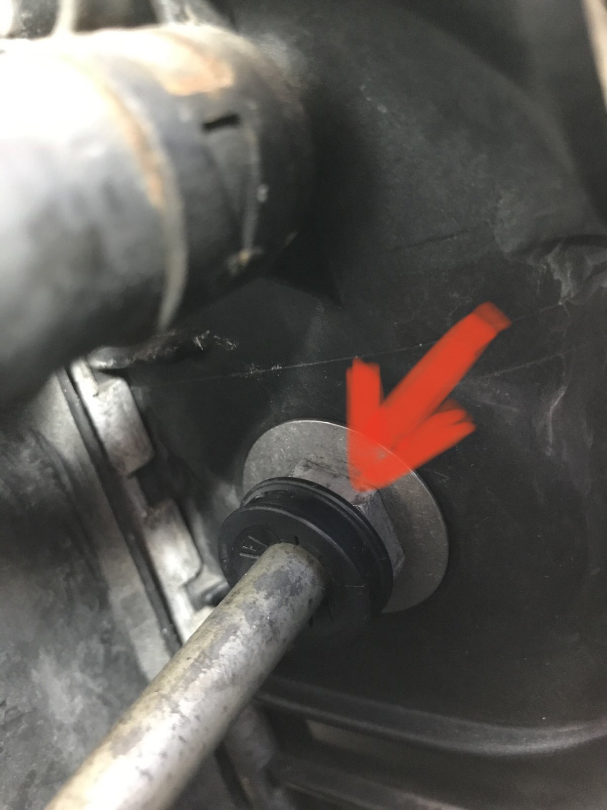

James, I didn't take a picture of the fluid that leaked out, but I had a paper towel below the fitting and it was I'd estimate 30% the intensity in color of ATF. Does anyone have a schematic of the radiator and transmission cooler? Is the cooler inside of the radiator? How does a new unit come - are these washer nuts already installed on the outside?
Here's a picture of my fitting, just for clarify.

Tom, that's a really good picture and very helpful for understanding. So the cooler is fully enclosed in the radiator and not replaceable/serviceable?
James, yes, I saw your schematic photo on page 1 of the thread - it appears there is an outside flange and internal threads attached to the outside of the radiator (forming the pressure boundary of the radiator). I don't see a hole or flow path from the radiator to the outside. Why would the cooler not be welded in (if it's not replaceable)? Is the male connector really forming the pressure boundary of the radiator?
I plan to flush my transmission tonight anyway (picking up the part you suggested) and the engine coolant system.
The radiator tanks are plastic so it can't be welded to the inner cooler.

I know that .... I meant what physical design of the interface between the radiator and the transmission cooler and cooler lines risk cross contamination of the fluids?
the radiator cooler is physically part of the radiator(on some anyways)
