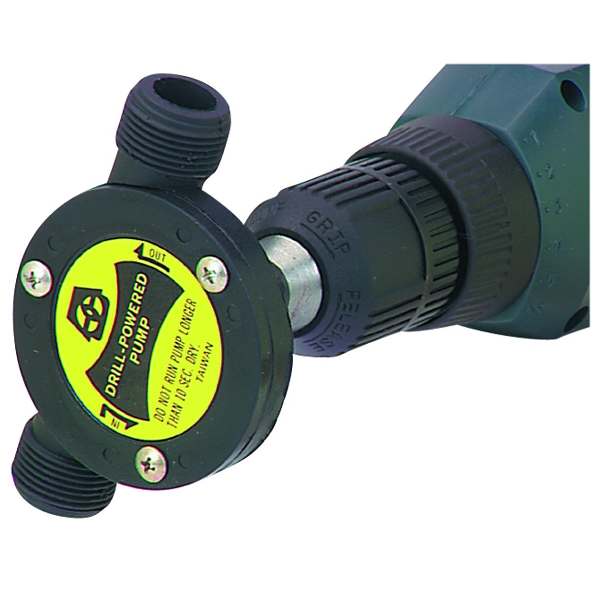

You might consider pumping fluid through the radiator mounted cooler to clean any contaminants out of it and the lines before using it again. Use a drill pump like this one but NOT this one from Harbor Freight:

That's a good idea on a way to flush the lines. From what I'm seeing, the cooler is a "Low Pressure Drop" type that only allows cold fluid to run in the top couple tubes until it becomes hot and then it runs through the entire cooler.
