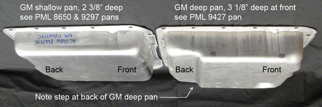

Pic for reference. Transmission does NOT determine AWD or 4WD. Its the transfer case that does that. 4wd is typical a NP246E. AWD is typically a Borg Warner unit. The rear of the transfer case will have a circular aluminum tax with maker and model# stamped into it. The tag is silver in color so it sticks out like a sore thumb.
Yes I know the difference between the transfer case and a trans. I just wasn’t sure if they used specific trans for a different application.
