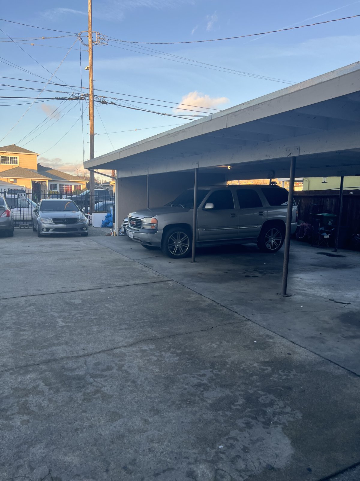

Pics of the truck, please.

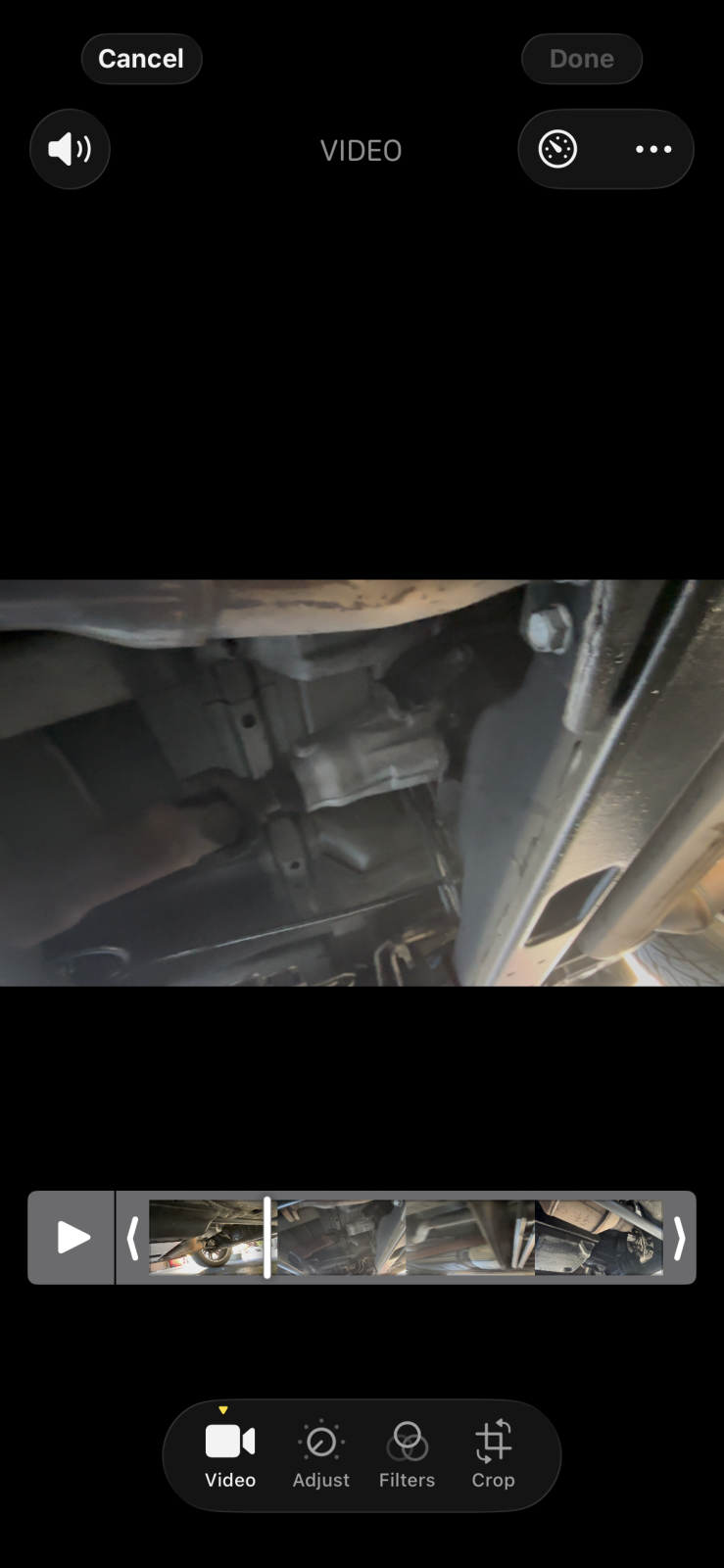

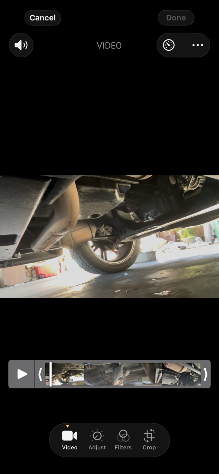

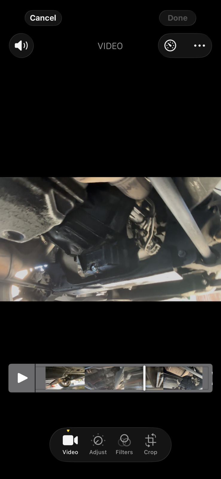

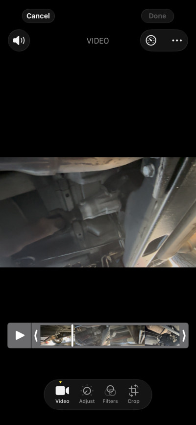

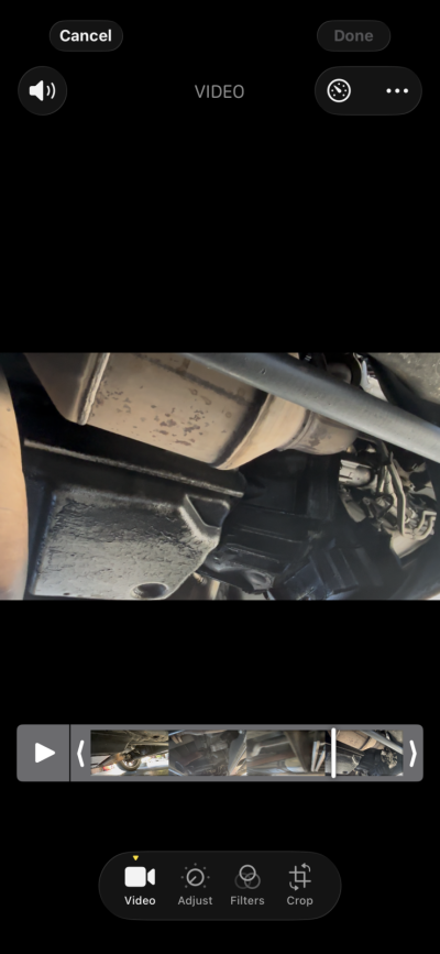

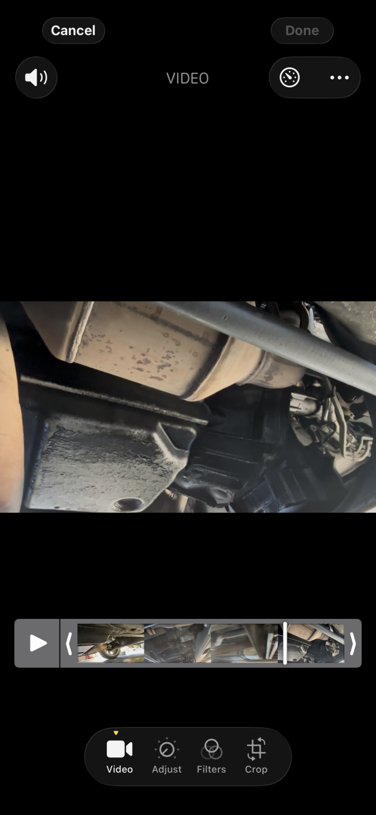

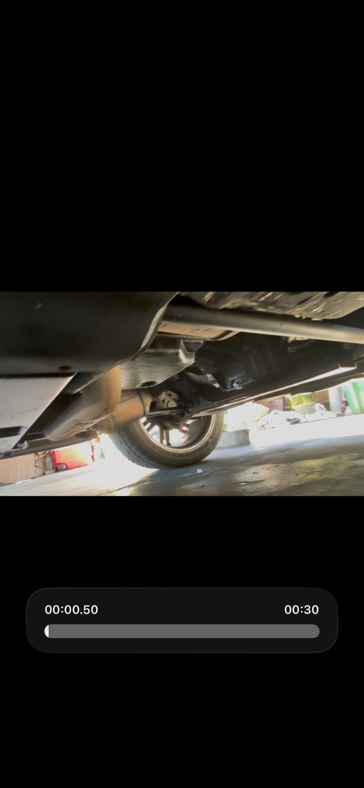

I’m welcome to be here I’m glad I’ve been able to find a group where I could get help and learn more about my gmt800 but yea I’m still on the original trans and kinda figured it would lead that direction but I attached a few screenshots of around th transmission from a vid I took sorry for the yap
