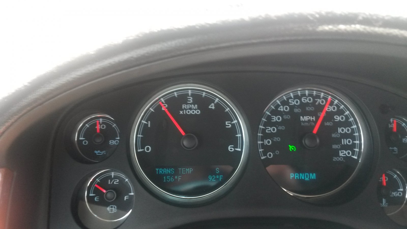

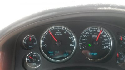

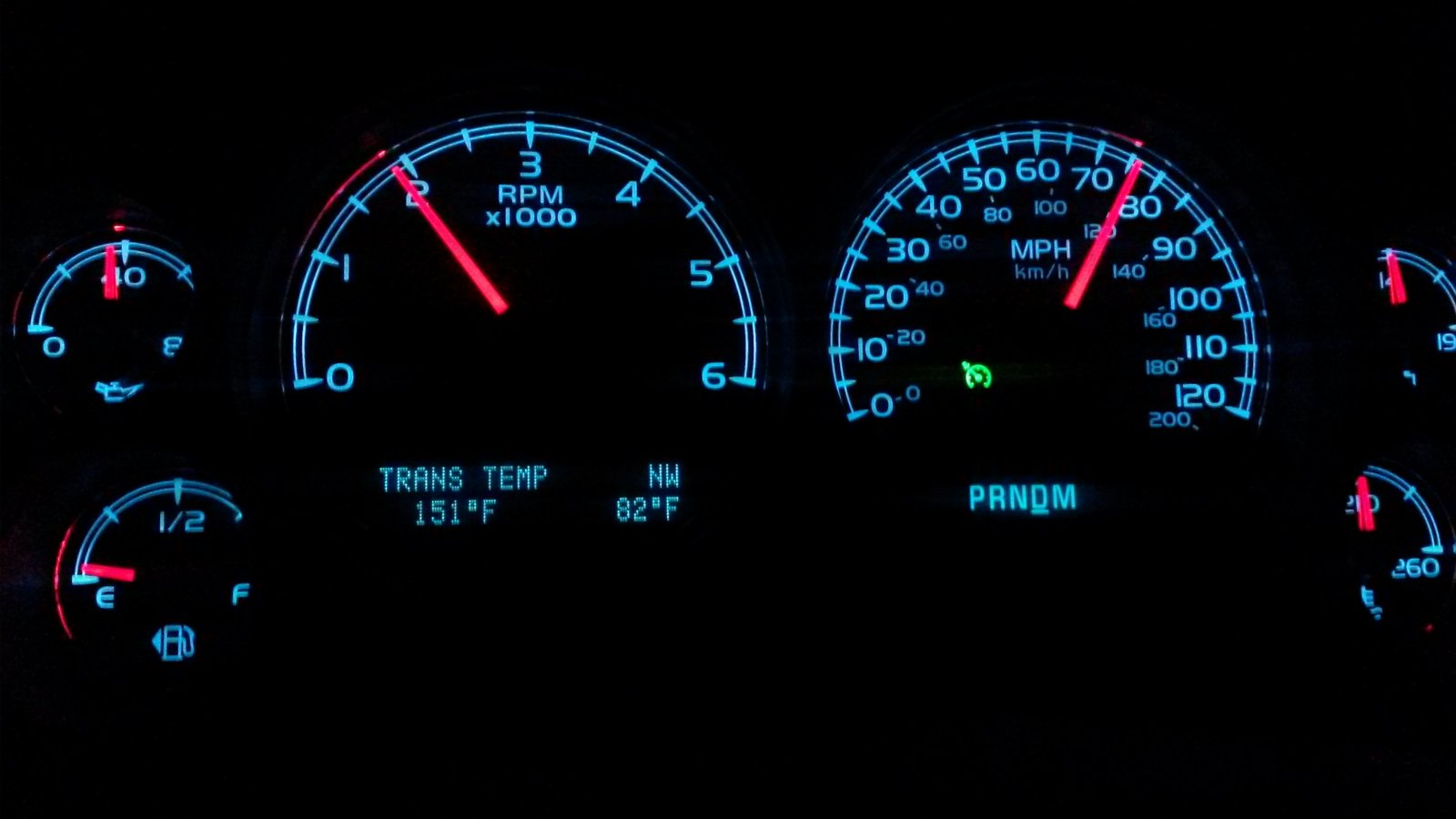

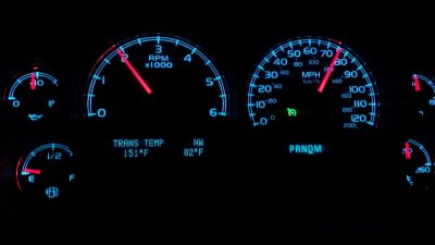

Here's a few shots of my temps, to give you an idea of what to expect, cruising down and then up the highway with a good sized load in the truck and not towing:
View attachment 225935 View attachment 225936
