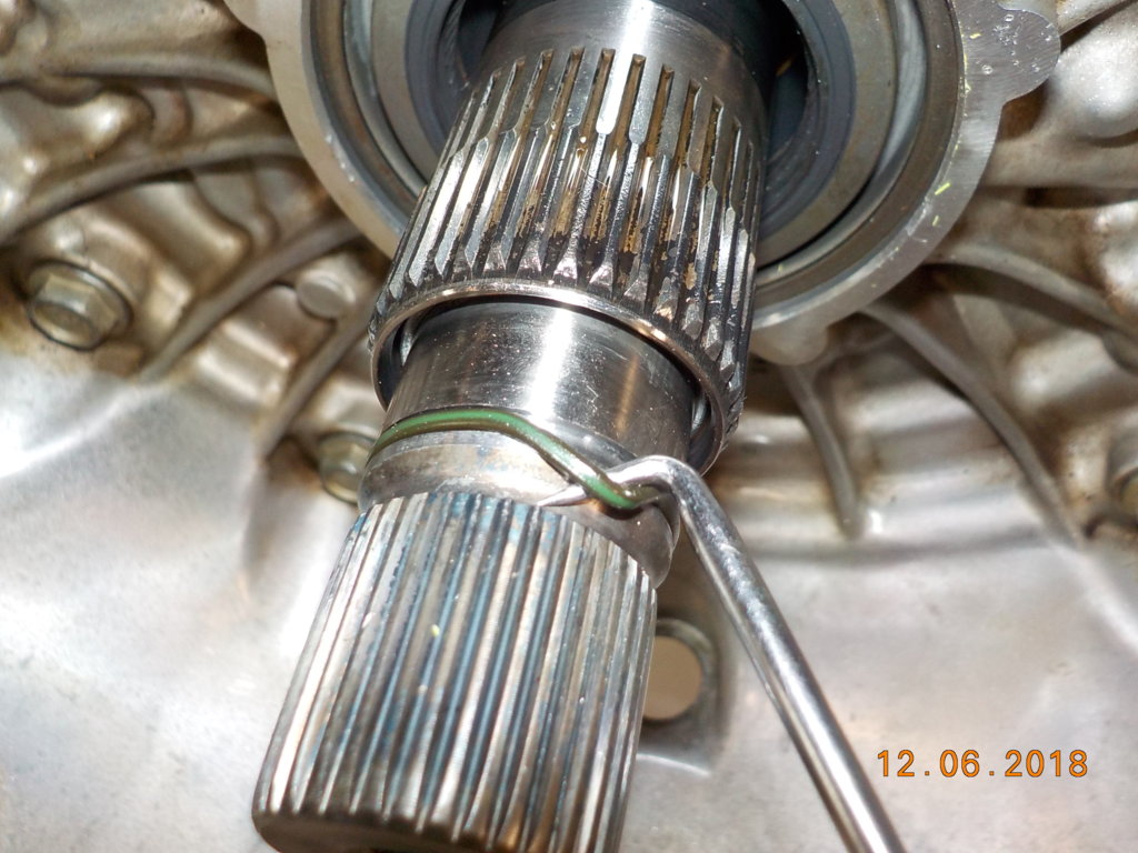

Mine wasn't leaking ATF, but I was doing an engine rear main seal job, so while I had the 6L80e tranny, torque converter, and transfer case out, I changed the tranny front seal GM# 24237531 and input shaft seal GM# 24219390.

Mine wasn't leaking ATF, but I was doing an engine rear main seal job, so while I had the 6L80e tranny, torque converter, and transfer case out, I changed the tranny front seal GM# 24237531 and input shaft seal GM# 24218390.
Thanks for the info. I was able to find the first part number but can you double check the second one, nothing showing up when I do a search for that.
since I need to pull the tranny would you recommend doing the rear main seal anyway?
I typed it wrong, correct # is GM# 24219390. I corrected it in my previous post too.
