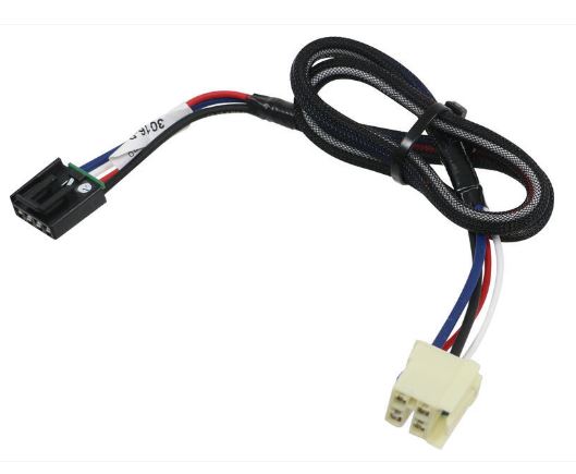

Tekonsha P3 FTW. Check eTrailer for the pigtail with the connectors for your truck; since you have the 7-blade they do make them.
https://www.etrailer.com/multi-prod...ar=2018&HHMake=GMC&HHModel=Yukon+XL&hunter=bc
Under the dash you'll look for a connector that (probably) has a heavy red and blue wire, along with two others. They do kind of hide them from what I hear. Mates to the white connector in this pic:
