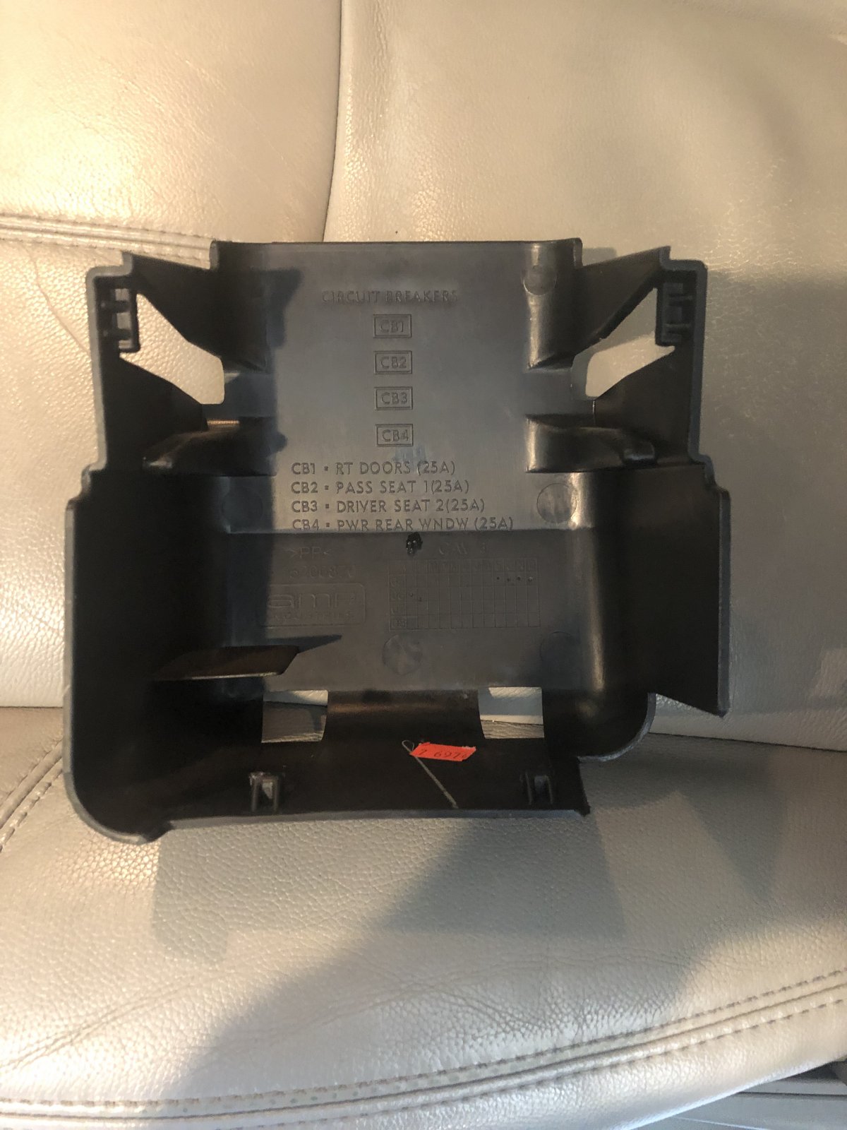

Just popped that black cover off. You just put your finger on the top sides and pry them sideways. If you do both top sides the cover will just swing down and be released.
Here is a picture of the back side of the cover. The two top wings get spread and they will release.

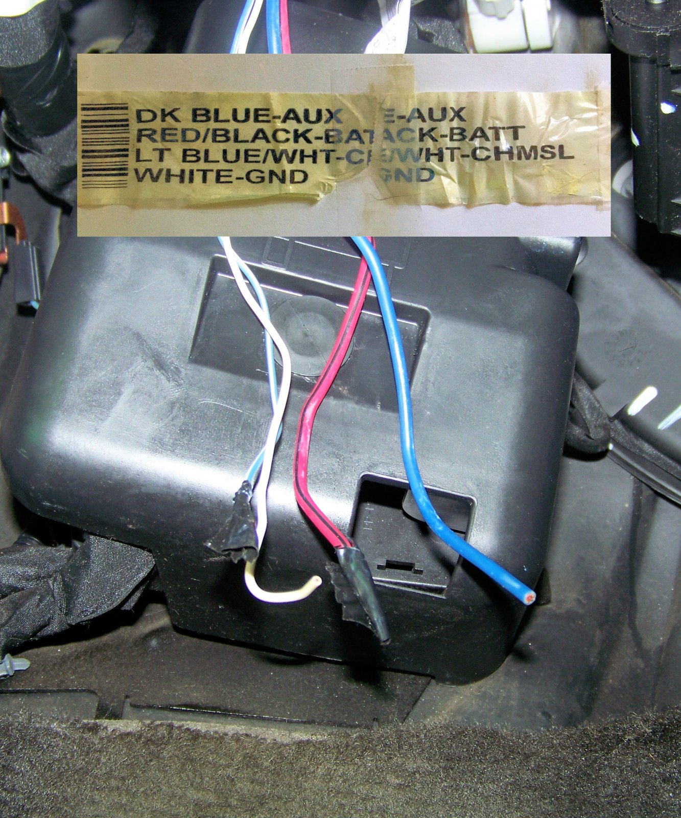

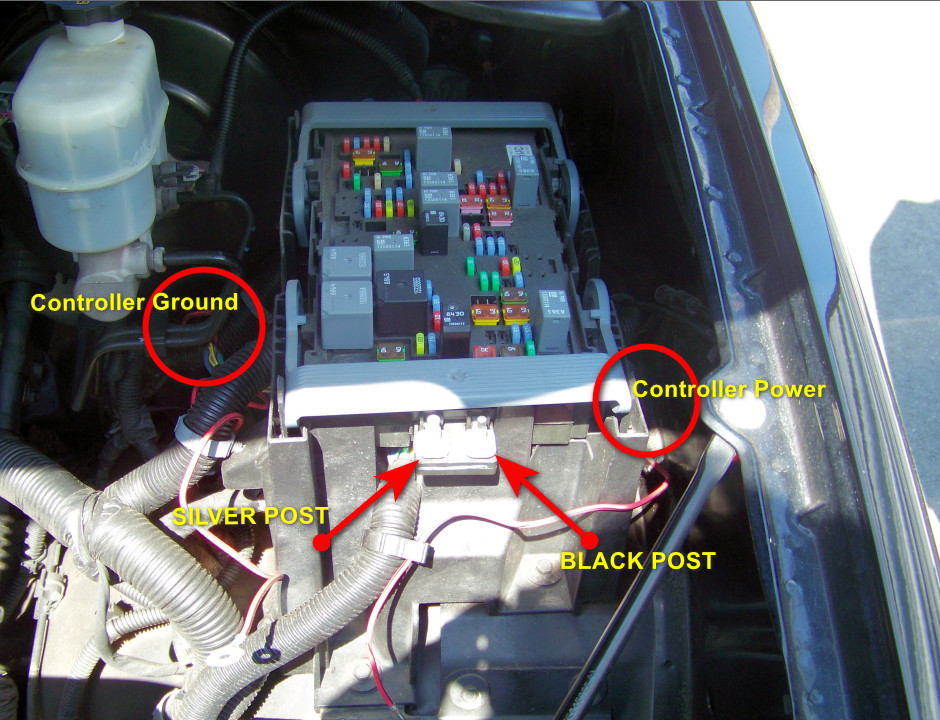

Mystery solved! Actually, this was probably more a matter of me being challenged by unchallenging things, but I thought that I would post a couple pictures in the hope of saving another 2013 owner some hassles. (It seems like 2013 is the difficult year for some reason, I could find the plug-in harness for the P3 for years earlier and later.)
FIRST, the wiring junction box cover doesn't need to come off. Which is good, because that body pin retainer is in there so strongly that I just didn't want to risk increased force to remove it and possibly damage the wiring block that it's protecting.

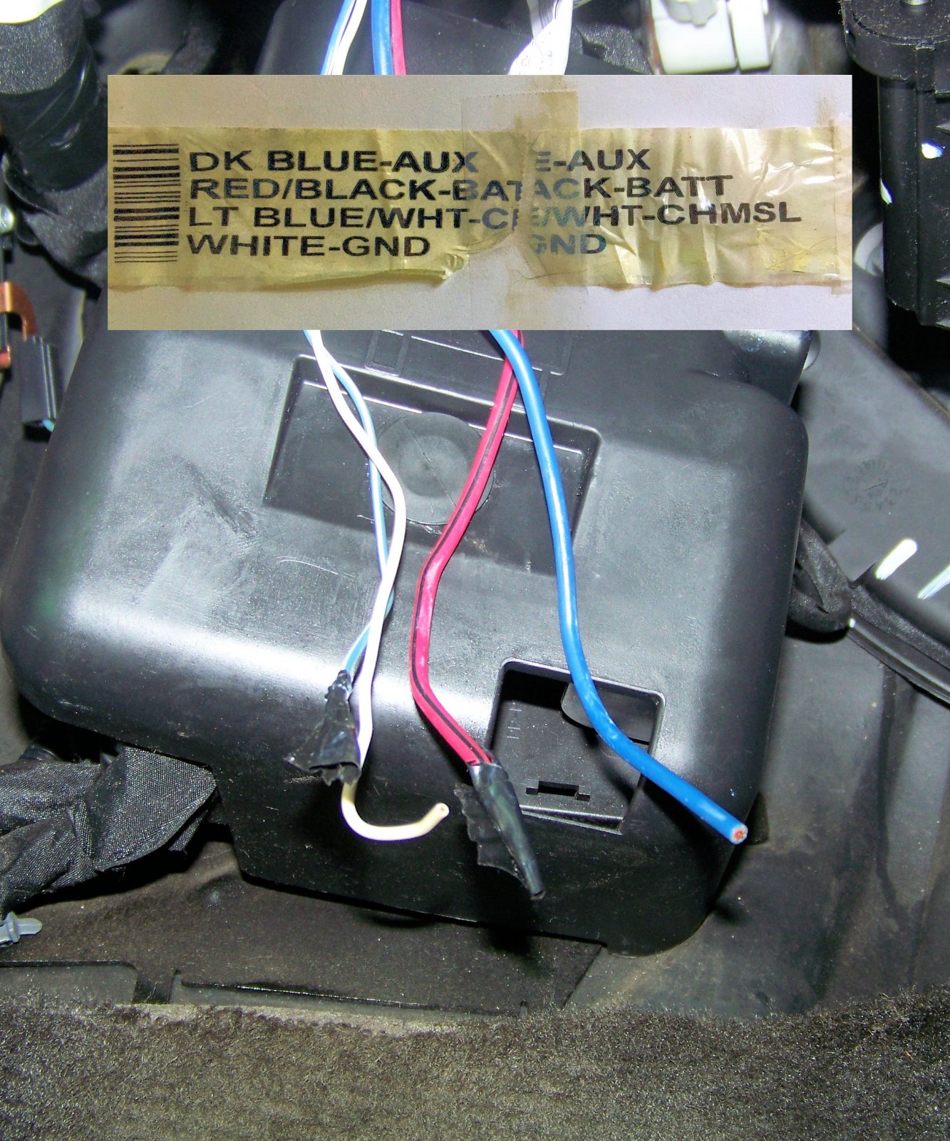

I found the trailer wire bundle WAY up in the wiring and completely taped up. The label shown in the picture wasn't easily visible, but I realized that it was the giveaway on what might be in there.
The installation video at eTrailer covers this, (the 2011 video shows the separate wires - the later model video uses the adapter plug),
but I thought that for myself and others it might be helpful to "be sure" of what is what.
I used my wife's small scissors to remove the tape. She wasn't home and probably won't read this. :)
As noted, the red wire on the FENDER side is controller power and goes to the SILVER post.
The red wire sort of under the brake reservoir is apparently ground, as the video says to attach it to the BLACK post.
POST NUTS:
I don't have existing nuts on those posts, so will need to get some. According to eTrailer, they are:
M6 x 1.0
M8 x 1.25
I hope that this helps somebody. Thanks to everybody who helped ME!!

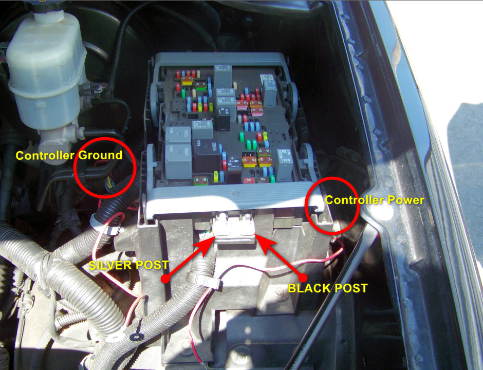

POST NUTS:
M6 x 1.0
M8 x 1.25

Both posts on the front of the power distribution box are hot (+) and one goes to the 12v power in the 7 pin trailer connector plug on the receiver hitch. Some trailers will use that to charge batteries or power lights/electrical equipment.

My wires were way up there and hard to find also.
Ah, thank you for clarifying!

If the 12v aux powering is always hot (which it is on my NBS) then be careful about leaving the trailer connected electrically while making longer stops for things like lunch, etc. It can drain your battery if you're powering something that takes a lot of current, like a fridge. And be sure to plug it back in before you take off again; I got in the habit of checking a few trailer lights after each long stop.
